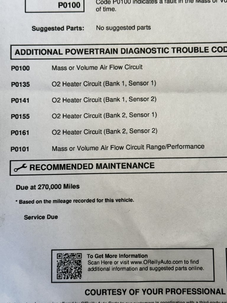

    My symptoms are, Dies on first crank starts on second. Will also , buck/ hesitate/ sputter when I give it lots of pedal. Otherwise, it runs really good. Idle is fine. I just took it on a 30 mile trip through town and on the freeway. And back home. The bucking and sputtering happened twice …both times while accelerating to get on the freeway. The first Crank Die second crank start is consistent. The code that it is sending me is for MAF. And a few things for my heater. I will send photo of printout as soon as I get home.
    This last week I have put in new Spark plugs. New coil overs. New air filter. Re manufactured OEM MAF sensor from Napa. Only one I could find…I also installed a new thermostat. I will be picking up my crankshaft position sensor DENSO from Napa tomorrow. The fuse panel driver side interior looks dry and in good condition. Fuses in the engine compartment look fine. . My ECM behind glove compartment Looks dry and in good condition. Everything else seems to be plugged in and hosed up properly… but I will know more tomorrow when I dig in to the crankshaft position sensor.

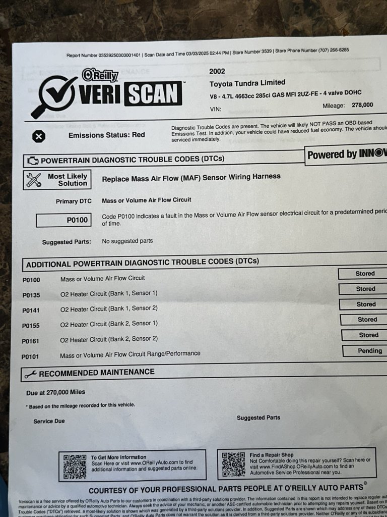

    You get these codes before or after you replaced the MAF? Looks like you needed a new MAF sensor and O2 sensors.

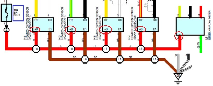

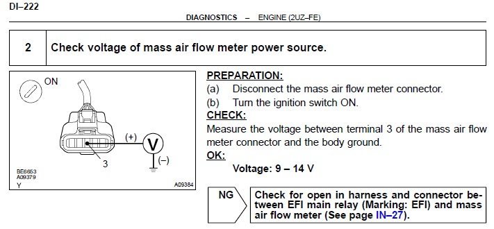

    As for the O2 sensor and MAF codes(100,135,141,155,161) they are all related in that they deal with open or short in power circuit. I also believe the "heater" problem you mentioned is codes dealing with the O2 sensor heater circuit.
    As for the P0101, anytime it is logged, the ECU puts engine control in "Fail Safe" mode(Ignition timing is fixed at 5° BTDC), which is probably your "buck/ hesitate/ sputter"
    The power feed for all 5 items(4 O2's and MAF) is the EFI NO. 2 fuse. Even tho you said fuses looked good, I suggest you re-check that EFI NO. 2 fuse located in Engine bay.
    If the fuse is indeed good, follow the check below if you have a volt ohm meter(VOM). The pin 3 wire is red in color and middle pin as noted below. Note the check is made with key in IGN ON only, no engine start.
    After all is said and done, I suggest you consider an actual OEM MAF sensor, not a NAPA. According to how tests check out, your original MAF may still be good. Clean it with actual CRC MAF cleaner and re-use, especially if the problem all along has been a blown fuse.

    As noted in above post, the "heater circuit" of all 4 sensors and the MAF sensor are on same power circuit, which is why all codes, except 101, are related to power circuit issues.

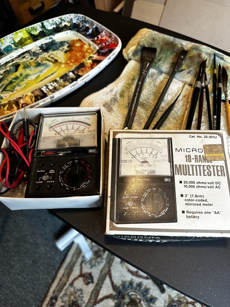

    Okay I’m picking up a decent multi meter…. BUT… found my gramps meter with original box…
    KNABORES likes this.
  21. Mar 6, 2025 at 11:59 AM
    BubbaW
    Aug 19, 2019
    #34845
    3,765
    Bubba
    Where Eagles Nest
    04 DC LTD 4X4 4.7 V8
    T150 Lover
    oooohh....a Radio Shack Micronta, that's definetly an old one. I'd make sure the AA battery is not corroded as fudge.
    Check page 4 of that owners manual for DC measurements....pdf copy attached if needed.
    • Turn black knob to 25 DCV
    • Leads in place where noted
    • Should read somewhere between 10 - 15 vdc when measuring for 12vdc

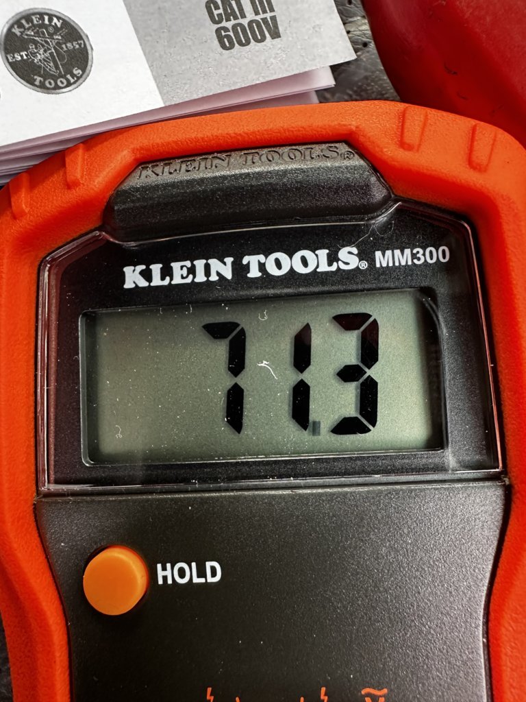

    My reading on the relay was 71.3
  24. Mar 6, 2025 at 4:29 PM
    #24
    KNABORES
    KNABORES Sarcasm incoming
    Jan 1, 2020
    #40572
    13,758
    Arkansas
    71.3 what

    Did you test the relay to see if it delivers 12V when triggered?

    What relay are you speaking of ?
    Have you checked to see if the EFI NO. 2 fuse is good ?
    Have you checked the MAF sensor following the procedure below ?

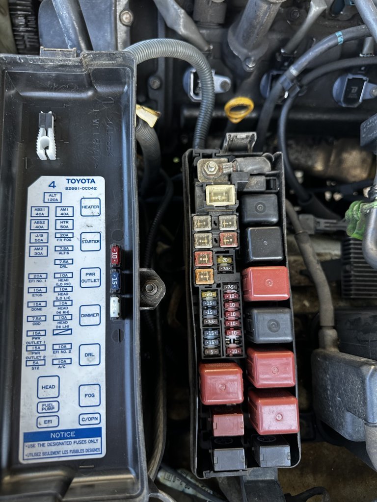

    there isn’t a fuse in EFI #2 spot or am I reading this wrong?
