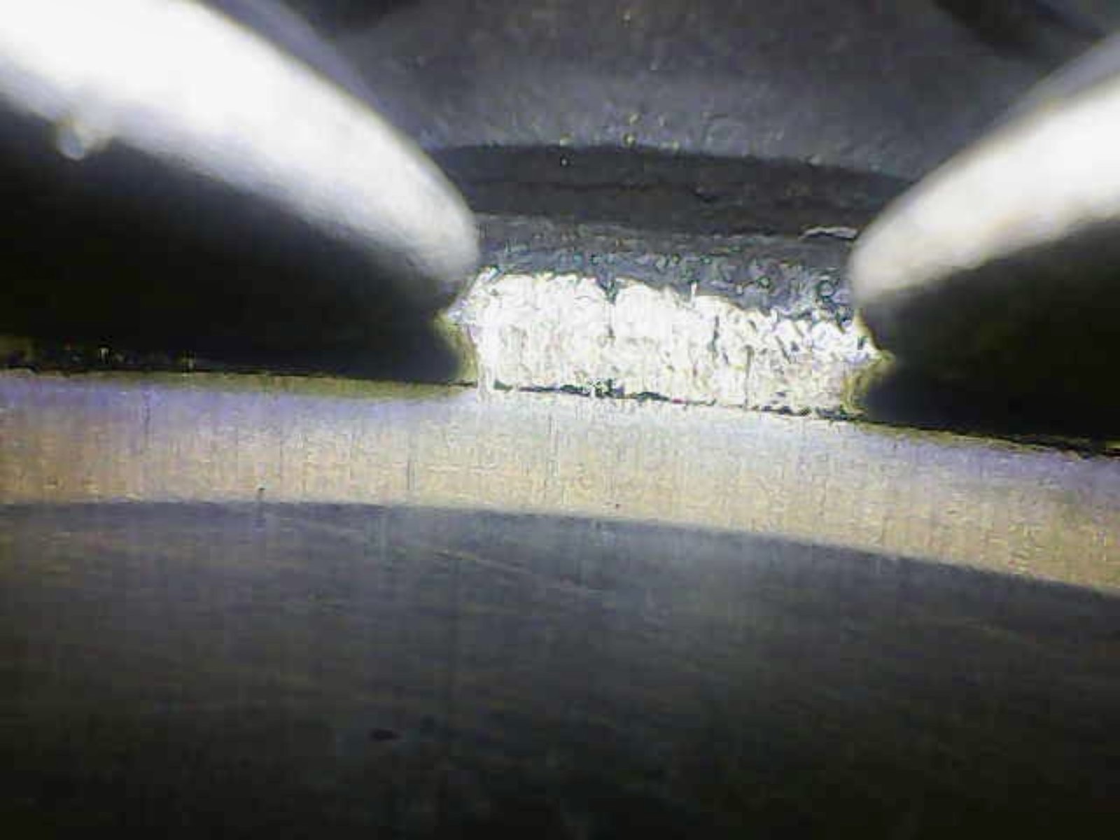

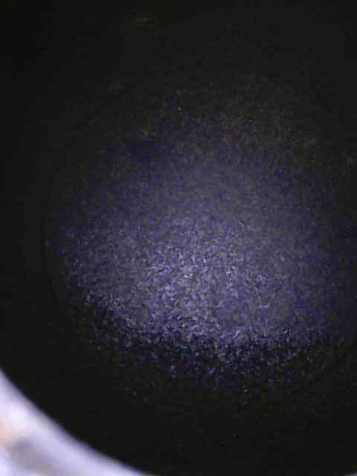

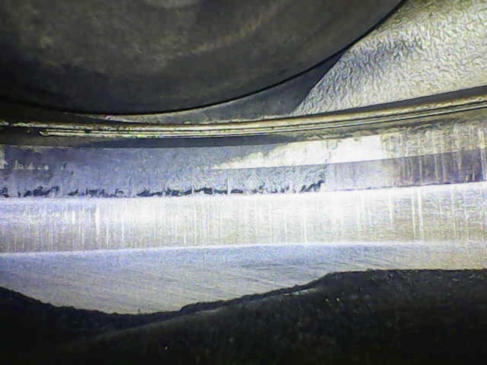

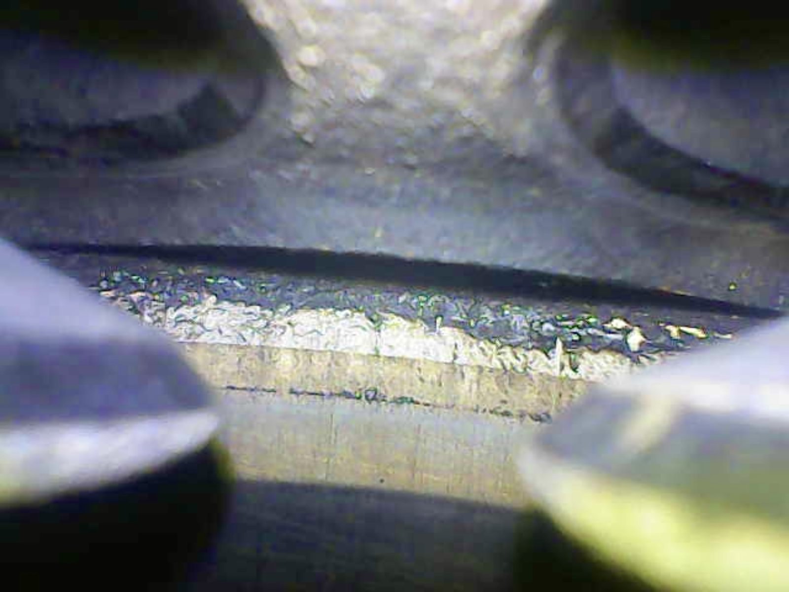

    What do you all make of this? Anything alarming for 210,000+?
    This is Cylinder #1 & the piston appears to be all the way to the top
    2 Valves look a touch open and 2 closed

    Rotate the crankshaft 1 full turn and take another look. If the valves are all closed at that point, it’s normal. I think your pics are showing near TDC on valve overlap between the exhaust and intake strokes so if you turn the crank a full rotation you should be near TDC on the compression or power stroke, depending on which side of TDC it actually is.
    Edit:
    On my second look, things look way too clean inside that cylinder, I’m not talking about the cylinder walls but the head dome and even what appears to be an intake valve. Are you loosing any coolant? I’m concerned that you have coolant leaking into the cylinder, which would most likely be a head gasket leak. The carbon on the top of the cylinder wall in your 2nd pic even looks wet to me.
    RPO 579C and windblown101 like this.

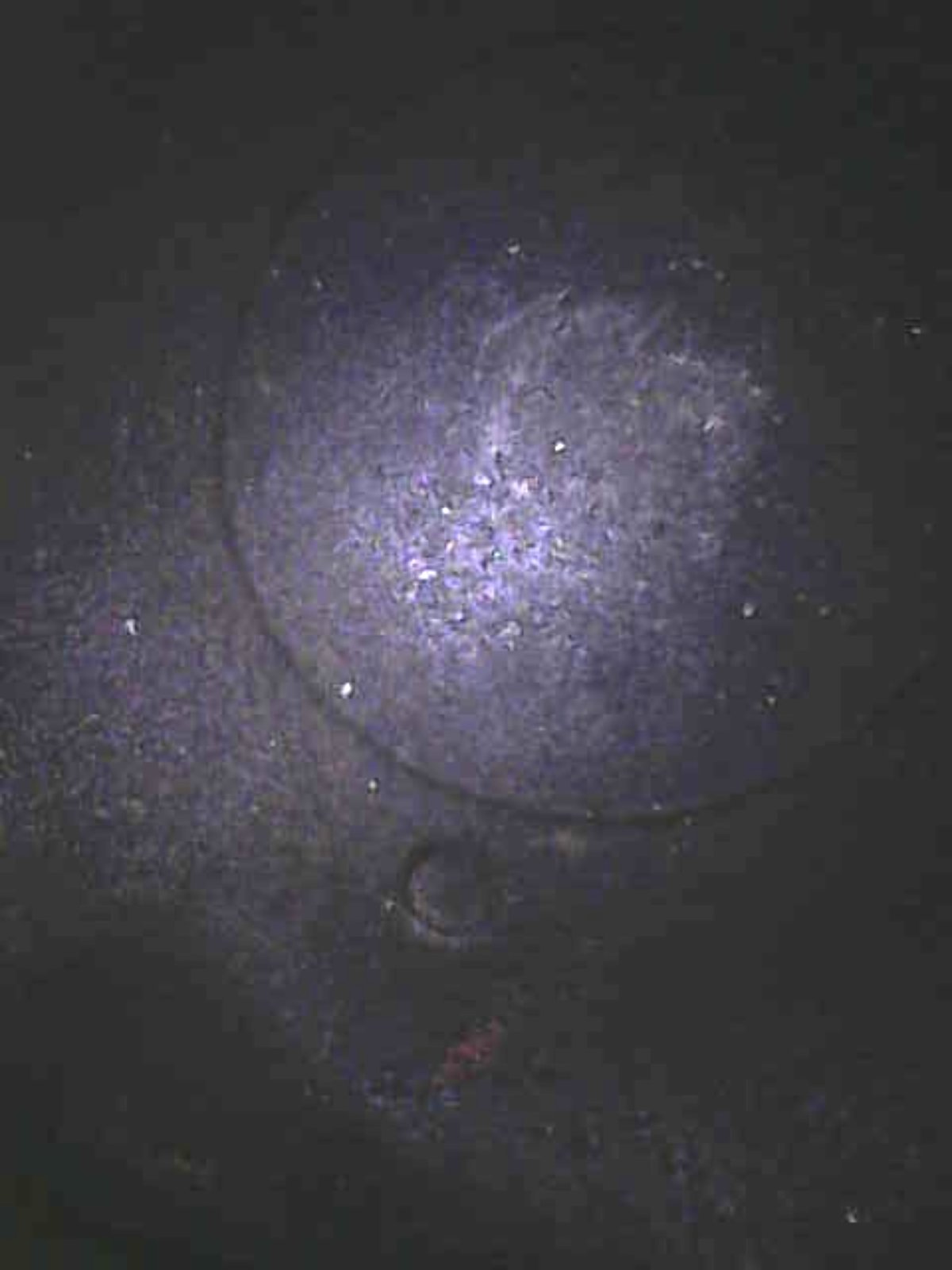

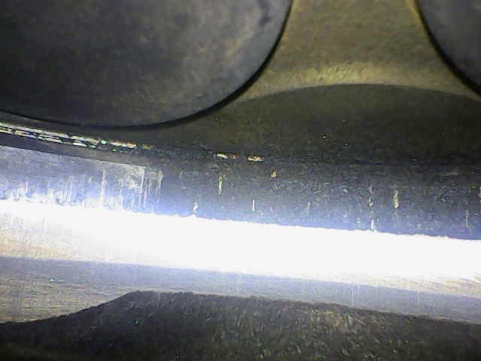

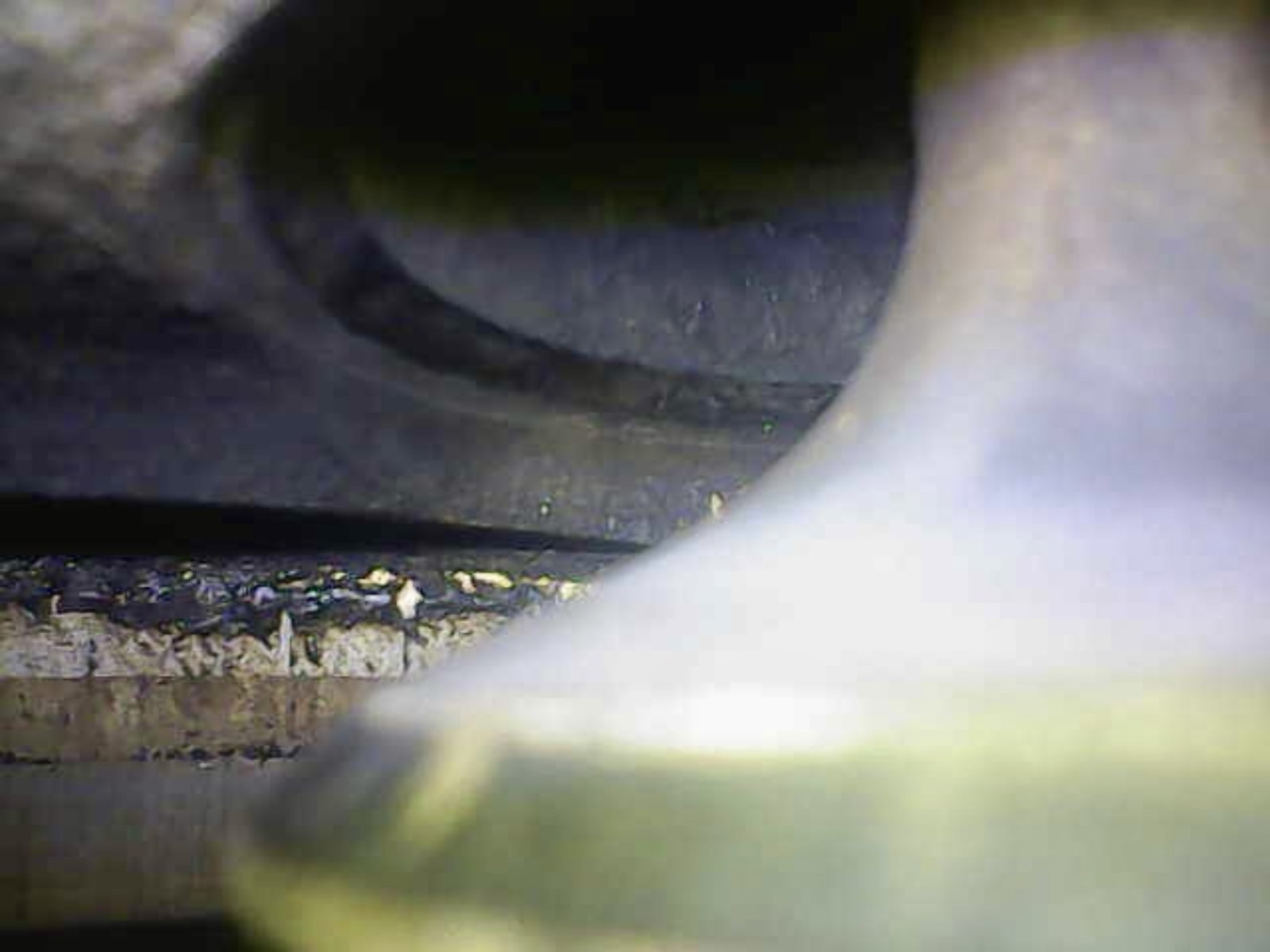

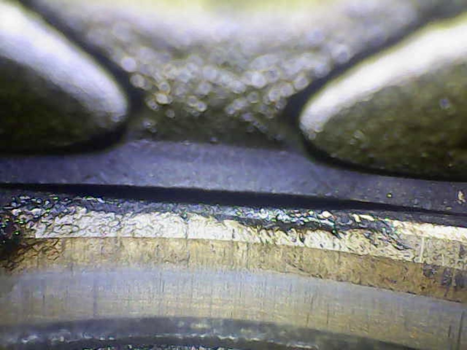

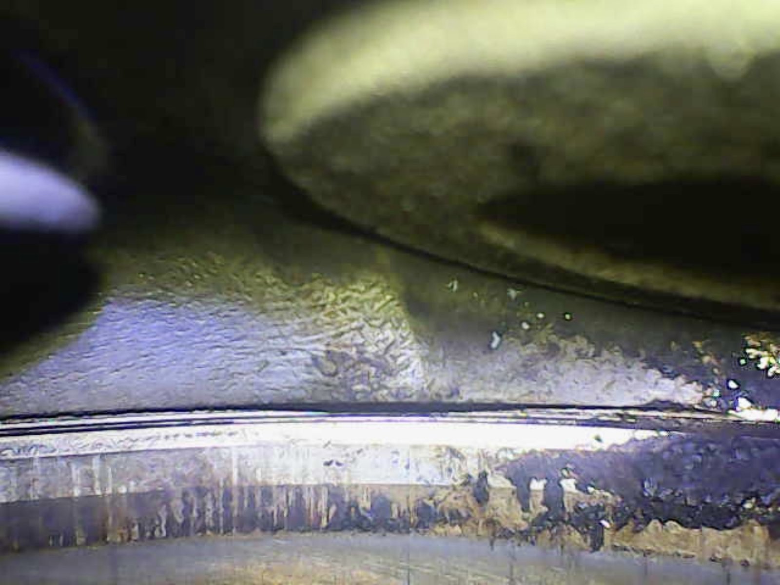

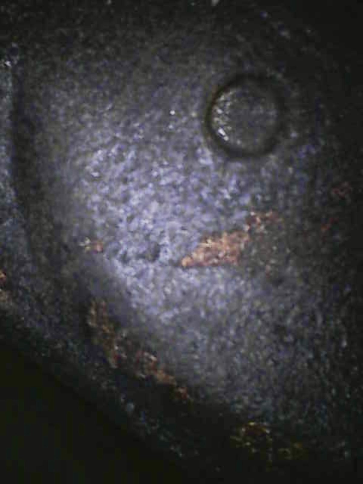

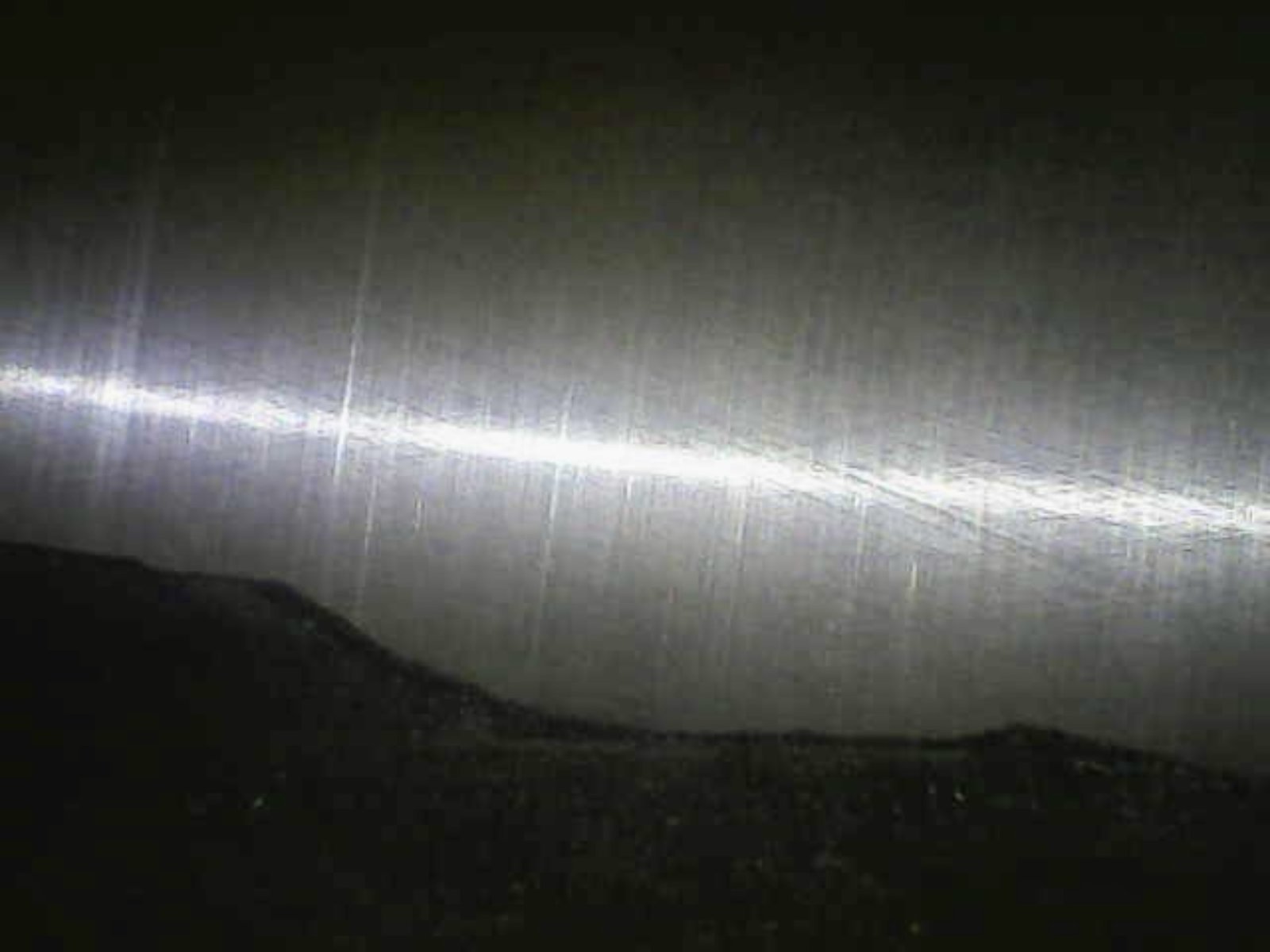

    I couldn’t rotate the shaft manually tonight but I did bump it and took some video and pictures I’ll post below.
    It isn’t as clean as the camera made it look, it has never used any coolant and it’s still full and clean now.

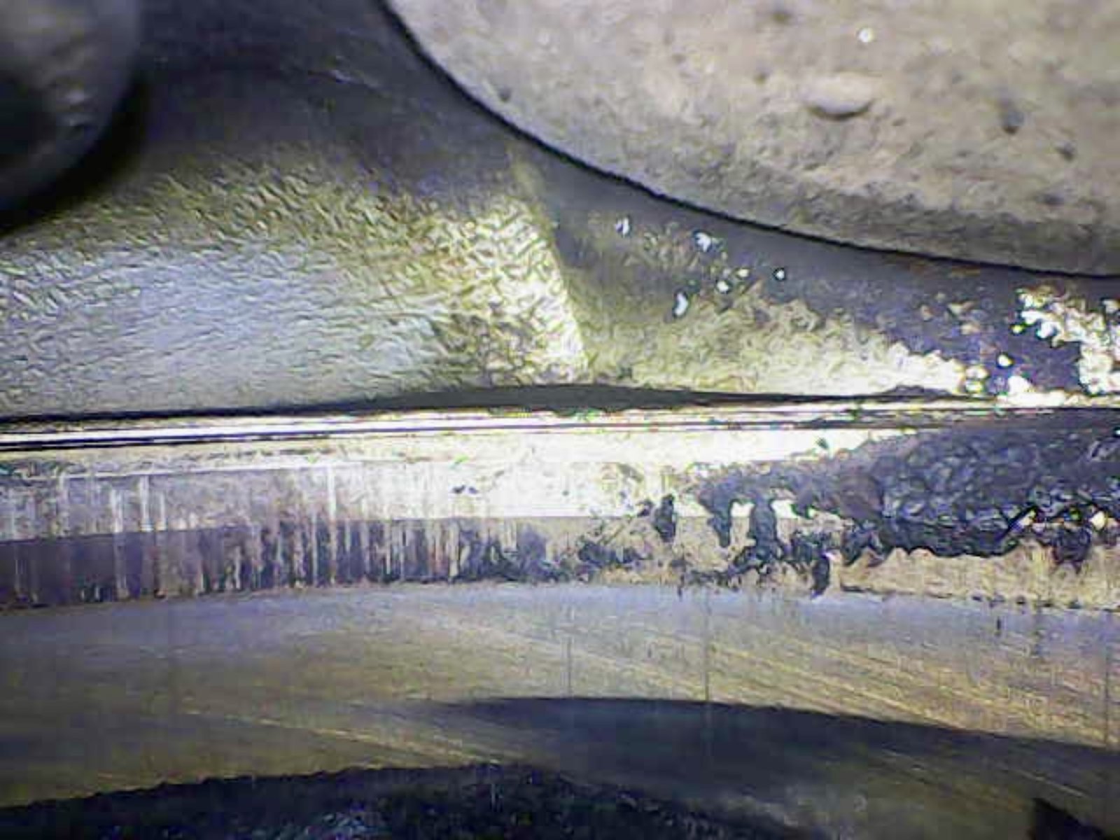

    Top of the Piston, you can see the carbon better here.
    You can see a piece of aftermarket coil boot that was stuck and was removed in pieces when I was first diagnosing this issue. The 360 begins and ends with that same piece of boot visible.

    On a borescope things look way worse then they are...
    That carbon build up is consistent with that mileage. I've seen way worse and other vehicles with half the mileage.
    The valves are open because the cams are off the base circle with respect to the valves. I.E. cylinder not a top dead center.
    It is actually a good view of the valve and seat which look ok.

    The marks on the pistons will sometimes be towards the outer edges depending on the angle of head. It is usually obvious when contact has been made, even if it was just slightly. The valves look like they are seating well when closed too. That scope is way nicer than the old Snap On I had lol.
