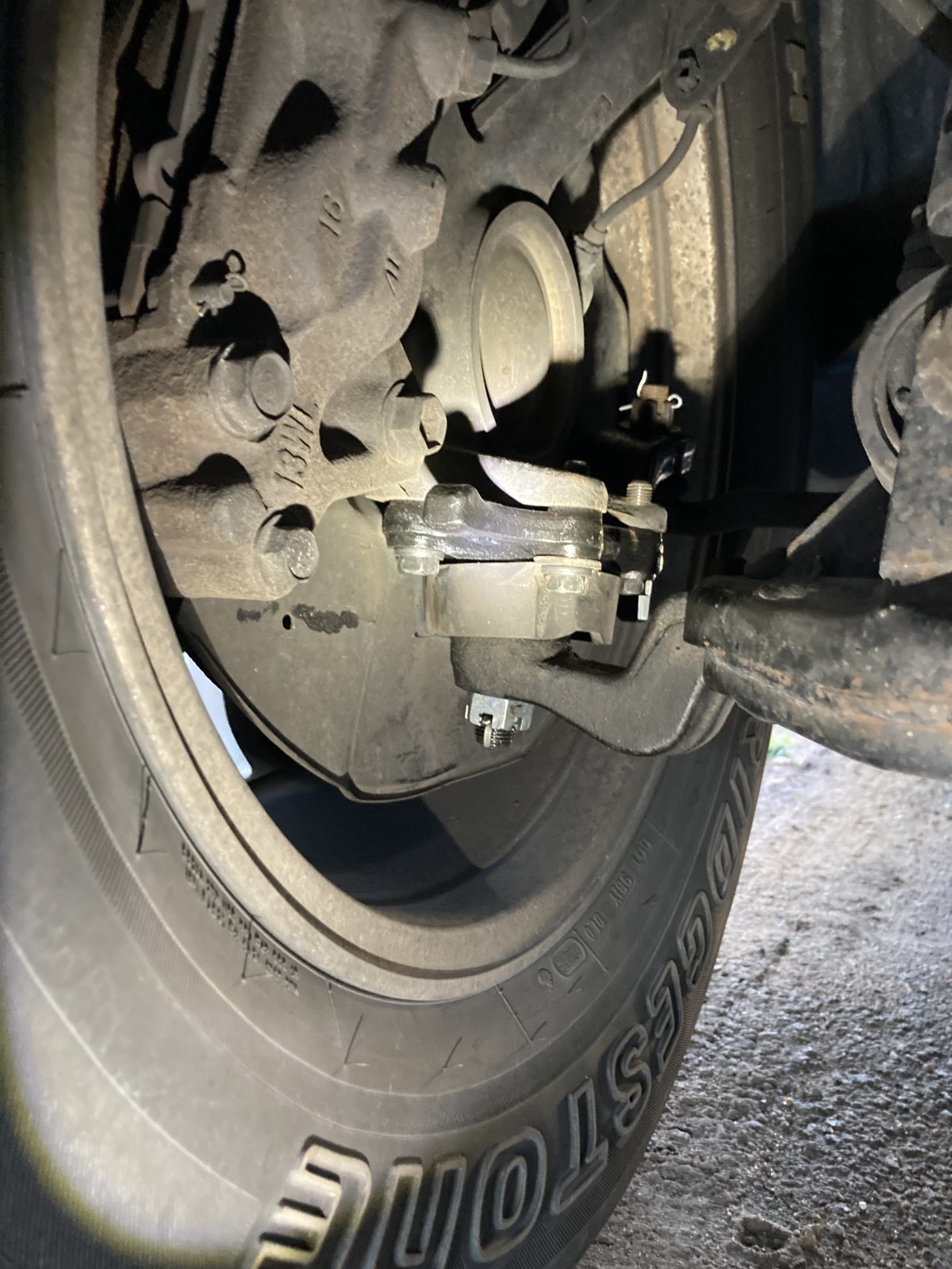

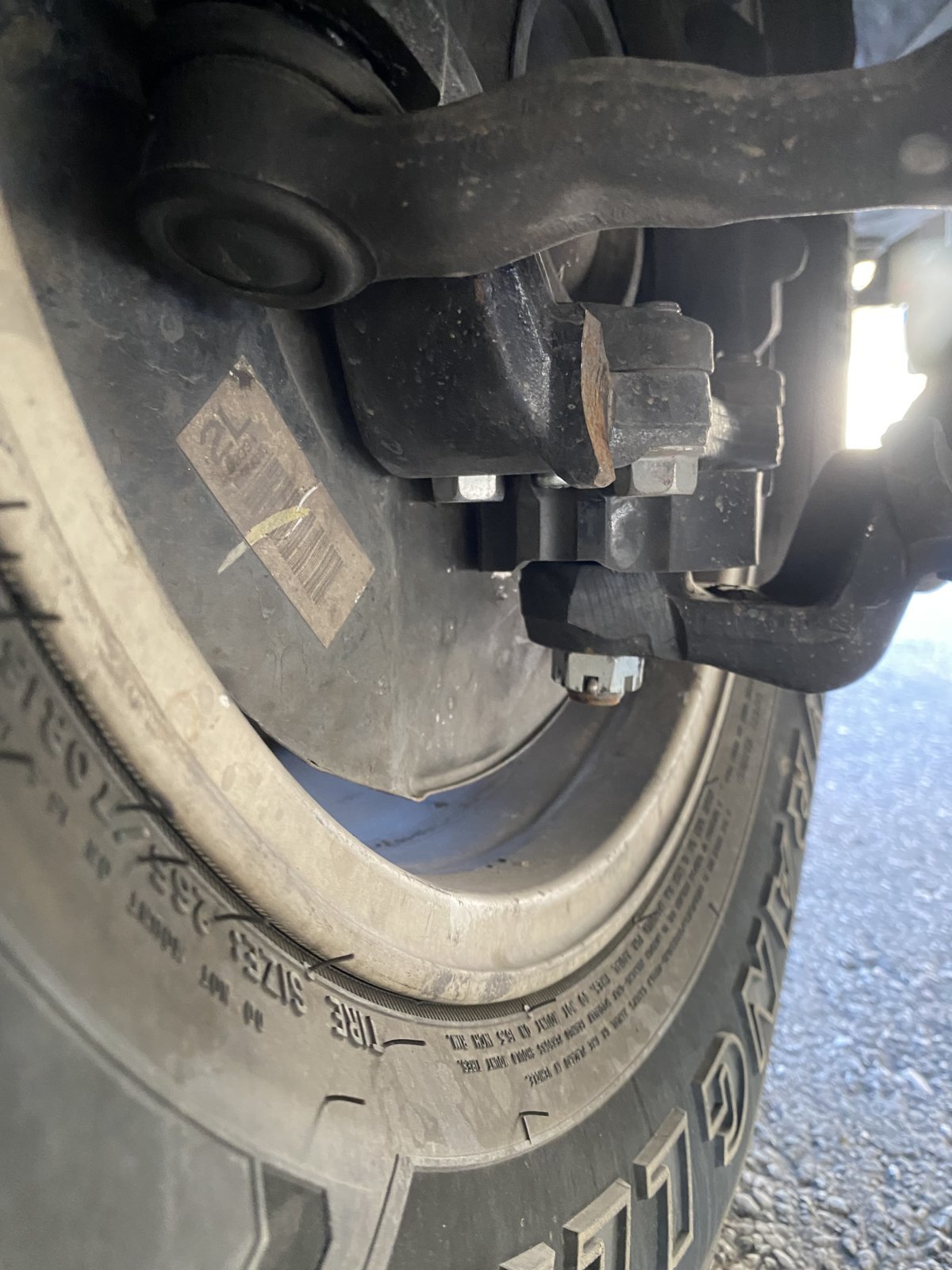

    Just bought my first truck — '03 AC, 4.7 V8, 130k. Pretty meticulous maintenance history. So meticulous, the LBJs were done at around 20k.
    So I just had them redone for safety's sake at the dealer. But something looks off about it — the replaced assembly looks like a mix of parts?
    Every pic or vid I've seen of the LBJ assembly has the "protector" piece as part of the part. In these pics, it looks like the Dealer used the existing. Should I be concerned about that indicating any kind of "wrong" part used?

    I think they just didn't have any dust shields on hand and reused your old ones.

    If they just got a ball joint the protector is a separate part through Toyota. Either way I wouldn't be concerned it's nothing other than a piece of plastic.
    I believe the 'recall kit' has all of the pieces.

    I would say nah but it’s weird the new LBJ’s didn’t already have new dust shields on them.
    Honestly, I would go talk to a manager and have them install new LBJ’s that have the dust shields already on them. It’s a part of the package. And since you probably had to pay a premium at the stealership. I’d expect zero corners cut.

    I would want to see the art number on the package for the parts they used. If it's the updated LBJ, good to go. Curious why the dust protector wouldn't be included though.

    For the larger style ball joints that come on the 2004 and new trucks, I know the recall kit comes with the rubber shields and they are already fastened to the BJ. I don’t know if this true if you buy both BJs individually. Then again the BJs cost a lot more when you do buy them individually, so maybe that what the dealer did?

    Those are good current part numbers for a L and R ball joint and a new bolt kit for a 2003 Tundra. You should be good. There's a "kit" that contains everything including the dust covers, they simply used the individual parts and not the full kit.

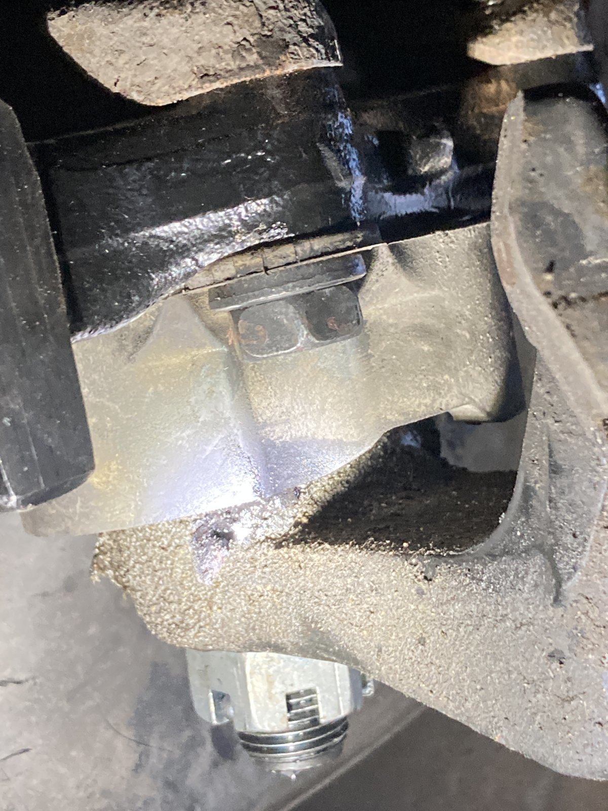

    Nevermind. I see you provided the part number for the bolts, so I guess they did the bolts? They sure don't look new to me....

    Agree with DigFerg those bolts look used. They are the black bolts which should only be torqued to 37 ft-lbs. In testing they retain their strength and grip better on reuse than do the red or green bolts which are torqued to 59 ft-lbs. Look at the Spicer Engineering posts here and on the Taco forums. Personally I would not re-use any LBJ bolts.
