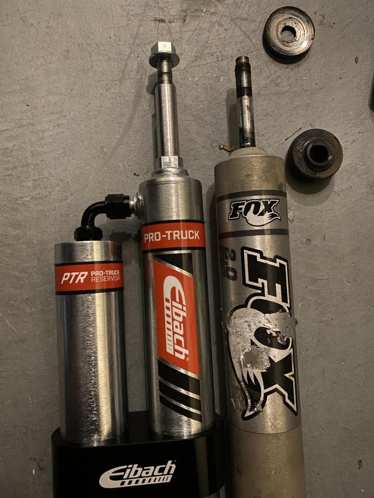

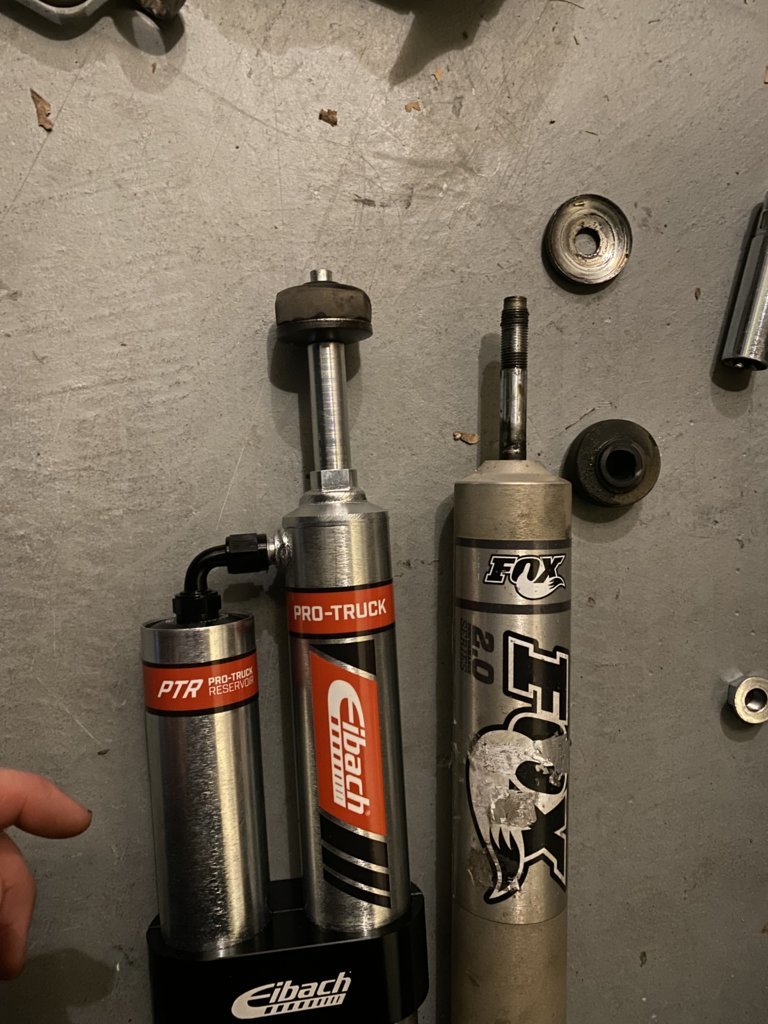

    Ordered an Eibach Pro Truck 2.5 kit from Hotshot. The front went on well. Now I am trying to replace my foxes in the rear and the bushings don’t fit. Did they ship me the wrong shocks? The shaft is much taller and wider and the bushings don’t fit/ washer won’t slide down post the threads so.

    Check the part number on the boxes

    Whats the part number?
    That looks like what is on the Eibach site, their instructions assume you have the stock bushings from your Toyota/Bilsteins. Its possible the Fox ones just aren't compatible.
    Rear Eibach shock for an unlifted rear (up to 1.5") is Part #: E60-82-067-03-01

    I am thinking the bushings on the fox are not stock and came with it. Replaced them 70K miles ago. So might be hosed until I can get some new ones in. Hoping cool springs Toyota has some locally.

    That or @memario1214 probably has some on a shelf
