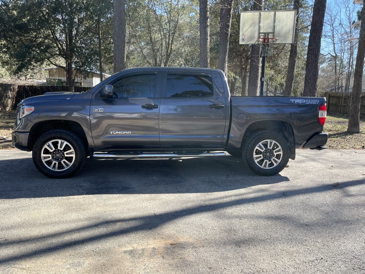

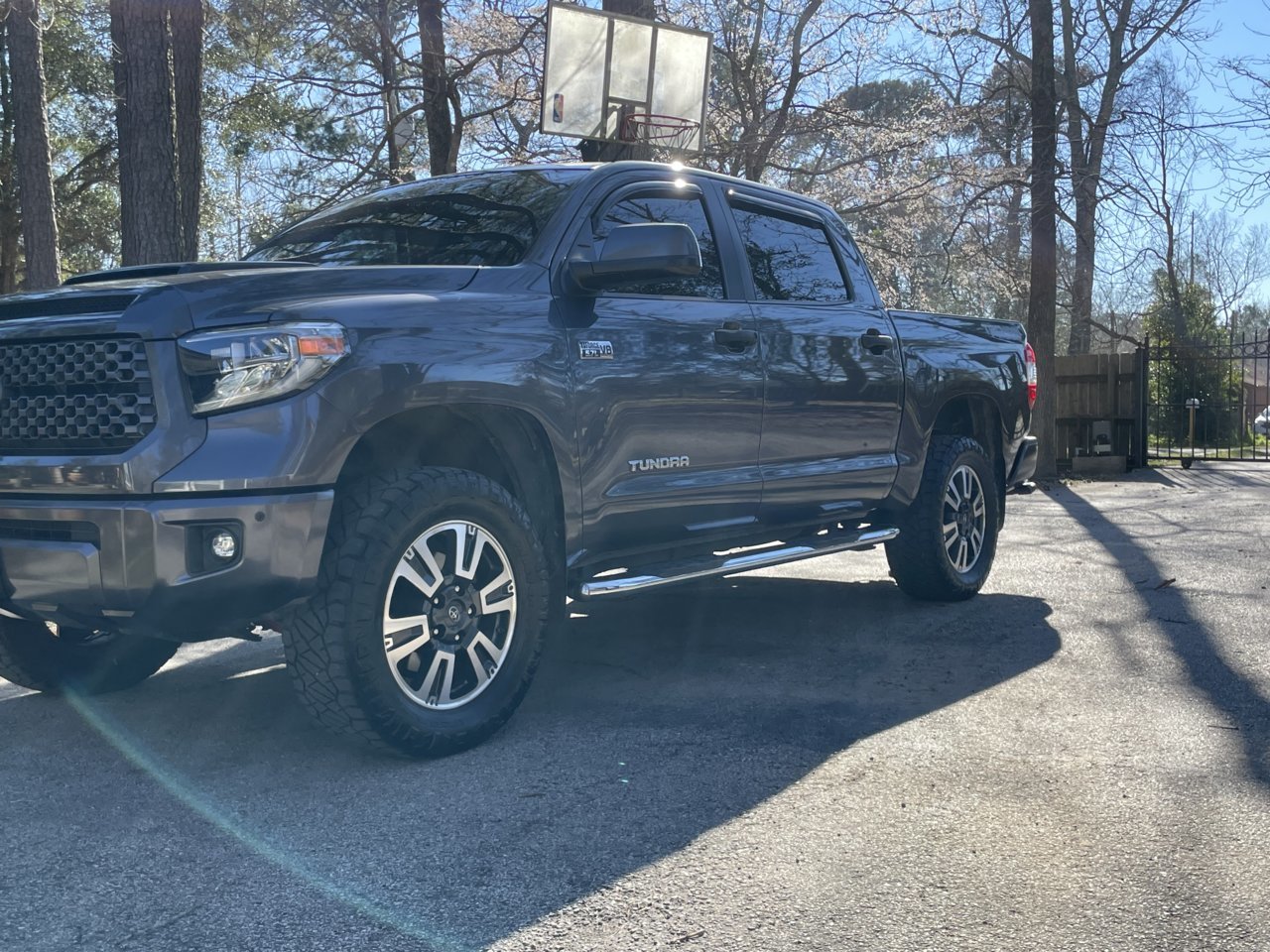

    I installed some leveling spacers I had from my other Tundra and 2” CB shackles in the back. 295/60/20 Nitto RB with no spacers. They fit like a glove.
    I will say the shackles are really on another level. They really smooth out those harsh potholes quite a bit. My 2nd gen has toytec shackles and don’t compare.
    The puck spacers won’t be on long as I want 5100’s but they are out of stock everywhere I looked. They are not harsh by any stretch of the imagination so they’ll do for now.
    Mostly I just wanted shamefully show off my new to me truck.

    That’s a shape looking truck! Coachbuilder shackles are awesome, I was surprised by the better ride quality. I also have their front spacers but have no intentions of changing out my shocks. They make some awesome products…

    Thanks man! Mine is a 18 with 60k miles so the red and blue billies are about due. I see a bit of oil residue on the shock tubes.
