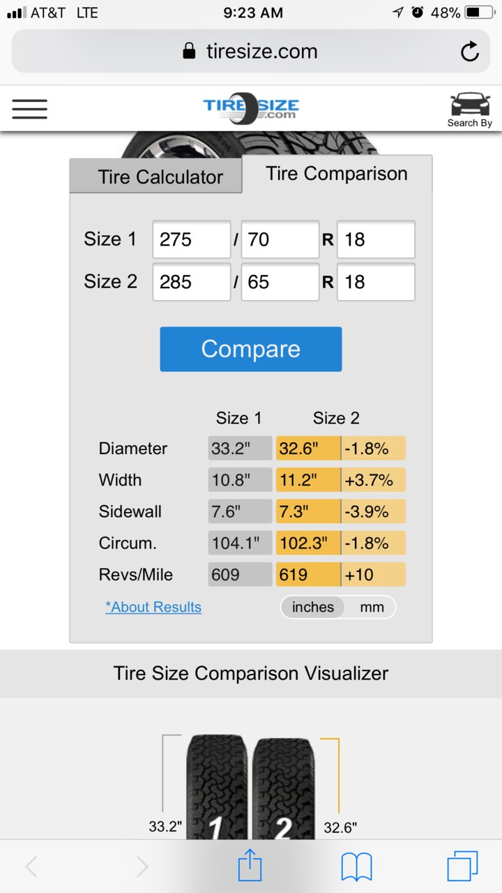

    Should I get 285/65/18 or 275/70/18 Nitto Ridge Grapplers?
    2012 CM stock suspension stock wheels.
    275/70 is

    Just depends on the look you want. 275/70 will be a little skinnier, and 285/65 will be a little beefier. Both will fit on stock suspension.

    And just for reference if you have a 275/65 R 18 stock The 285’s will be about a half inch taller and a half inch wider than stock.

    For me I like the 285. Just a little more plump than stock. But they aren’t a very common size. So from my research they have been higher priced then the 275s

    Would a 285/70/18 fit with stock suspension? This looks to be 33.7" tall.

    I think that’d be pushing it. But it is kind of a rare size on Tundras so I don’t know for sure. Almost everyone I’ve seen running that size is at least leveled out.
