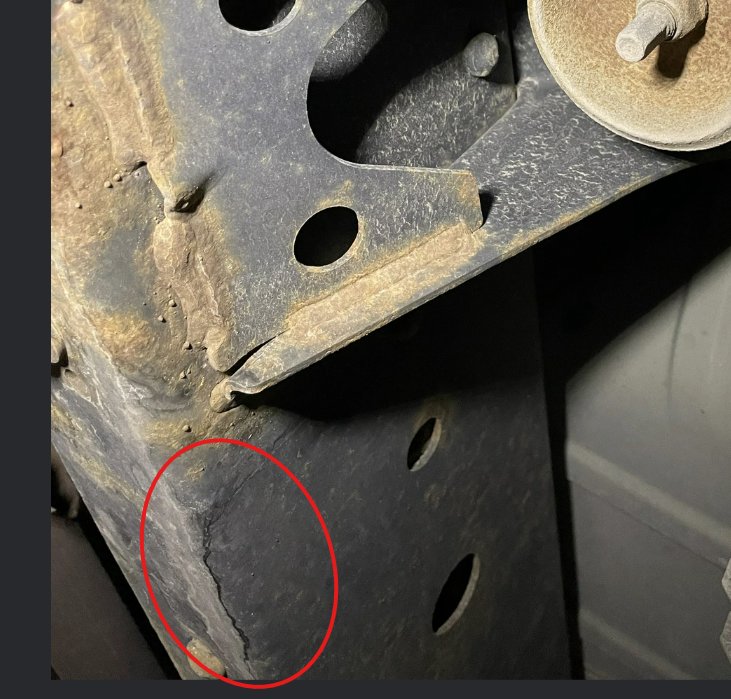

    Looks decent overall. Got to remember these are 20 years old (hence setting aside money). The one place I would want to look at closer is this part of the frame. Hard to tell what's happening there. You would of course inspect the inside of the frame too.

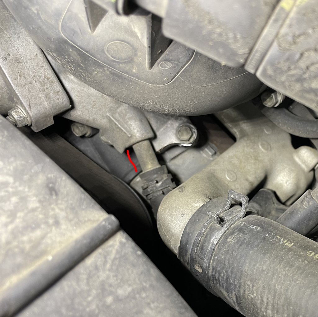

    Looks like the steering rack is weeping a little bit, but probably not enough to warrant replacement.
    Do the newer trucks have a different thermostat housing? Compared to my truck it looks like this hose is about to fall off (my truck with the hose removed for comparison)
