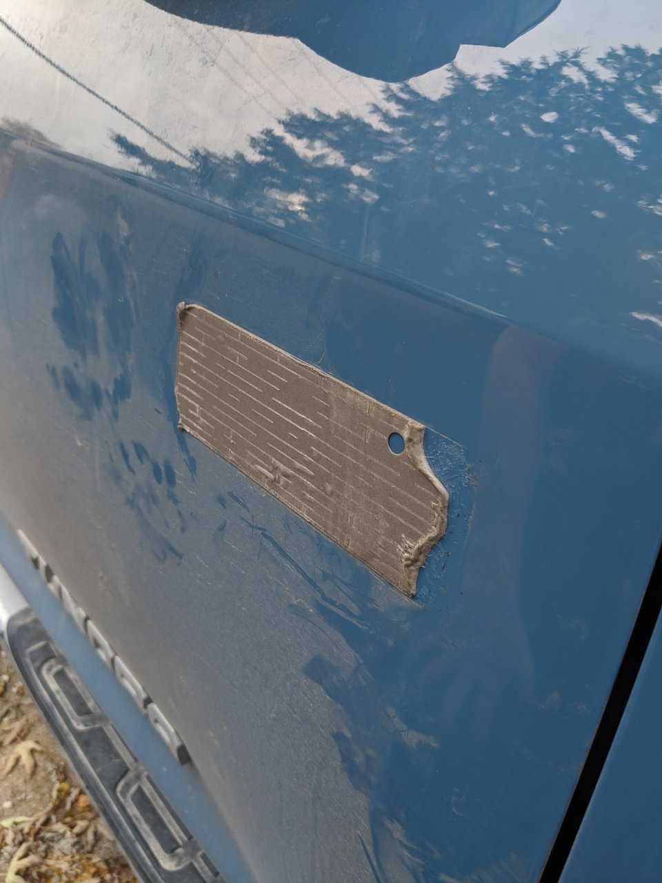

    Here is what was under my iForce badge.
    I debadged everything but still have Canada Flags to go on each side of the front doors (as you described).

    Once I saw that, I was happy they all came off and I wasn't about to replace them.
    It's just begging for water and rust to eat away at the paint.

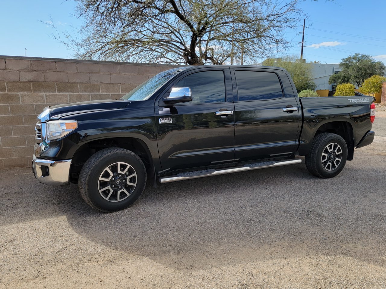

    Here's my truck with the Matte black flag, it's actually a magnet so I can remove later if wanted.
