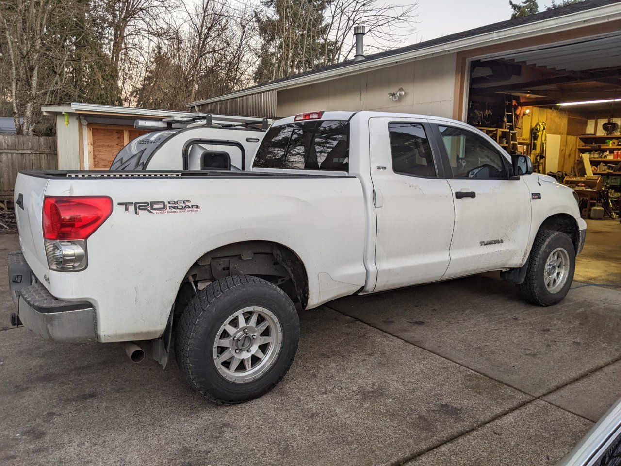

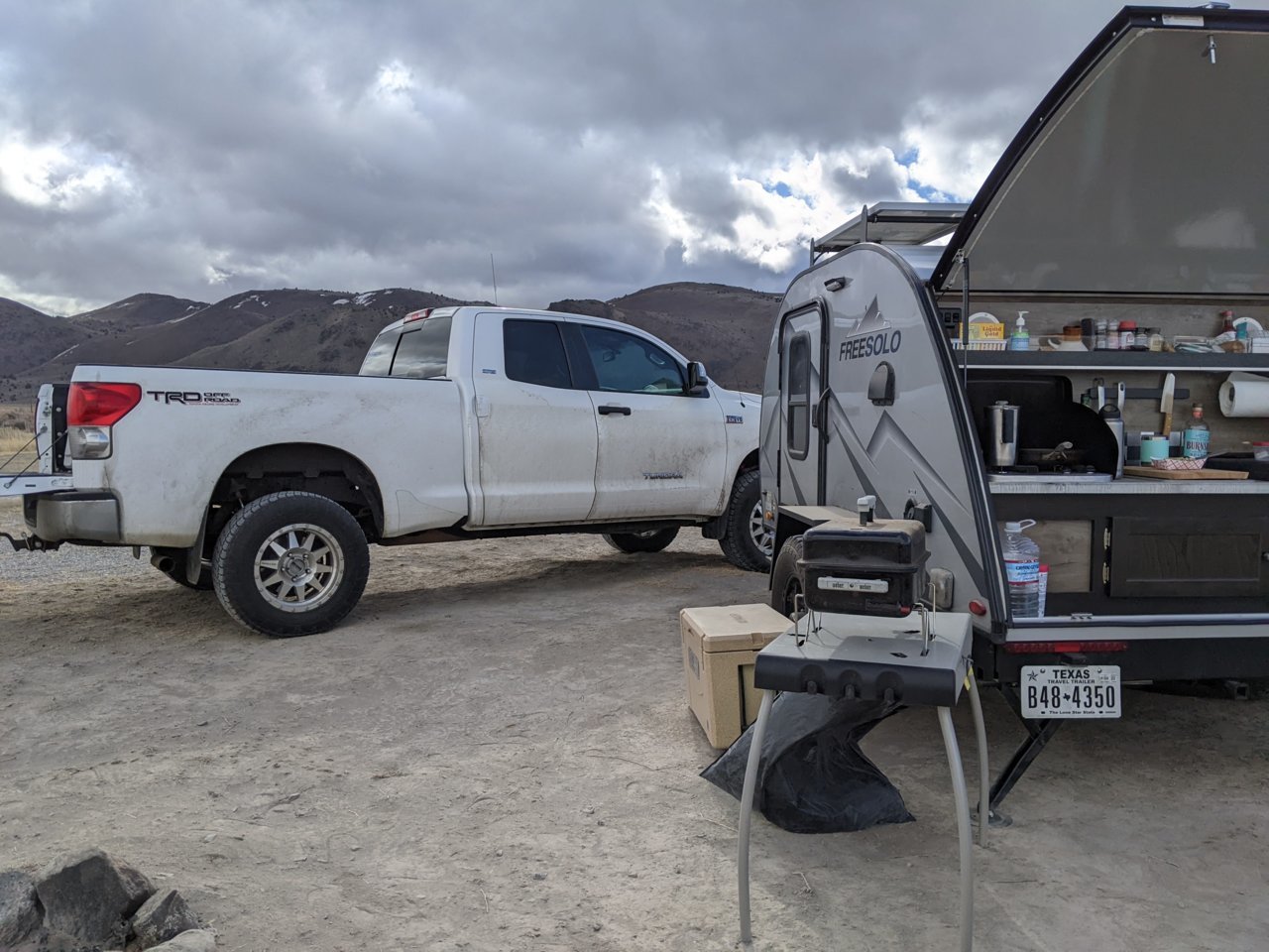

    Do you have any pictures at option 2? Based on weight I should probably be on option 2, but really don’t want to get a whole lot of lift, so I’m tempted to try #1.

    Not the best photos due to angle, but here's what I have. The driveway is right after installing and only driving 10 miles or so. The camping shot is 250 miles away, unloaded there, but had towed our teardrop there. BTW, this isn't TX, our new plates just haven't shown up.
