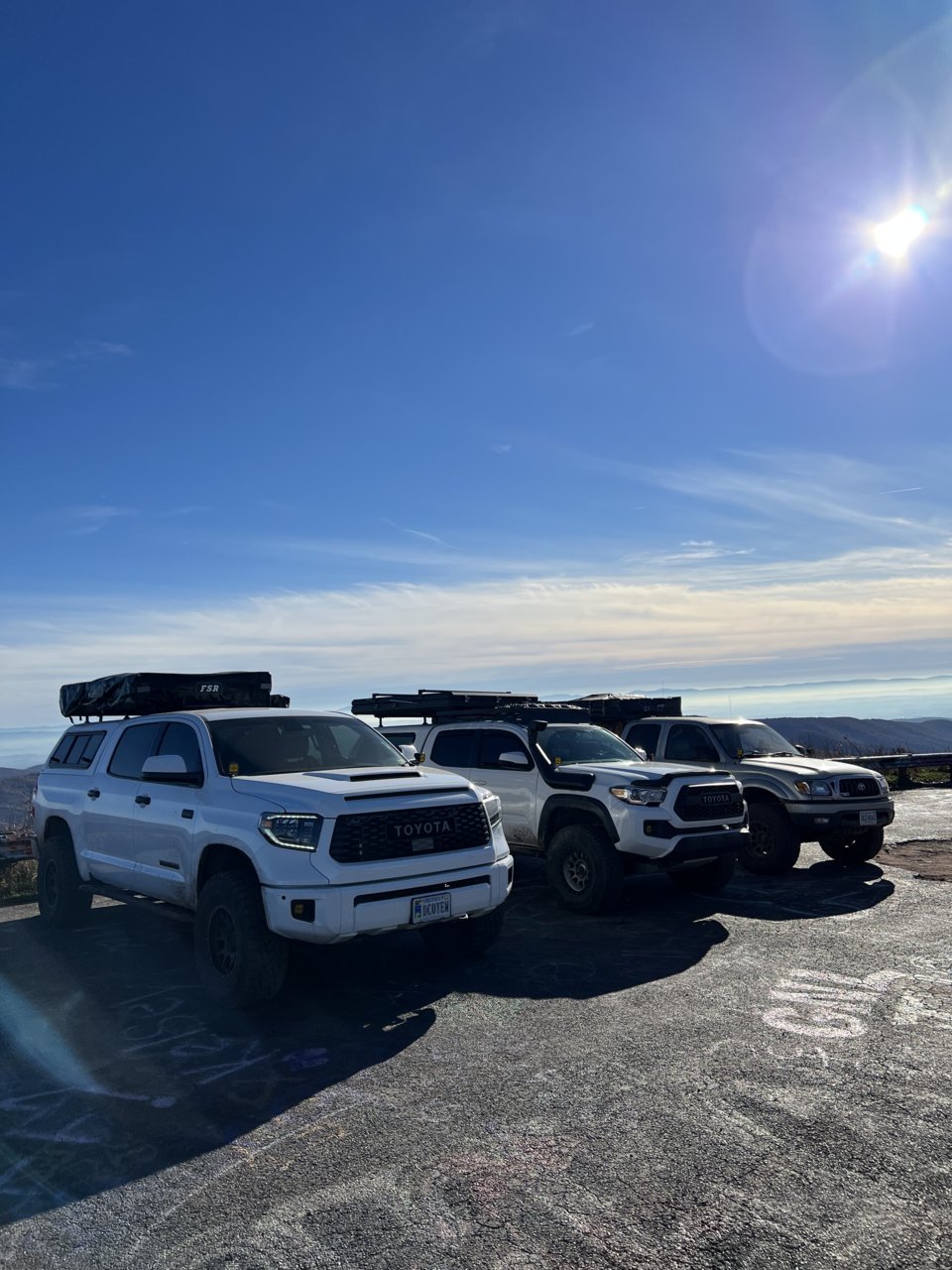

    Hello all, I’m trying to see if anyone else in here has opted for some custom springs to hold the added weight of overland gear and can tell me exactly what spec they went with. Currently I am running a set of deaver 748u springs and they can’t hold my weight up like i would like anymore. There is nothing wrong with the ride other than i have lost height and need more leafs to accommodate. I would like to know what others running heavy setups are running? I’m not wanting to add air bags or sumo springs as they limit travel when I’m off road. currently I’m running as follows..
    *Are cx had shell u sure of weight?
    *freespirit tent 180lbs
    *ovs awning 60lbs
    *high lifter jack 40lbs
    *5 gal waterport 50lbs
    *dometic cfx3 55 with slide 60/70lbs
    *full size spare 35x12.5 maybe 70 lbs
    *added gear for camping maybe 100lbs
    I’m thinking i am up around the 7-800lb mark now and the springs just can’t hold the weight like i would like. Thank you all for your input.
