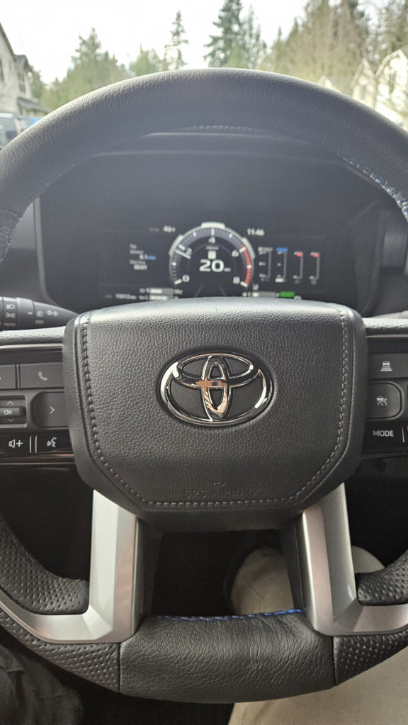

    After three alignments, truck drives great, but these guys cannot figure out how to center the damn steering wheel.
    Service advisor said the techs are having trouble with it because my lift, tires, and spacers.

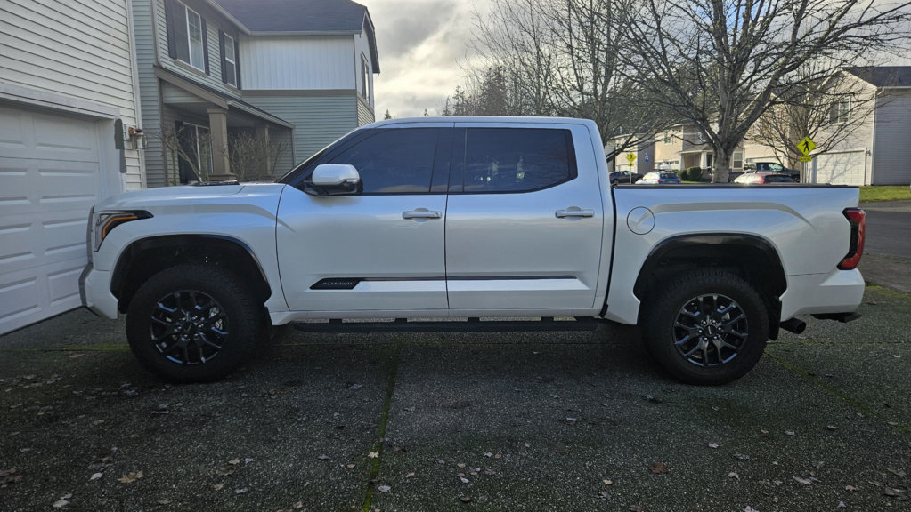

    Thank you! Wife got me a detail for Christmas so this was a low key way to show her off haha

    What wheels, how wide, and what offset are those?

    I use to be the alignment tech at my old job and had a couple customer come back for a "vehicle drives straight but steering wheel not centered" after I just did an alignment.
    Couple things I did to get the alignment "correct"
    1. Have customer center the steering wheel while the vehicle is on alignment rack. You'd be surprised what many people considered "centered" is different from one person to another.
    2. Have the customer sit in vehicle the entire time especially on smaller vehicles. Sometimes the customer is on the heavier side and vehicle leans more when they get in it compared to me. Especially when they are 300lb in a Nissan Versa.:hattip:

    The wheels are OEM with a 1" spacer. Tires are 285/65/20's
    My biggest issue isn't so much the tilt of the wheel, it's the center "dead zone" or the center of play.
    The center of free play is offset to the left. I can put slight pressure on the right of the wheel to make it dead straight. If I put the same light pressure on the left side the wheel will be about 5ish degrees off.

    That makes the overall offset about +30 which is the perfect offset, IMO. I wish they made a set of TRD pro wheels with that offset like they did for Tacomas. I could achieve similar, I suppose, by getting the spacers. And the 285s are exactly also what I want but my 18" OR wheels are only 7.5" wide and the Michelin 285s specify 8" minimum.
    That steering wheel issue would drive me nuts. I had that once with some car and took it back and they fixed it. Depending on the PITA factor with taking it back you could pull the steering wheel and rotate it one or 2 splines. I have pulled the wheel on a car with airbags once upon a time for other repairs and it wasn't that hard. But I haven't done it on the Tundra.

    The most common error in an alignment because it's the most noticeable. Your's is not as bad as I've seen. I will assume that that picture was on flat surface. If so, it's just a simple small tweak of the right and left tie rod adjustments. In this case, the steering wheel needs to be secured by locking it center level which looks to be a couple degrees to the right. Then, turn the tie rod adjustments on the left to slightly lengthen the tie rod and equally shorten the right tie rod. Then, of course, the road test, which most techs don't do.
