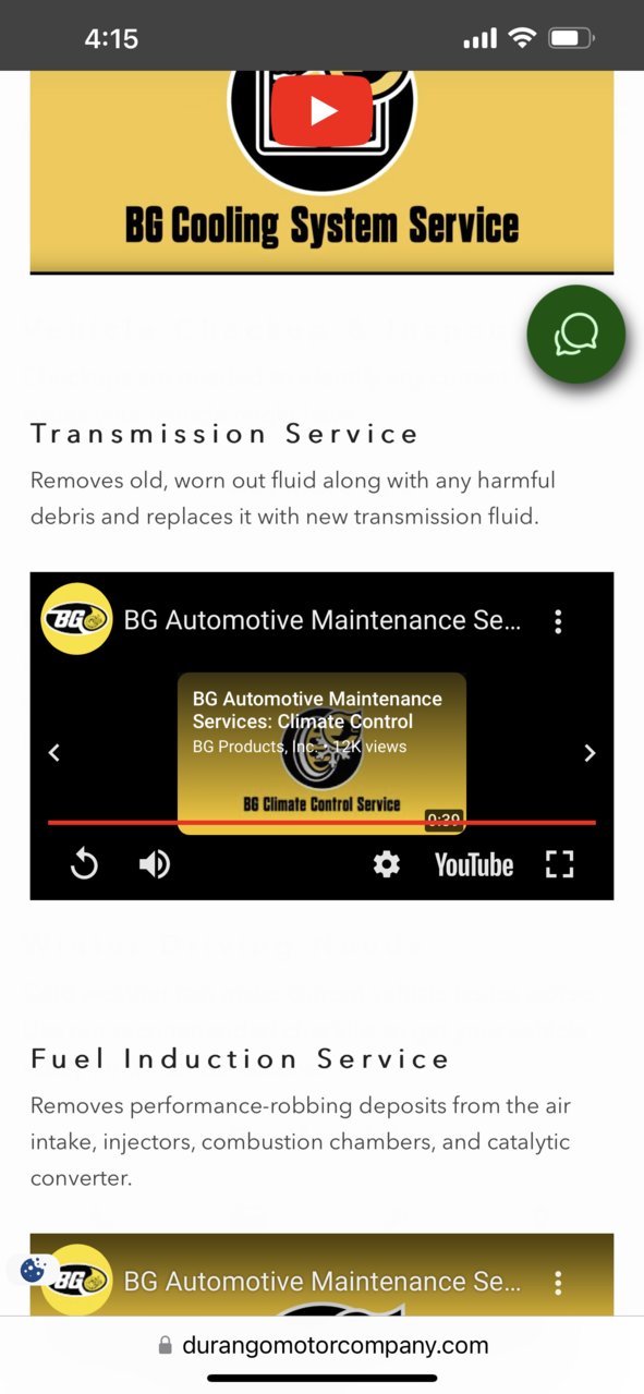

    Then I really start looking at my paper work. Notice that all the fluids are noted as "BG". I think to myself, they certainly can't mean the company BG that makes petroleum products additives etc. But yeah, they do. So I call and get specifics about the drain and fill. Turns out, they used two BG additives/cleaners in the transmission, ran the truck, cycled gears etc. w/ a "universal fluid" then drained and filled again with a "universal fluid." I forgot to ask as my anger levels were rising but based on everything so far, I am guessing the proper drain and fill method monitoring temp was not used.

    First off, I'd like to say that you should not be "flamed" for taking your truck to a Toyota dealer for service. I agree w/the concept that if you want it done right, do it yourself... but, when you take your Toyota truck to a Toyota dealer you should be able to expect the 'gold standard' of service and not worry about what they are using and how the work is being done. Unfortunately, this is no longer the reality for having your vehicle serviced at most Toyota dealerships (my local dealership included).
    My opinion on your concerns is simply this... If you are not comfortable w/what transpired and with the quality of service/products you received, nothing anyone will say here is going to ease that discomfort. I say you should do what you can to get the fluids into your truck that you feel comfortable running with and then try to work things out on the back end through Toyota corporate.
    Regarding a couple of comments about the expectations to use Toyota recommended fluids and parts, I think most dealerships have a paragraph or two on their website or posted in the dealership somewhere regarding the reasons why you'd want to have your vehicle serviced by a Toyota dealership...
    Why Choose Toyota of XXXXX for Your Service Needs?
    At Toyota of XXXXXX, we’re committed to providing exceptional service to all of our customers. Here are just a few reasons why you should choose us for your service needs:
    1. Expert Technicians: Our team of experienced and knowledgeable technicians is here to provide you with top-notch service and maintenance. They use the latest equipment and technology to ensure that your vehicle is running safely and efficiently.
    2. Genuine Toyota Parts: Using genuine Toyota parts ensures that your vehicle is running as it should be. Toyota’s Genuine Parts are specifically designed and engineered to work with Toyota vehicles, providing drivers with the confidence and peace of mind that comes with knowing their vehicle is running at its best.
    3. Convenient Scheduling: Scheduling your service appointment with Toyota of XXXX is easy. You can either call us or use our online scheduling tool to schedule your appointment at a time that’s convenient for you.
    ... so I think the consumer's expectation would be to receive Genuine Toyota Parts and Fluids unless you're told otherwise prior to the service!!
