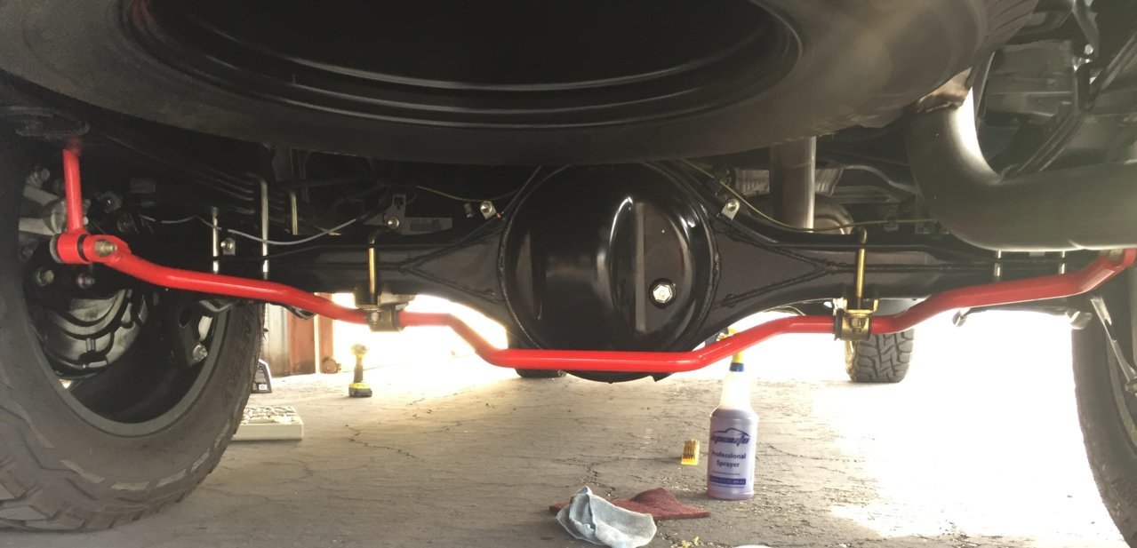

    This the only pic I have of the original TRD sway bar that came with the truck

    I'll take a pic of the new TRD sway bar and compare to the pic I posted earlier. For whatever reason, still unknown to me the new sway bar is night and day difference in all aspects, really enjoying it.

    I imagine seeing a problem arising more from the U-bolts (plate not true, sheared threads) so that area becomes loose and rigidity is lost. The down links are supposed to swing, no?
