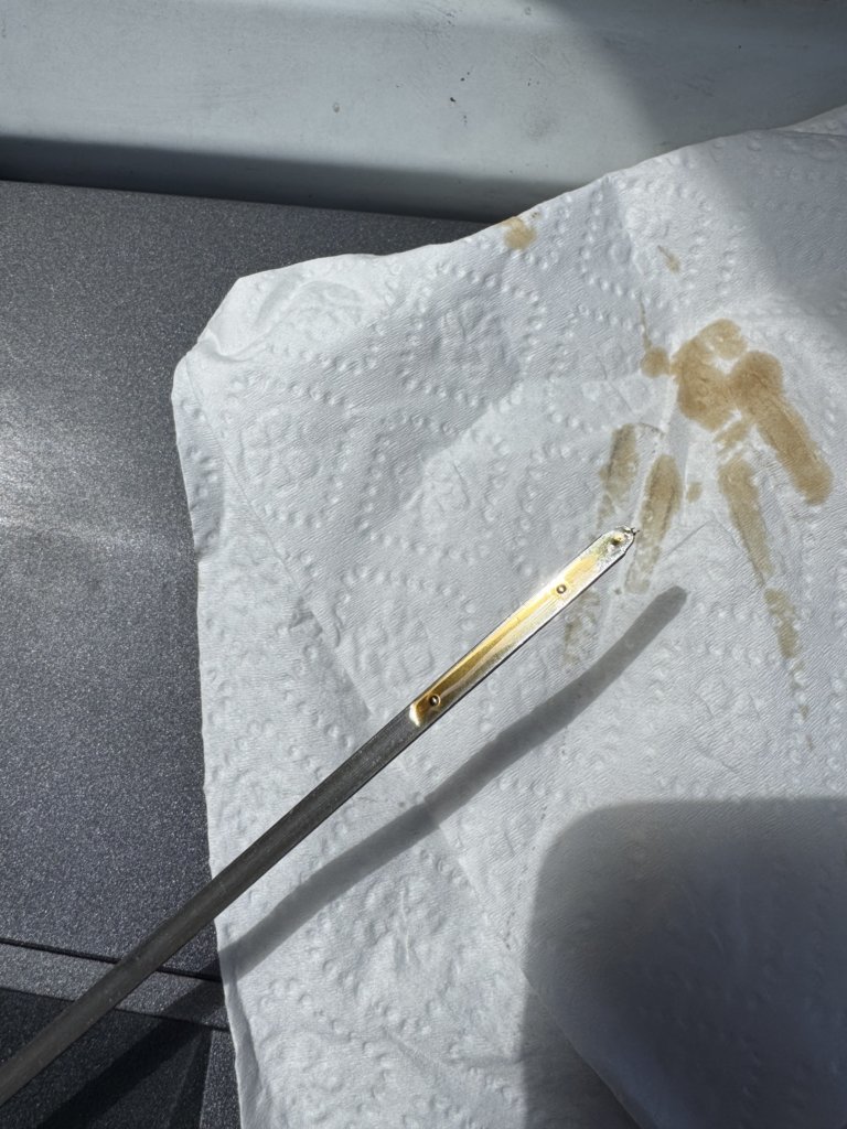

    Went to dealer for an oil change and the tech didn’t change my oil filter(didn’t know at the time). At around 3k miles after changing oil started seeing specs at tip of dipstick. Took it to another mechanic to change oil and that’s when I found out the filter wasn’t change. Should I be concerned? Paper from the filter was starting to mix in with the oil but thank god it isn’t metal.

    Yes that is a problem, redo the oil change and filter.
    Suggest that you NOT take the truck to a dealer for service.
    Find a local repair shop that has good reviews or from word of mouth from others. They will do a better job and it will cost less as well.

    Yeah took it to a mechanic I trust had the oil and filter changed. So far so good no more flakes. Will keep monitoring but hope no damage was done. Maybe a engine flush?

    How many times did they skip changing the oil filter? I would think they would have to skip it more than once for it to fall apart. I have heard of dealers skipping it 4 or 5 times.
    Pics of the filter would help us understand.

    I'd be concerned with the new filter getting clogged up with all of those particles. I definitely wouldn't drive another 10K miles before getting the next oil change.

    Out of curiosity, how did you determine they didn’t change the filter?
