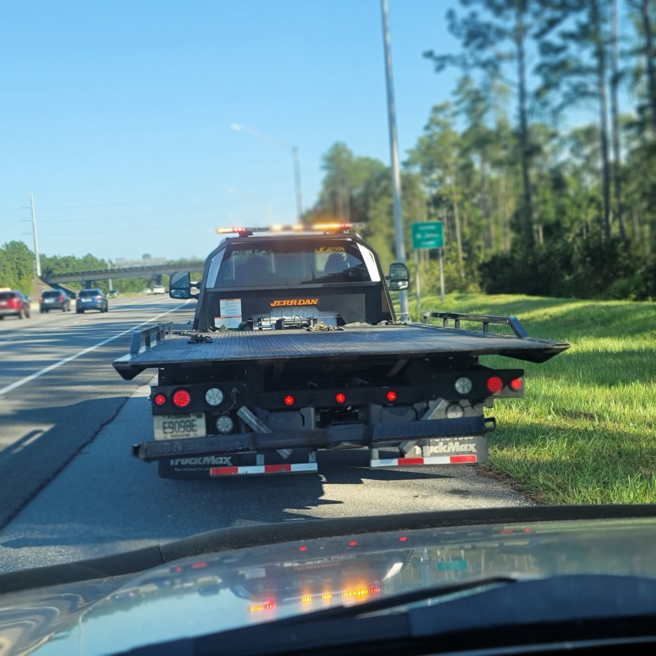

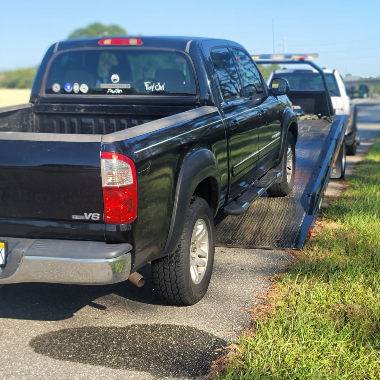

    Well, 1st real post and it is about transmissions. I was cruising along I-95, headed to St Augustine on Sunday when I noticed that slowing down, gave her more gas but nothing. I coast to the shoulder and turned her off. All guages looked normal, and she fired right up, but when I shifted into gear, nothing happened.
    With the help of a friend. We checked to see if the linkage on the tranny was moving, but no action.
