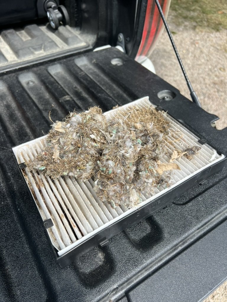

    Ugh- So I noticed the slight but unmistakable odor of "dead mouse" in my Tundra. It was upon start up and dissipated quickly. Easiest place to start with is the cabin air filter. This is what I found. My question is where else in the air intake "system" can I open up, clean and inspect. I am also interested in where the "intake" is that the mice are getting in.

    No kidding. Really surprised by this. I've never had a mouse issue with my '05 after 20 years. I had a similar cabin filter issue as OP with my '21 and paid the dealer a couple hundred bucks to install necessary mesh to fix the problem. There is at least one thread on the DIY fix for gen 2.5's. Not sure on 3rd gen info.

    My understanding the cowling for air to enter the vehicle is below windshield and wipers have to be removed, then a plastic cover of sorts.

    In addition to the cabin filter, I would take a look at both air filters and intakes under the hood. Fairly easy to put screen in the intake boxes to prevent them from getting in there too. Good luck!

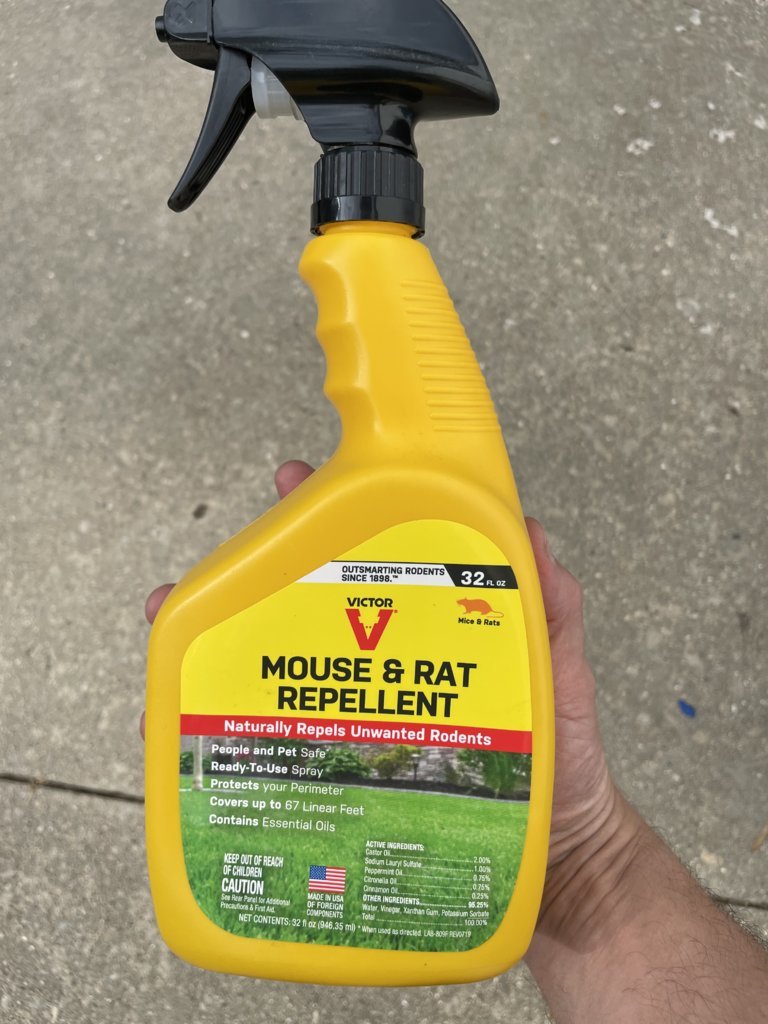

    Ever since I started putting these in strategic place in my stored and DD rides, I haven't had mouse problems.

    Beside the rodent bags that I mentioned above, I've become very proficient at catching persistent mice in the traditional old-school wooden mouse traps.
    My trick is to jam a chunk of some sort of nut in the curved part of the bait tray, then smear it with peanut butter. I've used peanuts, walnuts, almonds, etc... The mice can easily lick the peanut butter off without triggering the trap. But as soon as they try to eat the nut....SLAM. Dead mouse. Try it. I actually find it kinda fun and rewarding. If you get lucky and kill a big momma with babies, you can wipe out a whole generation of mice with just one kill.
