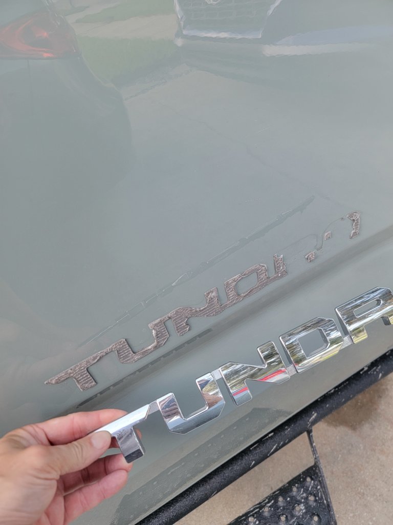

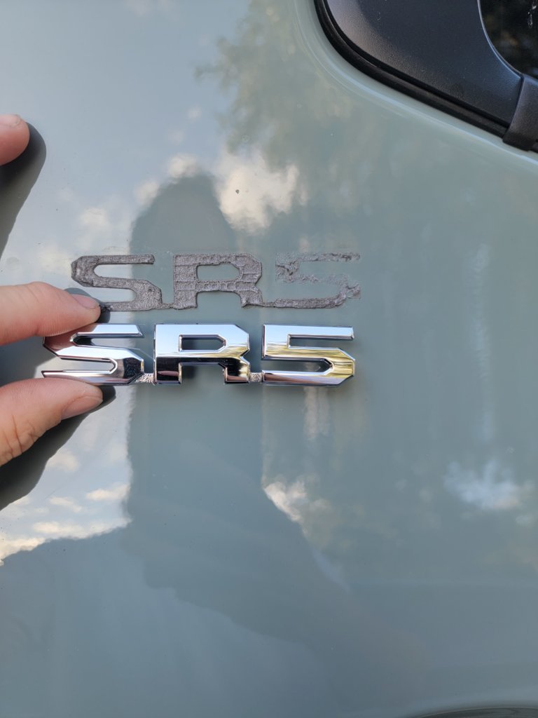

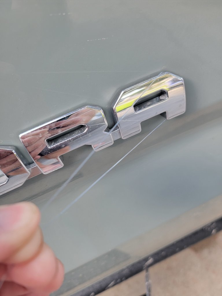

  14. Aug 29, 2024 at 5:41 PM
    Natalie fix
    Natalie fix New Member
    May 4, 2024
    #116379
    4
    2023 Ice Cap Tundra SR5 Crew
    on my 2023 ice cap tundra.
    -I heated with a hair dryer a few minutes.
    -took off badges with fishing line, degunked with hands/friction.
    -then used goo gone citrus.
    https://www.lowes.com/pd/Goo-Gone-1...86K2QkGANBAcLaw3PxRoC96gQAvD_BwE&gclsrc=aw.ds
    used a magic erase marker on the first sr5 symbol. it literally stripped the clear paint. it got that goo off great, then saw it stripped the clear in that spot only. not super noticeable, but noticeable if it's pointed out. ( so avoid heavy use of an magic eraser )
    then used Goo gone and it did a good job letting it sit for about 3ish minutes. then wiping with a clean cloth. that did not strip any clear coat. the outlines of the tundra letters remained in a couple areas and I used the magic eraser just at those spots lightly and it pulled it off. and it looks really clean now

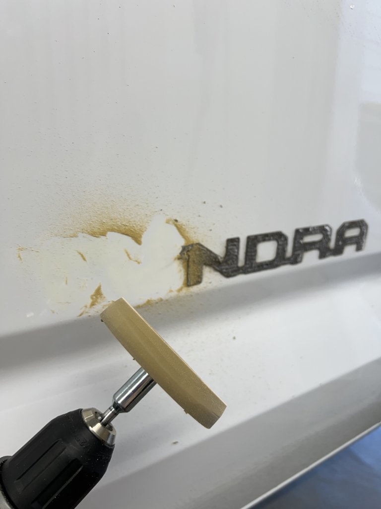

  15. Aug 30, 2024 at 8:30 PM
    6rian
    6rian New Member
    Feb 28, 2024
    #112774
    215
    Brian
    I recently did this and the adhesive eraser wheel made it crazy easy. No liquid adhesive remover was even necessary afterwards as it left nothing behind. No damage to the clear as long as you don't stay in one area too long. I hit it with a DA afterwards to remove the ghosting and apply sealant.

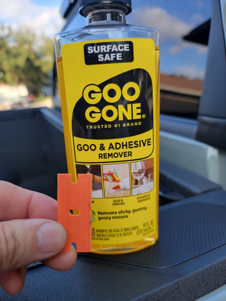

  16. Sep 14, 2024 at 3:46 PM
    11CMGray
    11CMGray New Member
    Aug 24, 2018
    #18523
    195
    Just de badged mine, didn't use the Eraser wheel though it would have cut the time in half. Might use it tomorrow for the driver side.
    Fishing line, finger friction, goo gone and plastic razor blade. Rubbing/buffing compound once everything was removed
