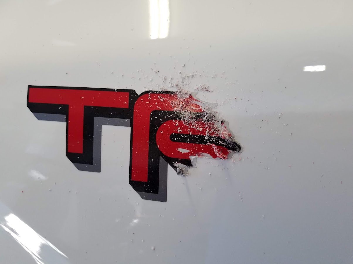

    I tried to peel that TSS decal off in one or 2 pieces and that wasn't going to happen.
    https://youtu.be/WB27bqr7kJQ

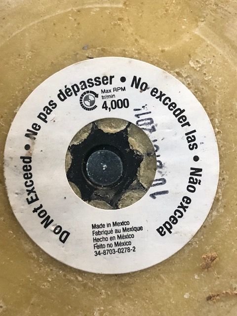

    Go slow and under whatever RPM is read on the wheel..
    Mine reads 'do not exceed 4000 RPMs'.

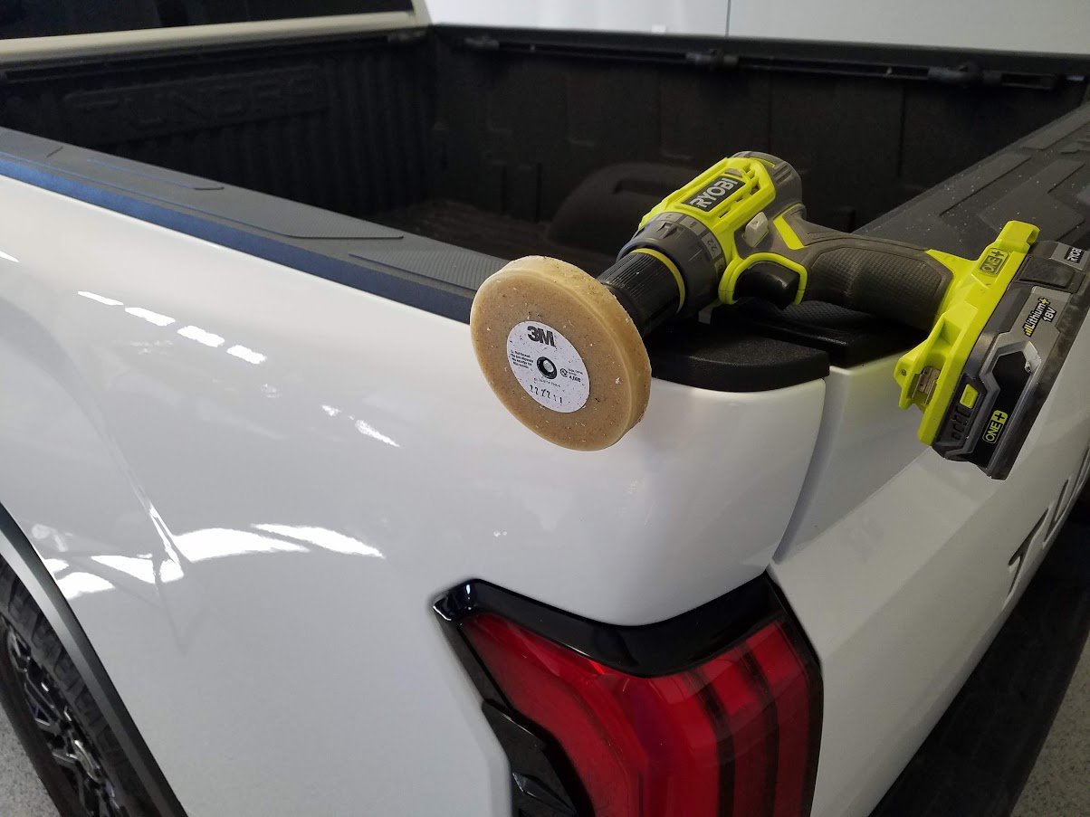

    Job complete. The 3m wheel worked like magic. Cordless drill and low rpm. Took my time and was finished in 15 minutes. No adhesive to remove and zero scratches. B013SfpntiEAeOIyeM5vGj_UL6uAmUHgDfQU4ri4_d7021d38f0005361d272ad4df1952fb5256d0127.jpg 0L8SJLhCAIKyRHGgV-j0H3vIYsrXQfJUqZ6ockB1_f54b40151e163bd165fe164f6f3838974884a603.jpg

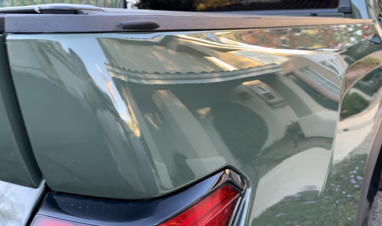

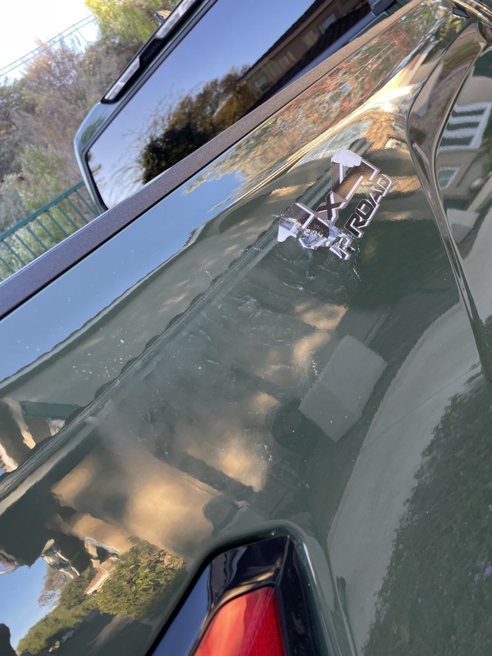

    I was going to post a thread on this because I went through the same ordeal. Just never got around to it.
    I was trying to take off the rear bed decal and instantly noticed it was nothing like my tacoma or any of the numerous vehicles I’ve debadged in the past.
    Tried with a heat gun and it only took off the top sticker layer. Tried goo gone and adhesive remover that did nothing. Drove to my local wrap shop for help and they had no clue and hadn’t seen anything like it.
    Finally I searched on here and saw one post about the 3m wheel. Drove to auto zone and got one for 30 bucks and it did the trick. At first it left some cleaning to be done after but I just used a microfiber and some polish and it looks like glass.
    Hopefully people read here before attempting with anything else because it simply won’t work.
