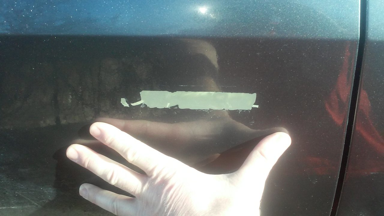

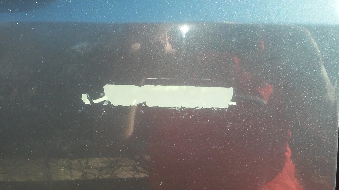

    De-badged the truck today. All good until the last one (6 total). The second big V-force 5.7 badge went bad. Had the truck in the sun and used a heat gun with fishing line. I guess this one got too hot, did it the same as the others. Almost all the adhesive stayed stuck to the truck for all badges. I used my thumbnail to start then rolled off the rest the adhesive with my fingers - easier than I though it would be. Seems strange that the paint came off in this uniform rectangle?
    I suspect these badges (adhesive) are put on before the paint is really cured. The jagged parts of the removed paint are from my finger nail about 30 minutes after the adhesive peal event.
    This is far from a show truck with plenty of pin strip already, any chance they make a rattle can that comes close to this metallic dark grey?
    No, the badge is not going back on!
    thanks
    Bob

    Ouch, sorry to hear and see that.
    As for raffle can, hopefully someone will chime in. I have no clue on that.
    If it was me, is look for a TVD Decal to put over it and cover up the blemish. State flag etc.

    Ouch, that's a tough one. I don't think a rattle can is going to work there—it'll be way too noticeable on that big of an area. Have you thought of adding black badges, or was your goal to completely debadge?

    Buy some black badges. You will never be able to hide that with a rattle can. You would have fill in the missing paint with bondo or whatever and sand and repaint the whole panel...even then it is doubtful it would be a perfect match.

    Could easily be wrong here, but I'd be shocked if any dealer ever repaired under warranty something that was damaged by customer intentionally modifying the vehicle. No way can that be considered a paint defect. Worth a phone call though.
    My vote would be a new badge of some sort. Flag, hobby or passion or something like that.

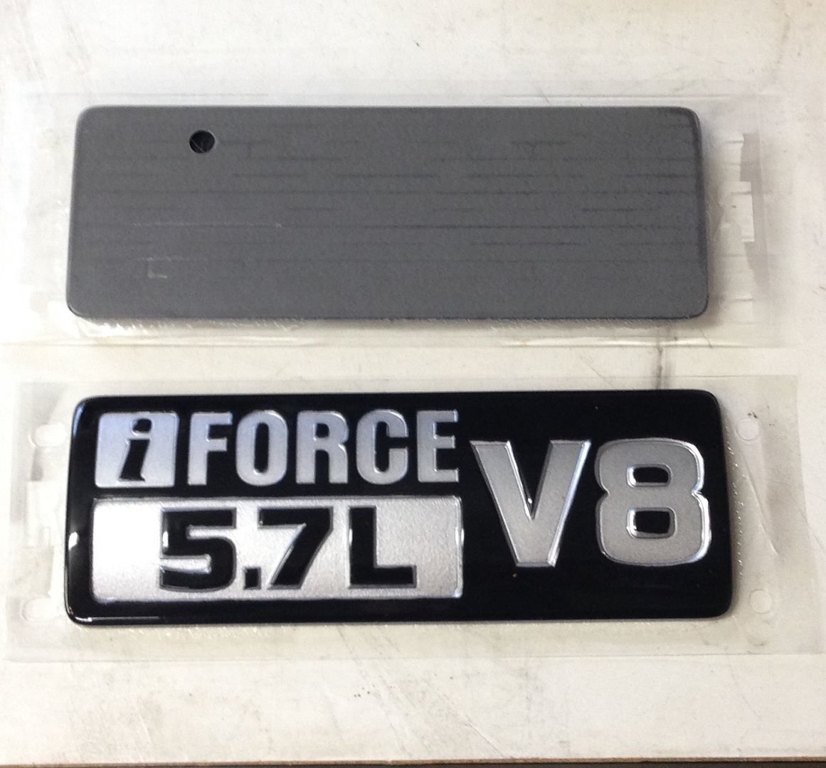

    I bought a black set of iForce badges years ago and them custom painted.
    I've yet to use them, might put them on when I get rid of the chrome bumper ends.
    Only posting them to show options you may have if you want to put the badge back on.
    It looks better than the pic, the light reflection messed the pic up.

    Gotta repaint the panel. No other way to fix it. Doesn’t require body filler. Just remove the paint around it to blend and repaint.

    First of all, I'm really sorry that happened to you. Live and learn, I guess. Second, YES, Dupli-Color makes a "exact match" (their words) Magnetic Gray Metallic rattle spray can. And I have used it: when I installed my first set of pocket fender flares. And, no, it was NOT and "exact match".
    https://www.amazon.com/Dupli-Color-BTY1619-Magnetic-Exact-Match-Automotive/dp/B00407RRTG
    It was an eency, weency bit lighter than my factory paint and noticeable to my very discrminating eye. Maybe Dupli-Color takes into account paint fade or something. Either way, my rig is a 2018 and I wax it twice a month. I have since replaced my flares and had them color matched and painted by my most trusted local body shop.
    Third, I am with @Tundra234 in that you should just bite the damned financial bullet and have it painted professionally. It's a $40-50k vehicle for crying out loud, and you do NOT want it looking ghetto.

    I may find god after all !!!
    Preacher35 has come through with the holy rattle can magic I desire!!!
    I'll sand down the edges nicely, maybe even swipe on some filler, spray some holy juice, feather it out, etc. ... And recite some prayers of course... and Viola itza fixed!
