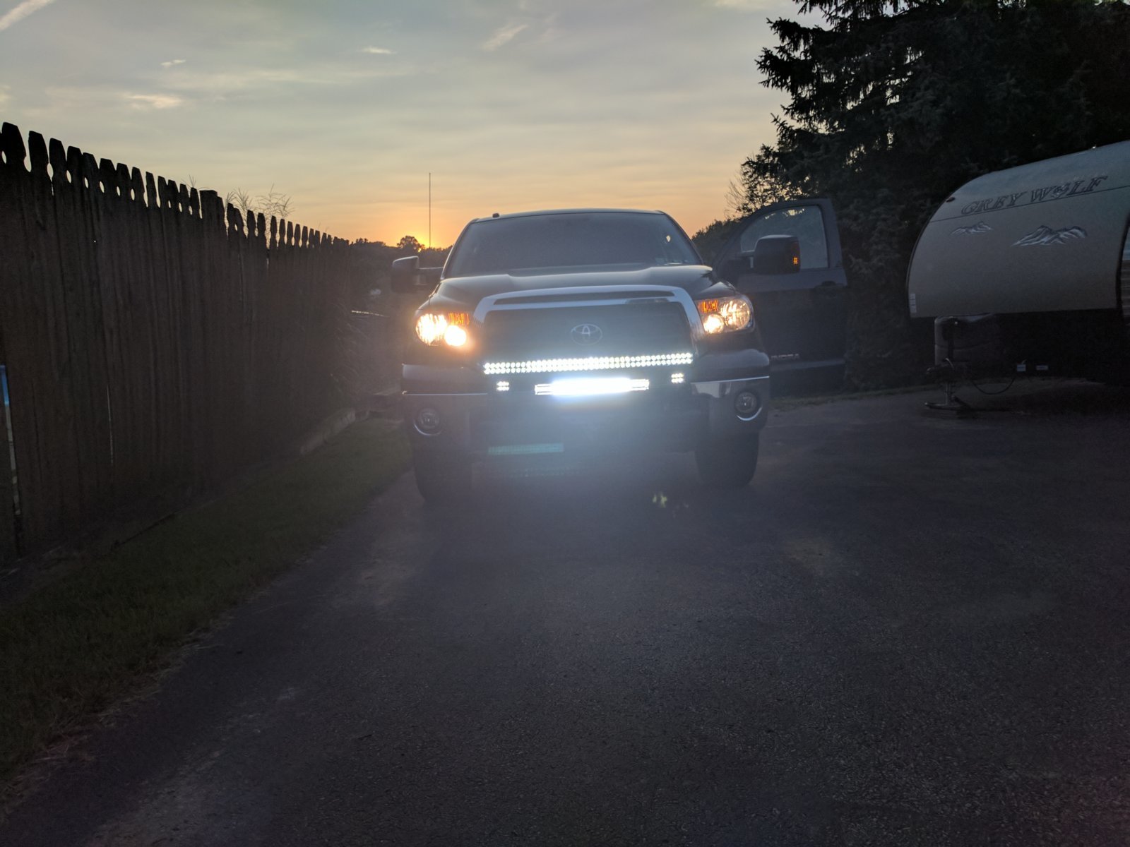

  4. Nov 26, 2023 at 5:09 PM

    Most of those pheasants headlamps are hazed over so they just drive around with the high beams on.:annoyed:
    I had this on my 2012 sr5.
