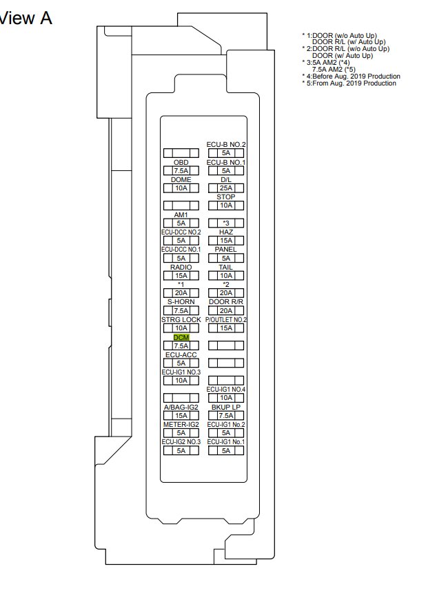

    I'll pull my radio tonight and take a look (have had that out before, but haven't removed the glovebox yet). Have you checked your fuses? There is one that powers the DCM, and reportedly will disable the mic if it's removed (or goes out).
  7. May 22, 2024 at 11:25 AM
    Deniz24
    Deniz24 New Member
    May 4, 2024
    #116355
    6
    21 Tundra TRD Pro
    Do you know what that one is labeled? The one that powers the DCM? I have looked and nothing says DCM.

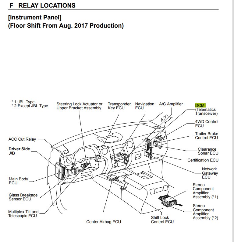

    I'm assuming you have a floor shift and not a column shift.
    It's pretty close to the same place on either.
    I'd recommend disconnecting the battery since you probably have to pull the airbag under the glove box to get the glove box out..
    Did you check the fuse?

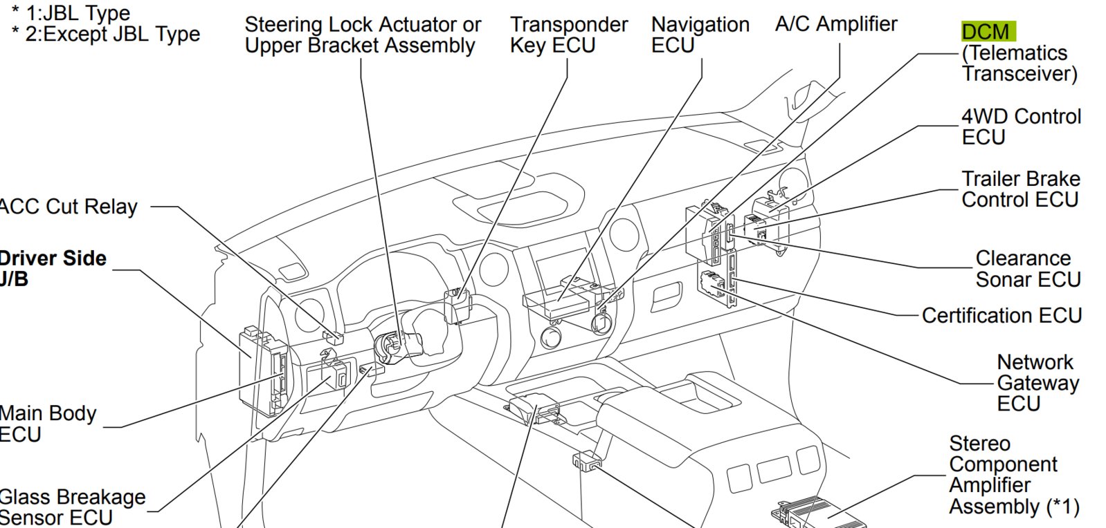

    I suspect you've located it lowlife. I just pulled my radio and I don't see anything that looks likely. There's not much behind it. To the left of the center speaker there is some kind of module, but I can't see it well enough to be sure. Your documentation definitely indicates behind the glovebox.
    I need to wait for another day to check the passenger dash. I want to leave the battery disconnected for an hour first to let the charge drain before fiddling with that airbag, and I need my truck later tonight.

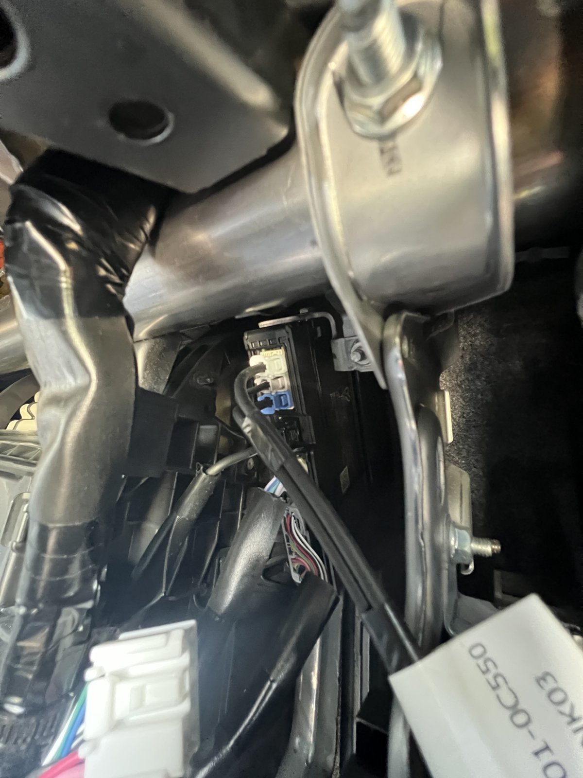

    It’s directly behind the glove box as shown above.
    ChesterTundra[OP] likes this.

    If you’re still in there, would you grab some pics? I haven’t opened mine up yet, and am wondering about the orientation and connectors.

    This is all I have. The DCM has the white, gray and blue antenna connectors at the top.

    @1lowlife, so the panel was labeled correctly.you were right it was there. So the fuse is good. Going to have to tear the dash apart and chase down a gremlin. Im assuming it’s the DCM connection on the passenger side. My remote start will not work and the DCM for emergency calls is gone along with Microphone. So from my research it has to be that final item. I’ll respond after I tear the dash apart. Thank you for the help yall!

    @ChesterTundra so I had my whole dash apart. Right as soon as you drop the glove box it’s there. In @Avi8or pic. Where the blue and grey antenna is there is a gray rectangle plug in module, that’s the DCM disconnect. That was my culprit.

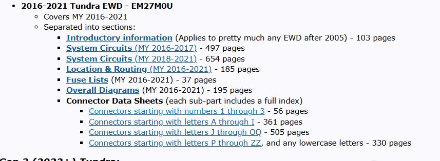

    I forgot to post the link to where I found that info.
    If you need anything else, you can find it here..
    Ultimate TUNDRA Wiring Diagrams Collection | Toyota Tundra Forum (tundras.com)
    Might be something else in here to find what you need.
    Connectors, locations, routing, etc.:thumbsup:
