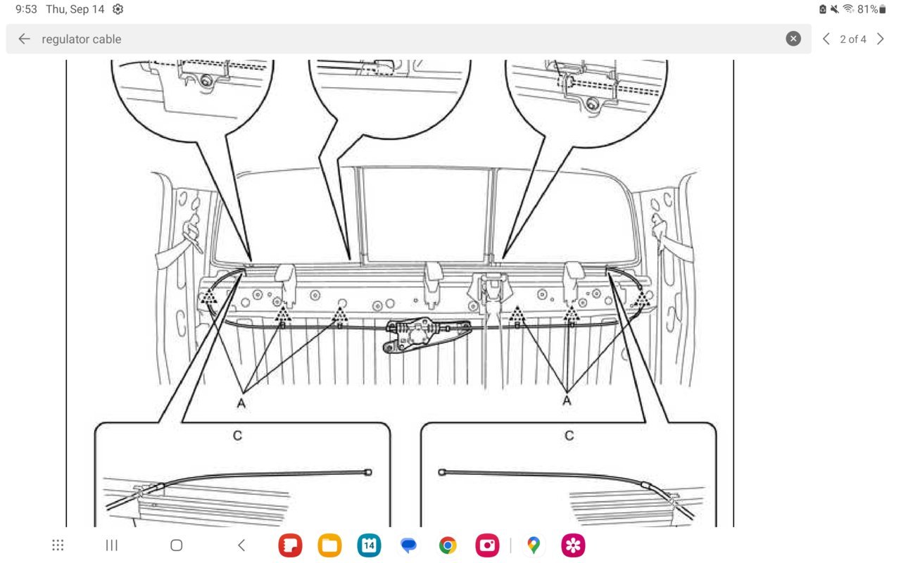

    I found a pdf of the 14-17 manual. This diagram shows where it goes, however there are no studs to mount the plate with the flange nuts. Is this where I would have to mount it myself using something like rivnuts and stainless bolts? Do these diagrams give a "to scale" on where it needs to be mounted? @CharlestonJoe how did you mount yours?
