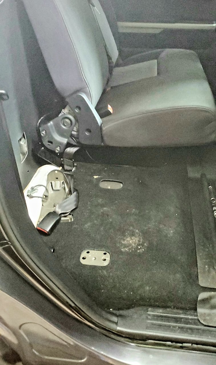

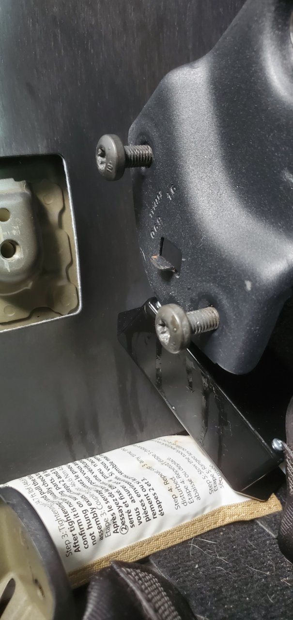

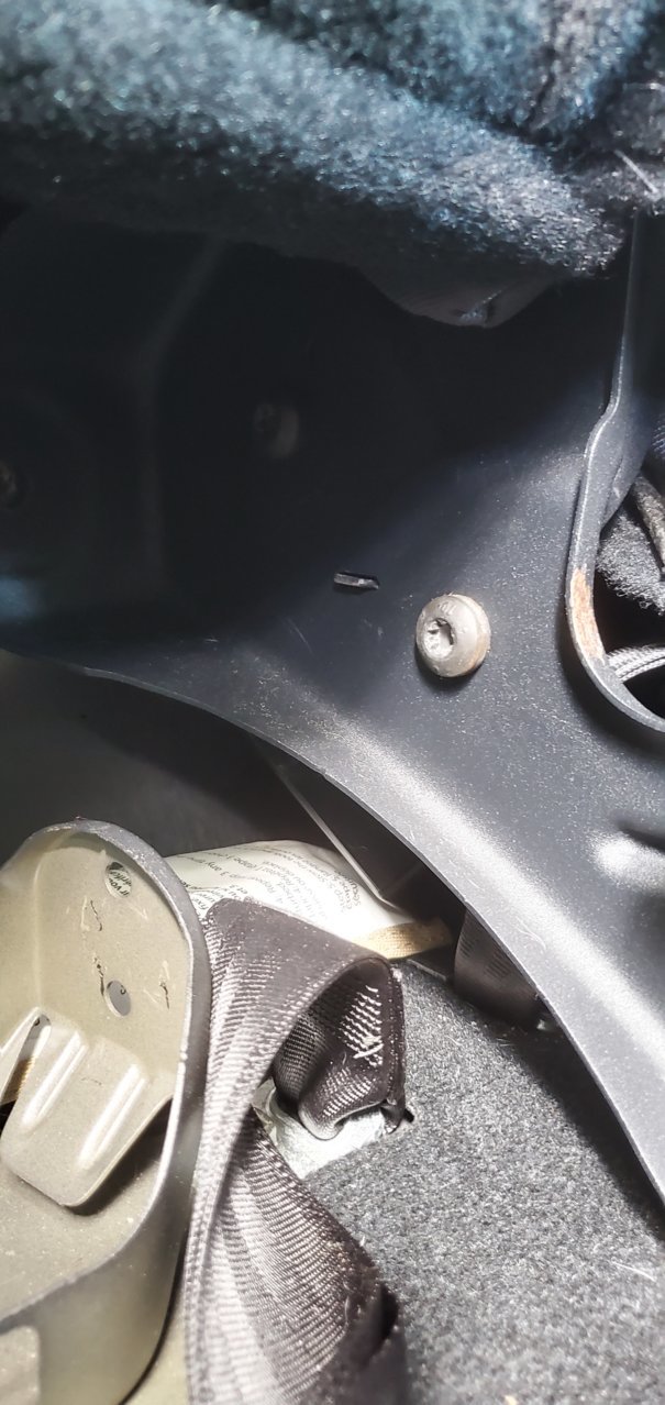

    Mine refuses to budge. Here are the Torx bolts I'm having trouble with

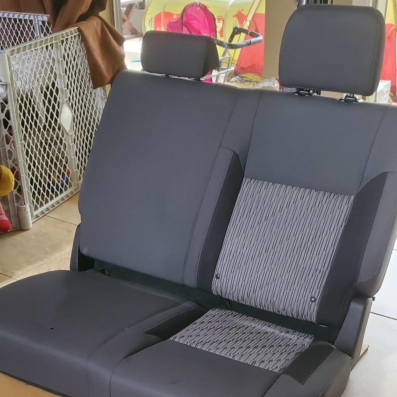

  15. Jul 28, 2020 at 8:50 PM
    texasrho83
    texasrho83 [OP] Old Member
    Mar 30, 2017
    #7025
    10,611
    Charles
    Conroe TX
    2016 DC MGM 4x4
    See build link

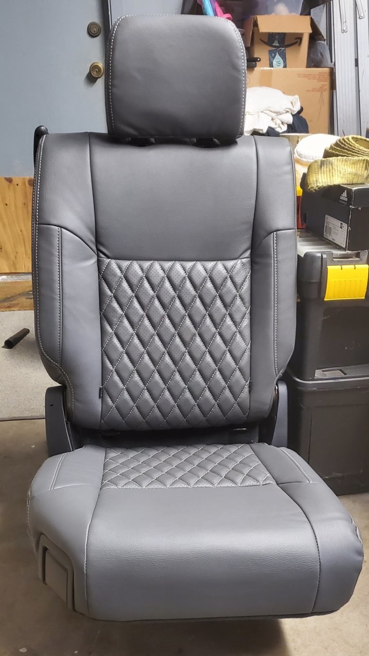

    One seat down...

    Are those Katzkins?

    I had to use a 3 foot breaker bar to get those bolts out. Good job.

    But the back corner will just be floating. I wouldn't put any passengers on it unless you made a bracket to the floor or cut up a donor single seat.

    They are tight and awkward to get to. I’m sure you’ll figure it out but I decided not to F around after first attempt didn’t work at all.

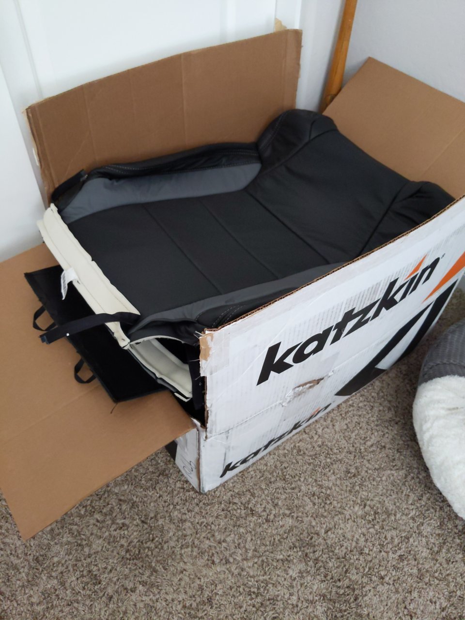

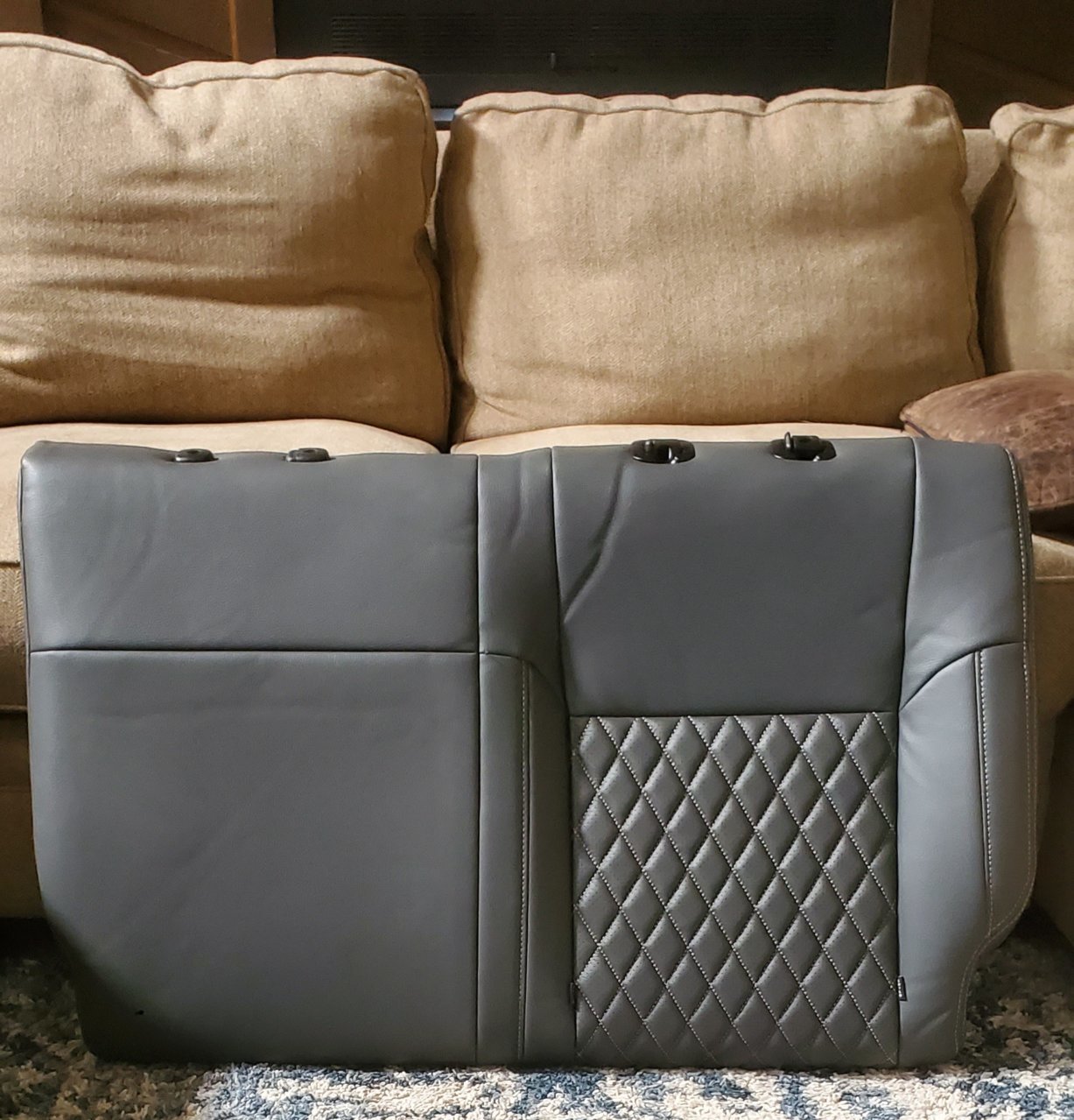

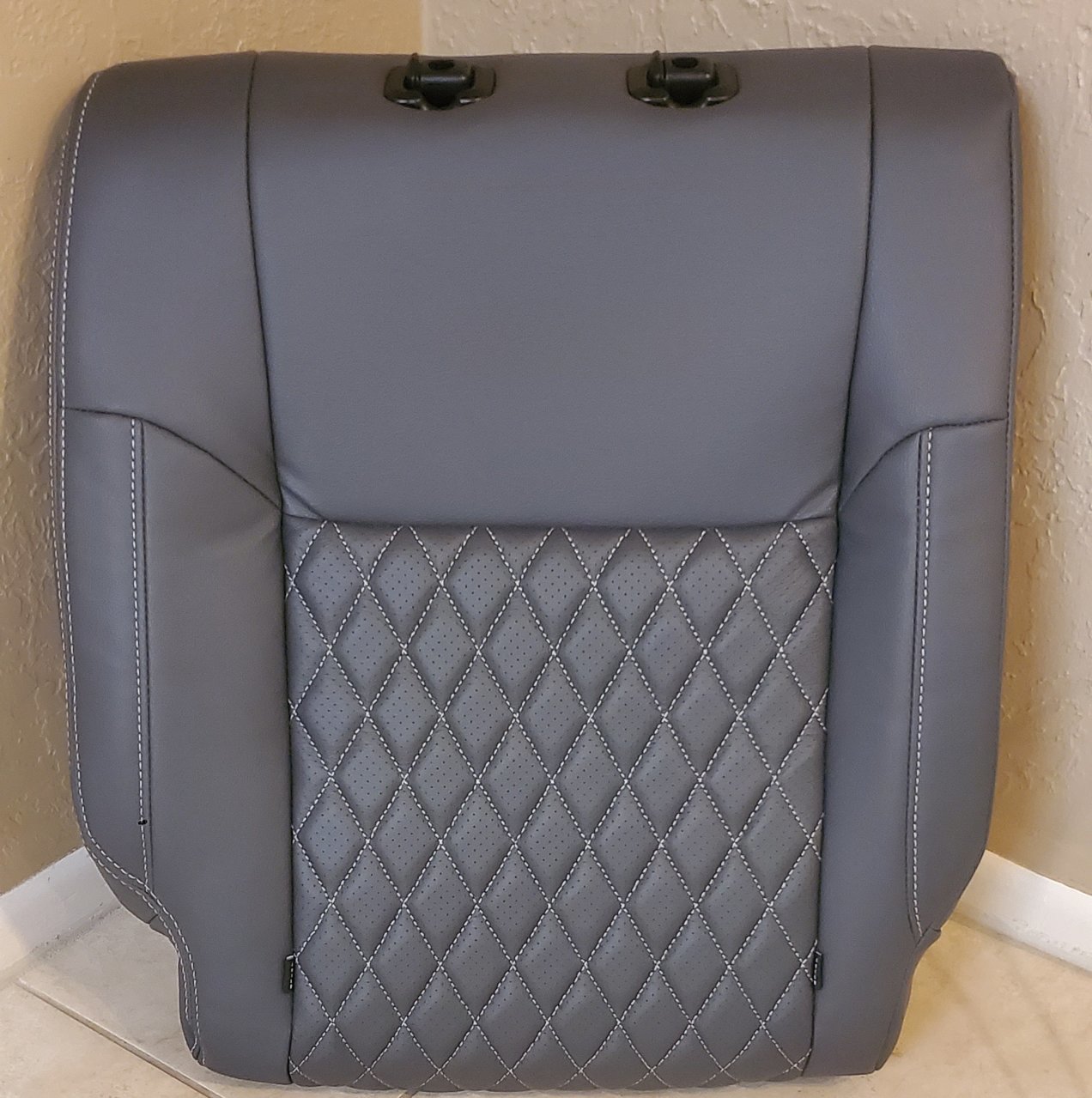

    You're gonna need a solid pair of rubber gripped needle nose and some grip strength. In addition I used another pair of regular pliers to help stretch the hog rings open but an additional pair of needle nose could be more help. The bottom portion was slightly more trouble as it has more sections of fabric to position when assembling back together so if you aren't good at remembering how things go back together take pics of what it looks like beforehand. It goes without saying that you should take the seats out before tackling the job lol
    NOTE: I have never done this before. If you have, then you may already know that the new covers do not have openings for the headrests or child seat anchor points. I slid the covers on completely before cutting the openings with a razor blade. Cut small and widen the hole only enough to make way for the plastic bezel to poke through. You can always cut more but you cannot put it back ;)

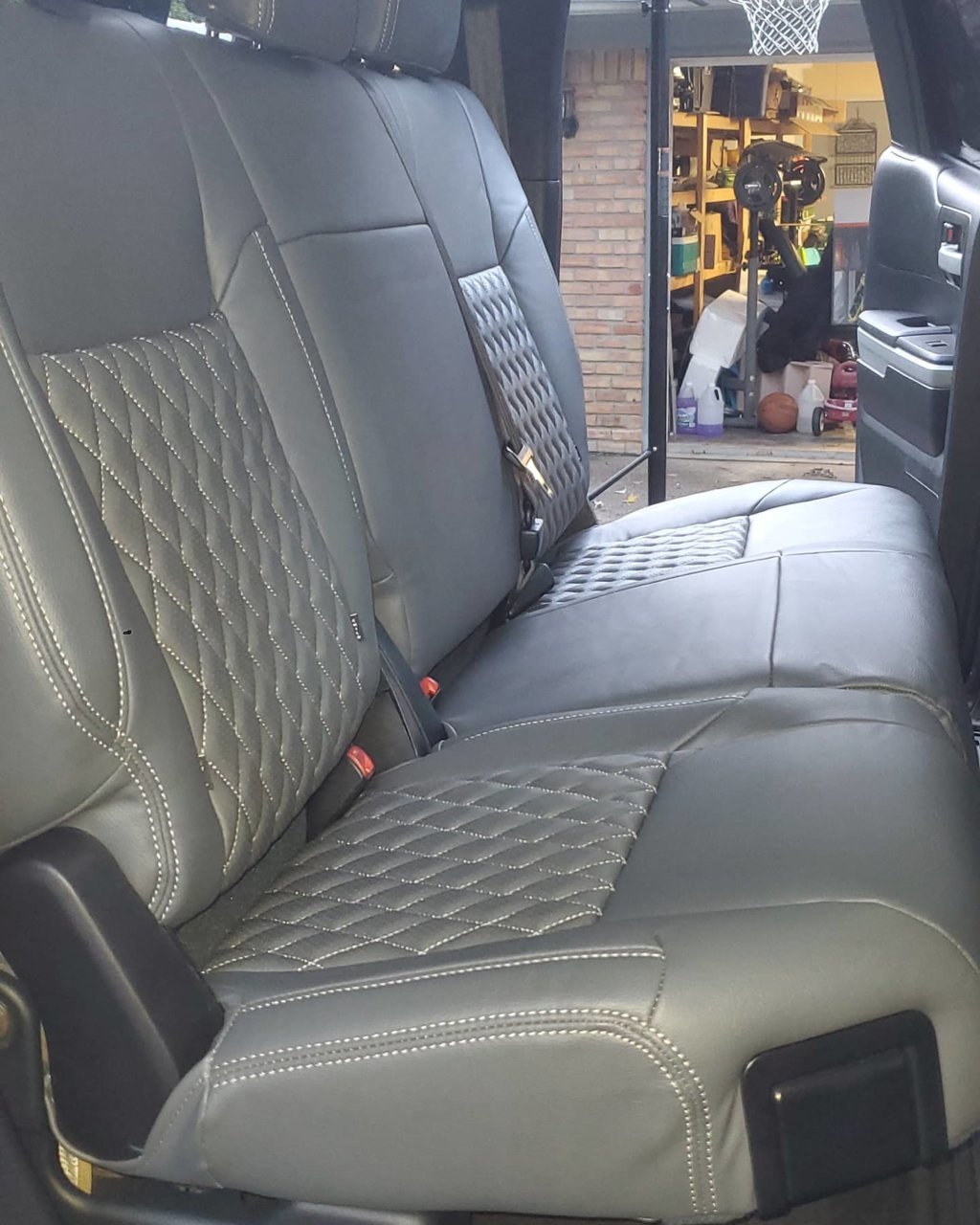

    Round 2

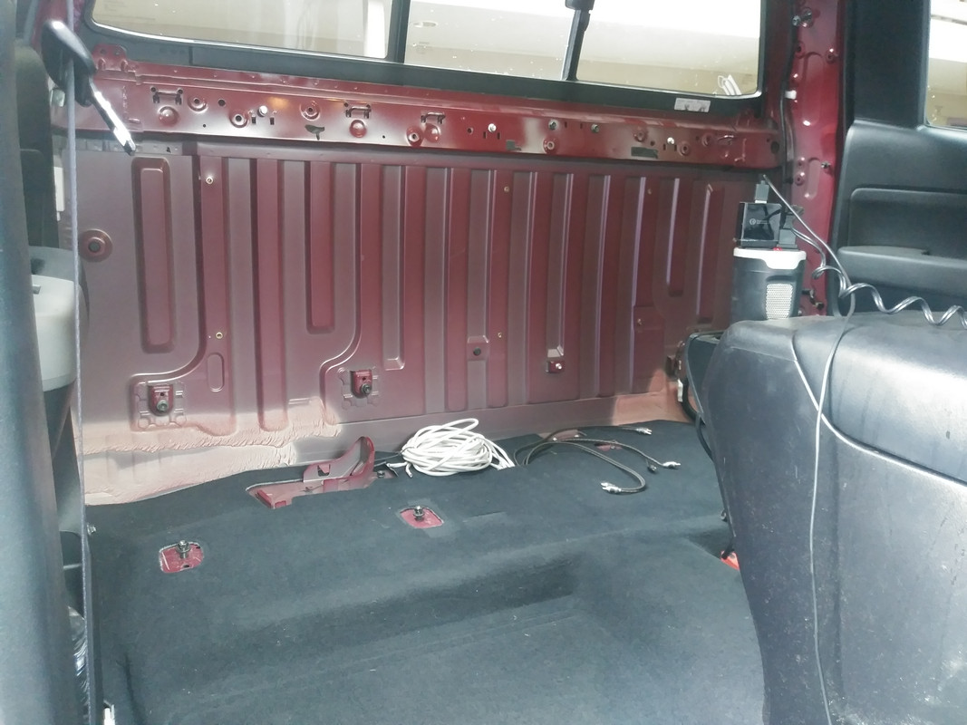

    I took out back seats a while ago. I m going to make a sleeping platform mod I can setup on passenger side of truck. I have to make a bracket to hold up the 66% part of back seat, and grind on the stops that stop passenger seat from folding down all the way. That way I can fold down passenger seat, and setup a platform over seat. I have passenger seat out now, and was going to leave it out, but my airbag lights is on, and actually, I think it s illegal the way it is now.
