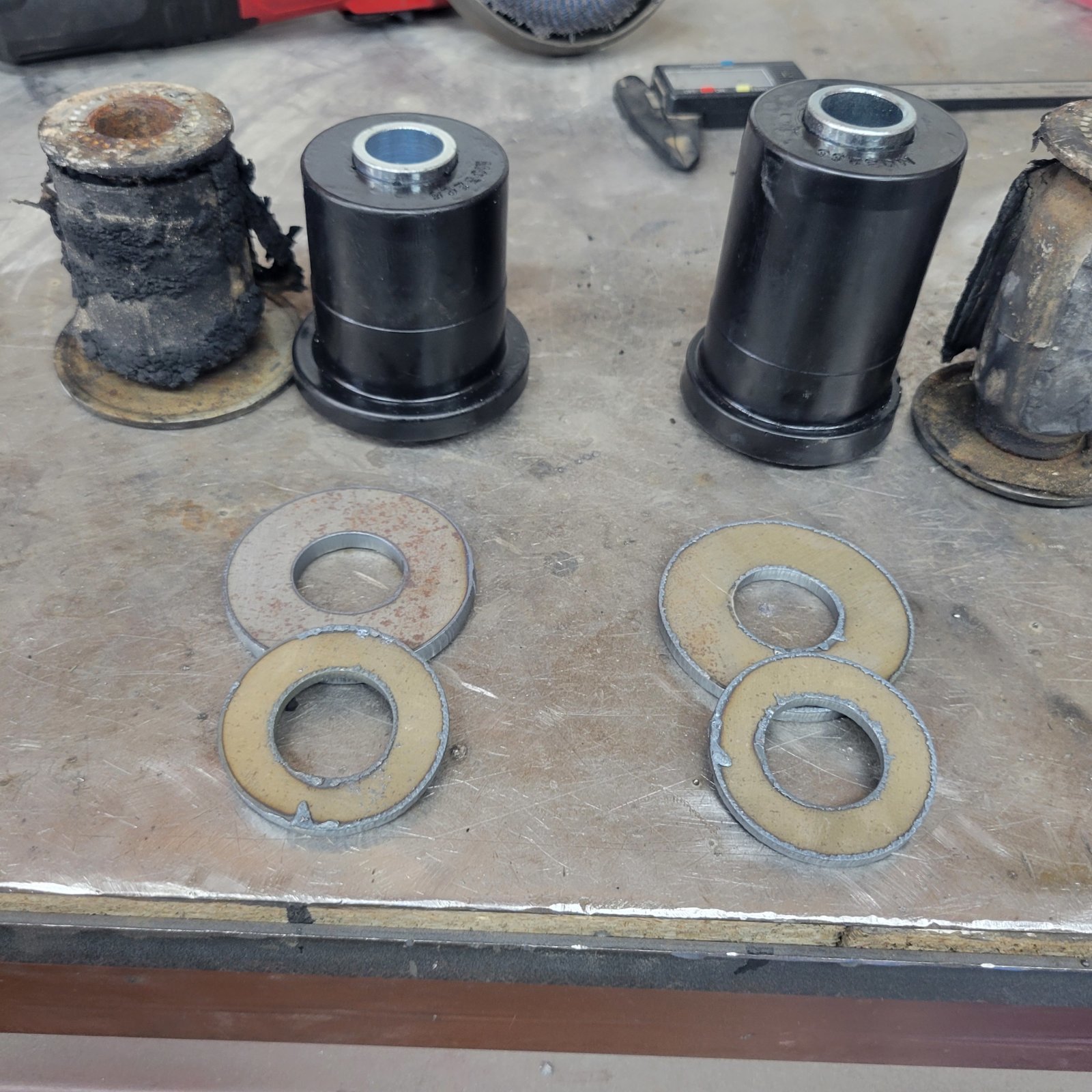

    The bushings and supplied hardware are of nice quality, but there is a glaring error with this kit.
    Specifically the LCA bushings.
    The OEM bushings have captive washers via a press fit. I know what you are thinking, "Ill just scavenge the old washers and use them".
    Well not exactly.
    The supplied Daystar sleeves have a larger O/D than OEM, and they measure the the exact width of the OEM bushing+washer combo.
    So even if the old washers fit (they don't) the overall width of the bushing/washer assembly would be wider by the thickness of the washer on each side.
    The captive washer is an important design feature. Without it you would be relying on the surface area of the end of the sleeve to provide clamping pressure to hold the alignment. Whereas with the captive washer you have greatly increased surface area.
    TLDR: If you don't want to fix these issues with your install stop here. Buy OEM or Siberian or something that's not fundamentally broken.

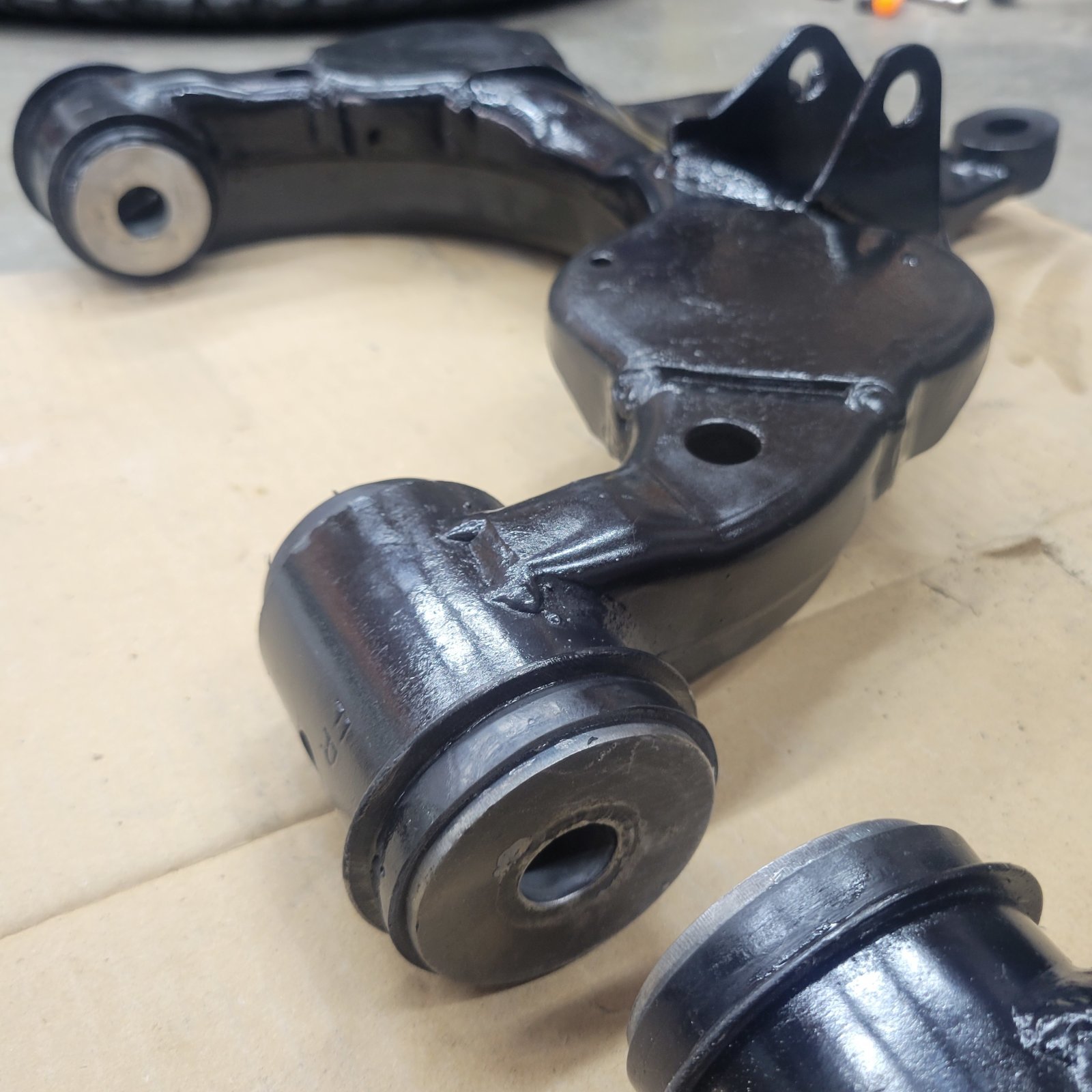

    The fix
    Plasma cut some washers out of 3/16 material.
    Cleanup and grind to correct thickness. I needed each washer to be .15 for a total of .30
    "bUt JaKejAkE tHeY'rE nOt cApTiVe"
    I did weld on the other side before installing the assembly into the control arms. Goofed on the pictures. 1/32 tungsten at 100ish amps. Hot and Fast. Weld 2-3 dabs and dunk in a cup of water. No bushings were harmed in this silly endeavor.
    Ready to install

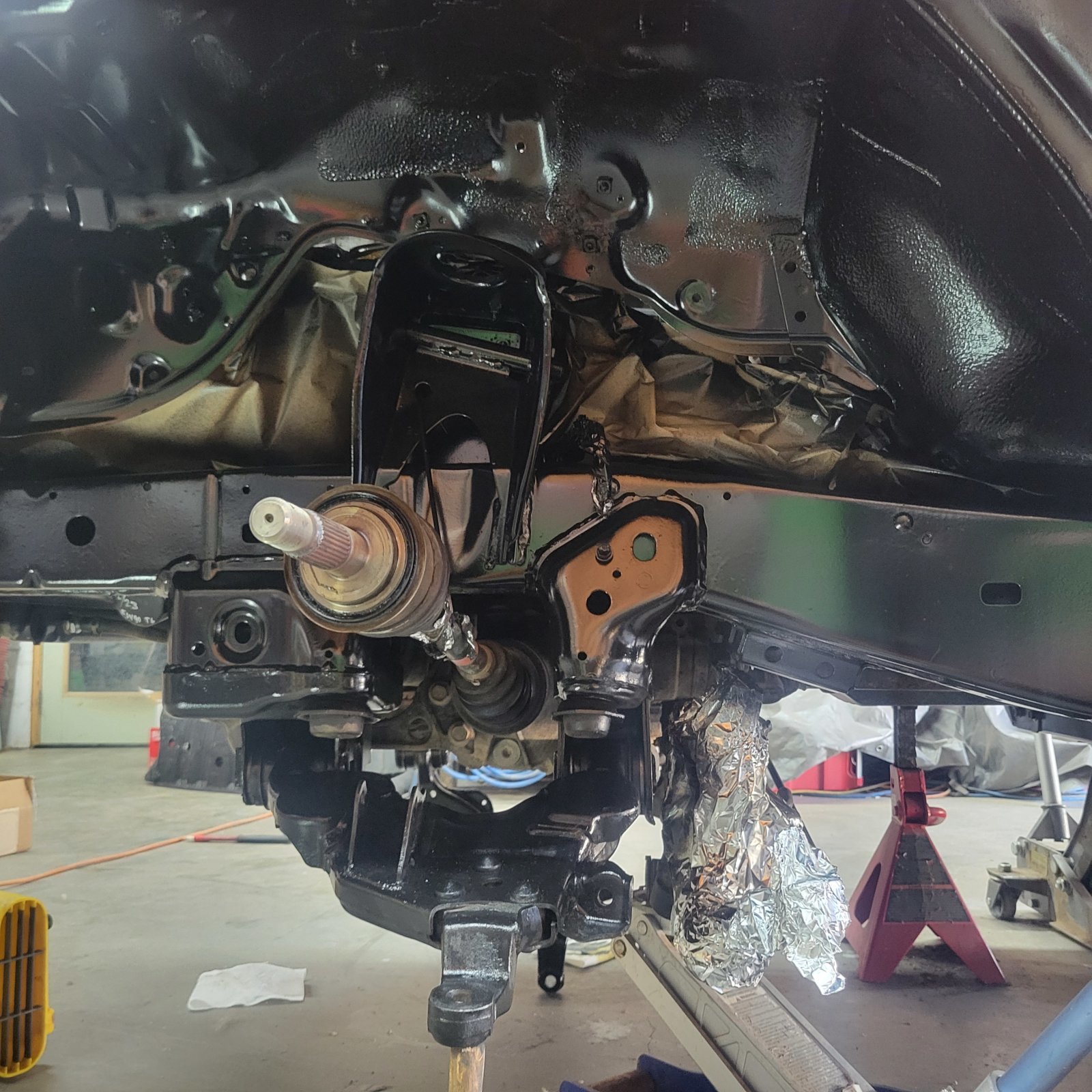

    In place.
