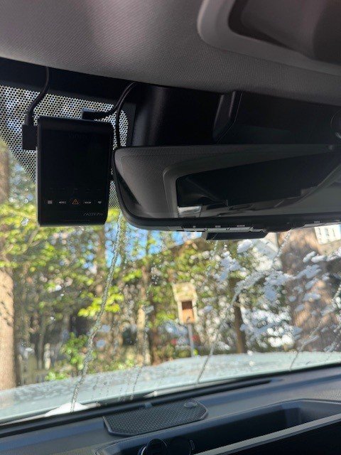

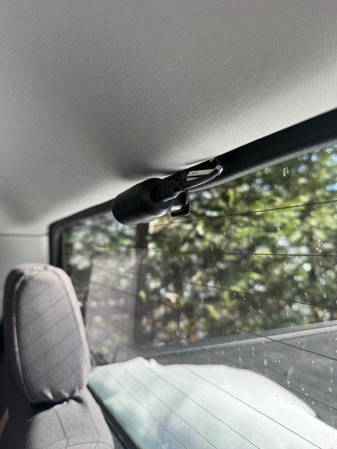

    I went with the Viofo A229 Pro - 3Channel. The install is pretty easy with the Gen3 Tundra, the headliner and pillars were easy to work with for a clean wiring install. I did purchase the extended tailgate wiring harness in case I ever install a bed rack and want to move the rear camera to the bed-rack.
    Here are some pictures of the install. Note: for the rear window I recommend from "The Dashcam Store" - this rear window headliner bracket, so you don't have to mount the rear camera to the rear-window and won't interfere with power window going up/down.
    Order this part # - DCS-WSC-SHORT-BLK , from TheDaschCamStore.com
