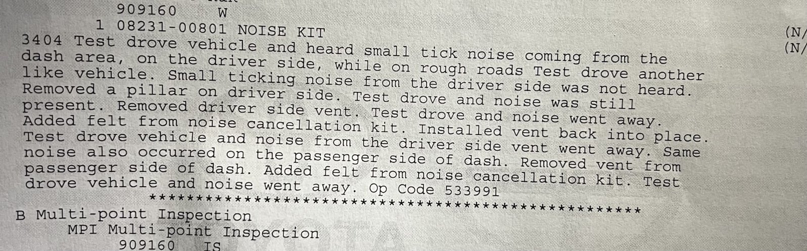

    I have a 24 trd sport Tundra with 3,500 miles on it. I have a ticking noise that is on the driver side some where that I can’t. Just picked it up from sparks Toyota today. They said they fixed it and as soon as I pulled off the fresh pavement in front the dealership it started back. I didn’t have time to turn around. Anybody had any problems like this? It’s not really loud just so annoying I don’t even like driving the truck anymore.

    Said they put some felt around the vents on the driver side.

    My guess would be the felt came loose, then. If what they did solved it before it's not a leap to think it popped loose.
