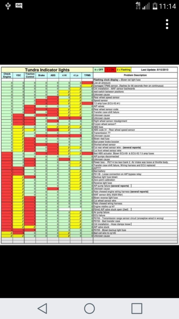

  16. Sep 7, 2025 at 10:55 AM
    blaserdude
    blaserdude [OP] New Member
    Feb 16, 2019
    #26168
    150
    Eugene
    2019 Tundra Limited Double Cab
    none
    The problem seems to be common the Drive Start control error I am seeing. I am currently resetting the ECM by disconnecting the battery. More to follow.
    bc
