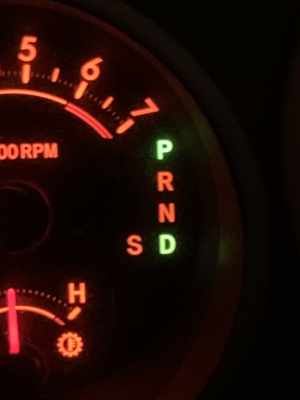

    3. While seeing if there was something to the dash lights and cruise control, I noticed that my D drive gear indicator light is off while in drive, but when I shift to park, both the P / park and D/ drive lights were both green for a second or two and then the D turns off.

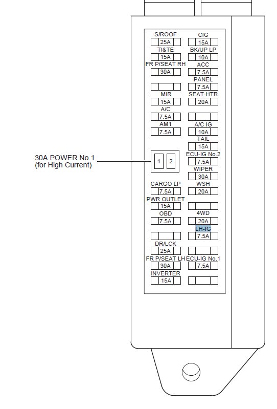

    Anytime you loose power checking all the fuses should be the first step. In this case especially the ones in the interior fuse box under the dash.

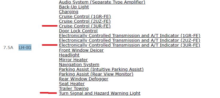

    I would definitely check the 7.5A LH-IG fuse as it powers the flasher relay/blinkers. Your other problems might also be tied to this fuse as well.
    Here is the location in the interior fuse box.
