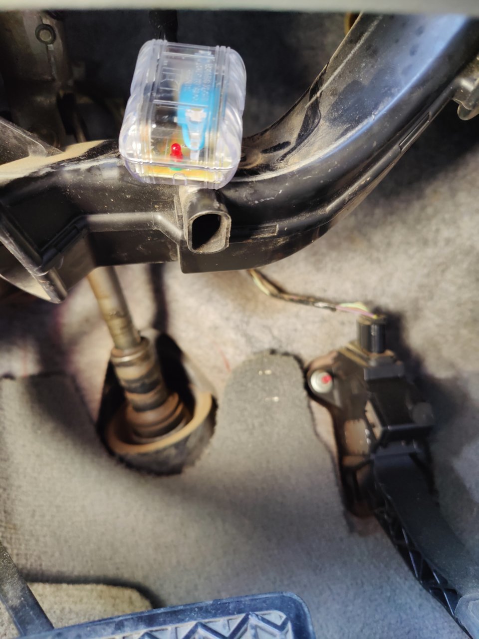

    Only one OBD II port. However I did find a small module with a flashing red light. I'm not sure what this is for. Picture below.
    Update. The module is a Viper alarm motion sensor. The installer said it would not affect the ECU. Your thoughts?

    That is the shock sensor, it has zero effects on the ecu,
    trace the obd2 port to verify it is not a t harness on it. Or verify the alarm installer did not tap into the wiring on it that possibly damaged the wires.
