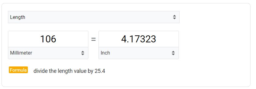

    I have always liked to run the basic steel wheels on my trucks .. I was about to pick up a set from Jegs but have a doubt about the center bore.. They are listed as 4.25" center bore.. would this fit the first gen Tundra?

    106mm, I've seen some list as 106.1mm
    According to Google:

    These specific wheels would not fit a first gen Tundra since they are five lug wheels.
    4.25" is about 108mm, many aftermarket wheels use this too. You want a lug-centric wheel with a 6x139.7mm lug pattern.
