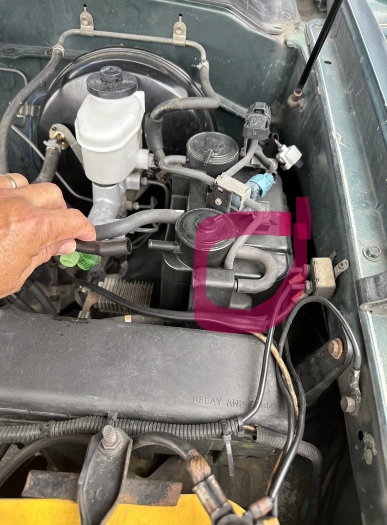

    I was driving to work this morning and out of nowhere the truck started to shake and run like hell. I pulled into auto zone and they scanned it. Pulled the p0305, p0446,p0441 codes and sold me some new platinum plugs to install (definitely needed them). After putting the new plugs in still misfiring (I don’t own my own OBD II yet).
    Looking at the engine bay evap canister and hoses everything looks fine except the small one that loops. Could that lead to the misfire? I’m wondering if it’s a fuel rail or injector thing because the misfire is only one cylinder?

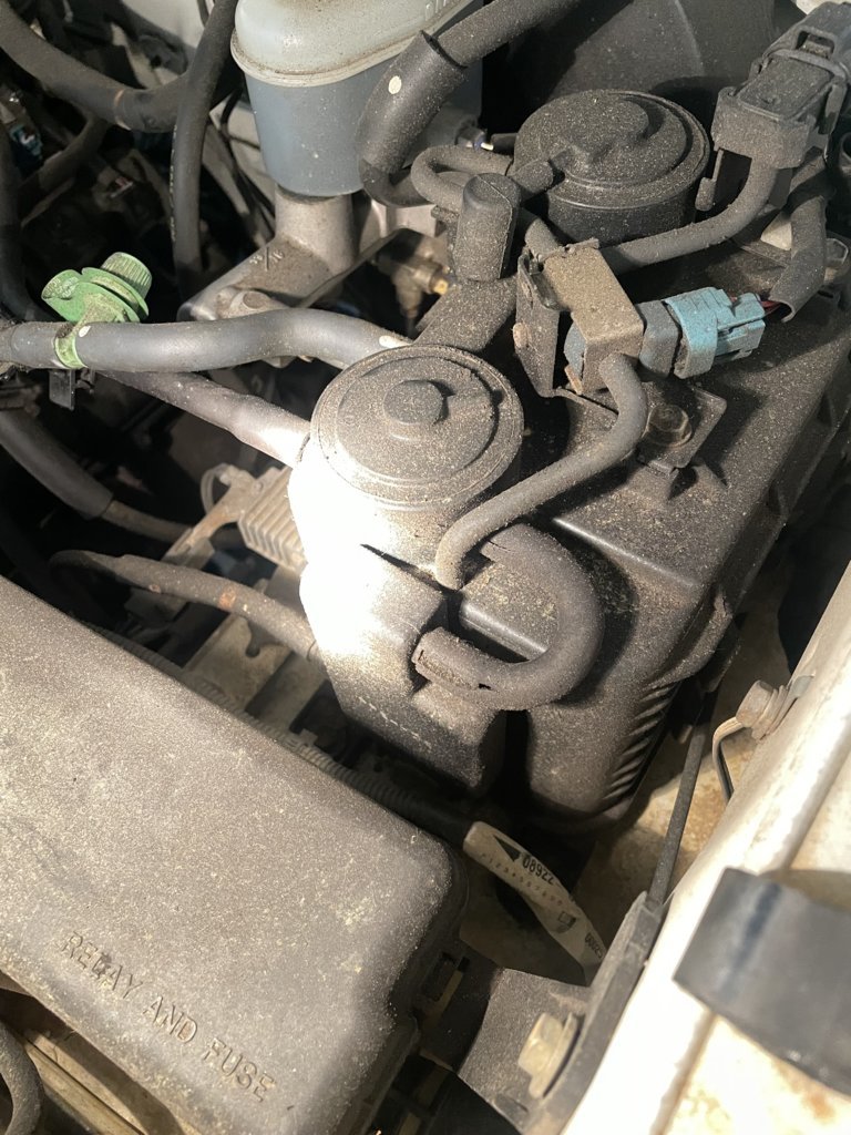

    P0441,P0446 are like related to your split evap hose.

    Agree with this. Cylinder 5 is on the driver side, the 3rd cylinder from the front of the truck. I recommend swapping the #5 coil pack with the #7 coil pack (cylinder closest to firewall on driver side), and see if the code changes to P0307. The last digit of the code is the impacted cylinder for P0301-P0308 for the V8. But you need to fix that hose also. And Toyota doesn't make it anymore, but someone on here recently showed a pretty cool substitute. I think it was @bfunke
