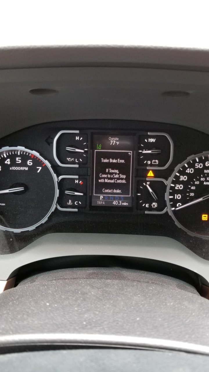

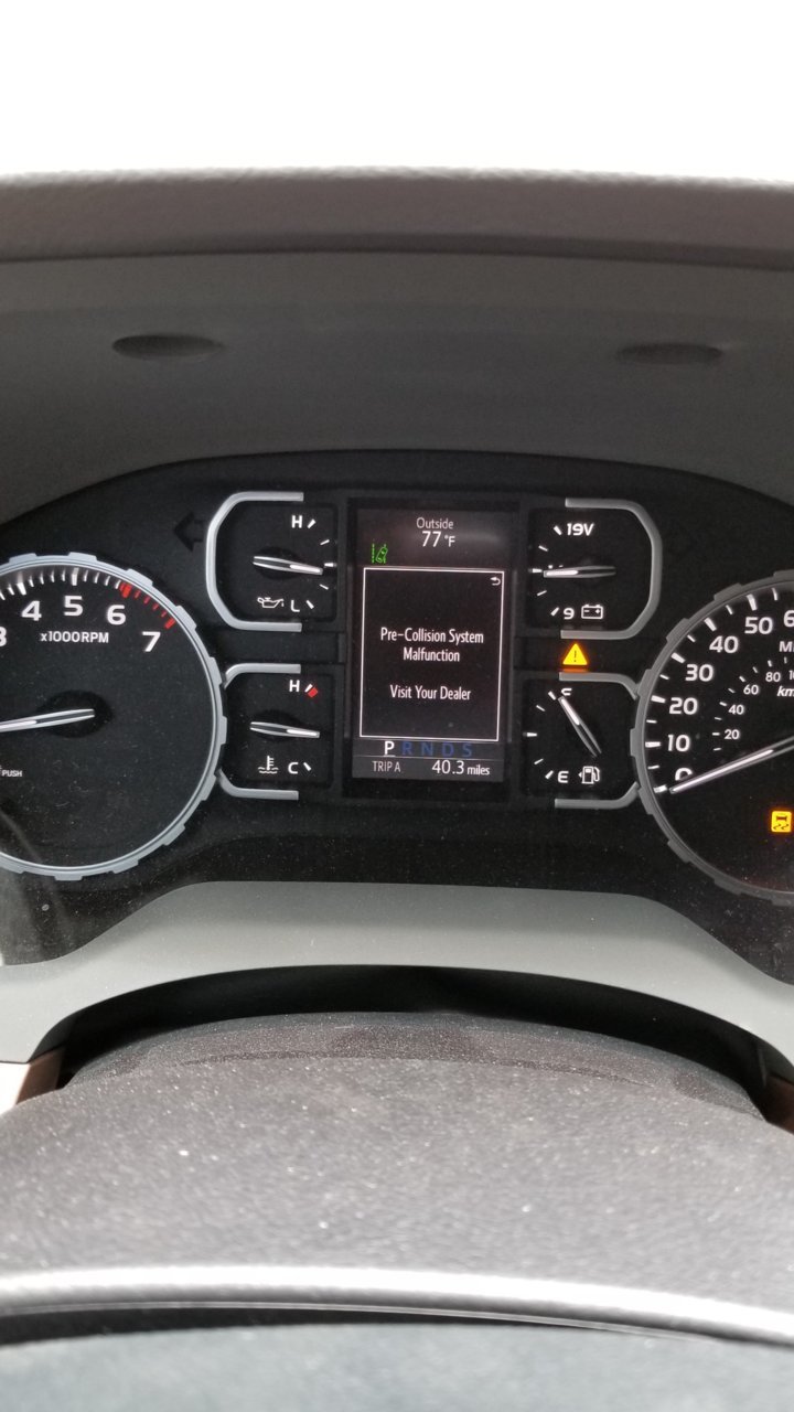

    I got a 2018 Tundra with a little over 1100 miles on it. Yesterday I was driving and it started giving off all sorts of warnings. I immediately took it to the dealer as I didn't want anything damaging my new truck.
    Warnings I got;
    Pre-Collision system malfunction.
    Trailer Brake error warning as well.
    I got it back from the shop today and they said it "had water ignition coil cylinder #5 had water in it causing a misfire". This seemed pretty unusual as I haven't been off roading and haven't been running a power washer on the inside of my motor. Has anyone had this sort of issue? Hopefully I won't be back to the dealer except for the scheduled services.

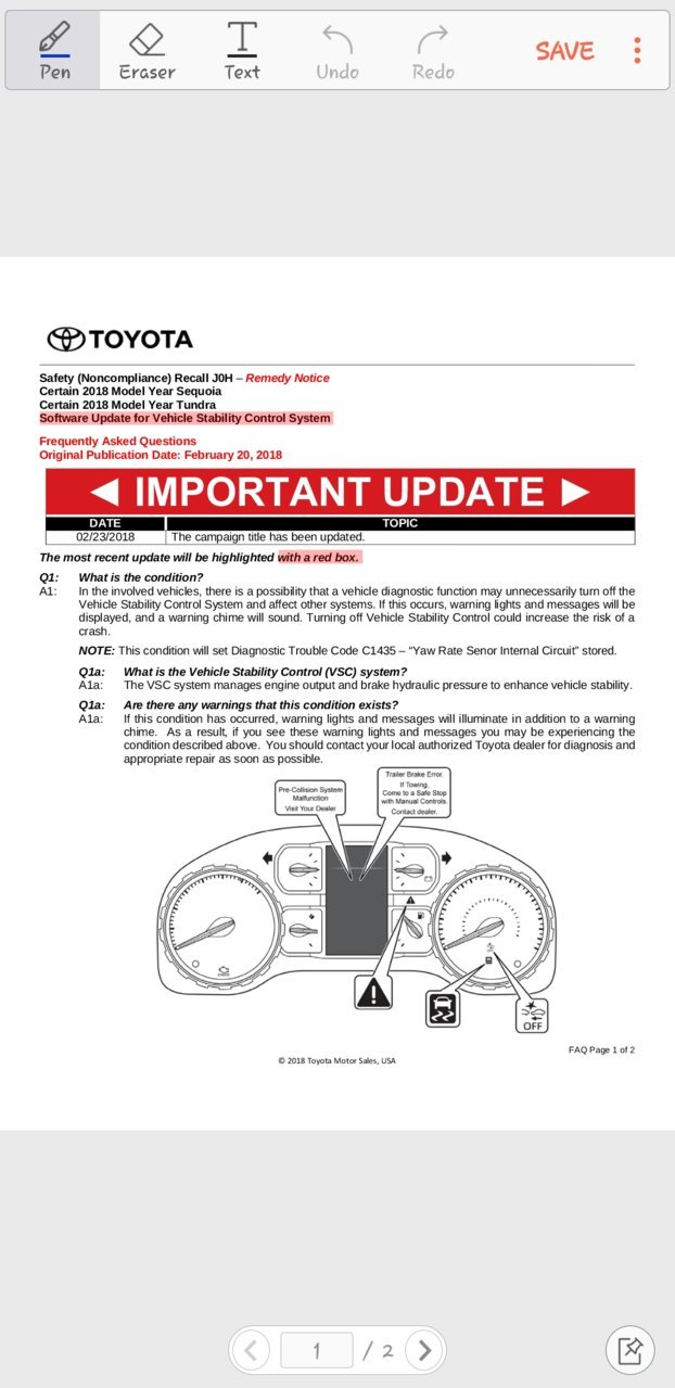

    Did they do software update?

    Just had mine fixed. My whole TSS harness and PC sensor was replaced and recalibrated. Tech said the new harness and sensor are redone by Toyota to prevent this. Obviously they know this is an issue. But I didn’t get the trailer brake warning. Everything safety wise disappeared from my truck lane departure, cross traffic ant etc.

    I would verify with dealer the warnings are fixed by updating software.
