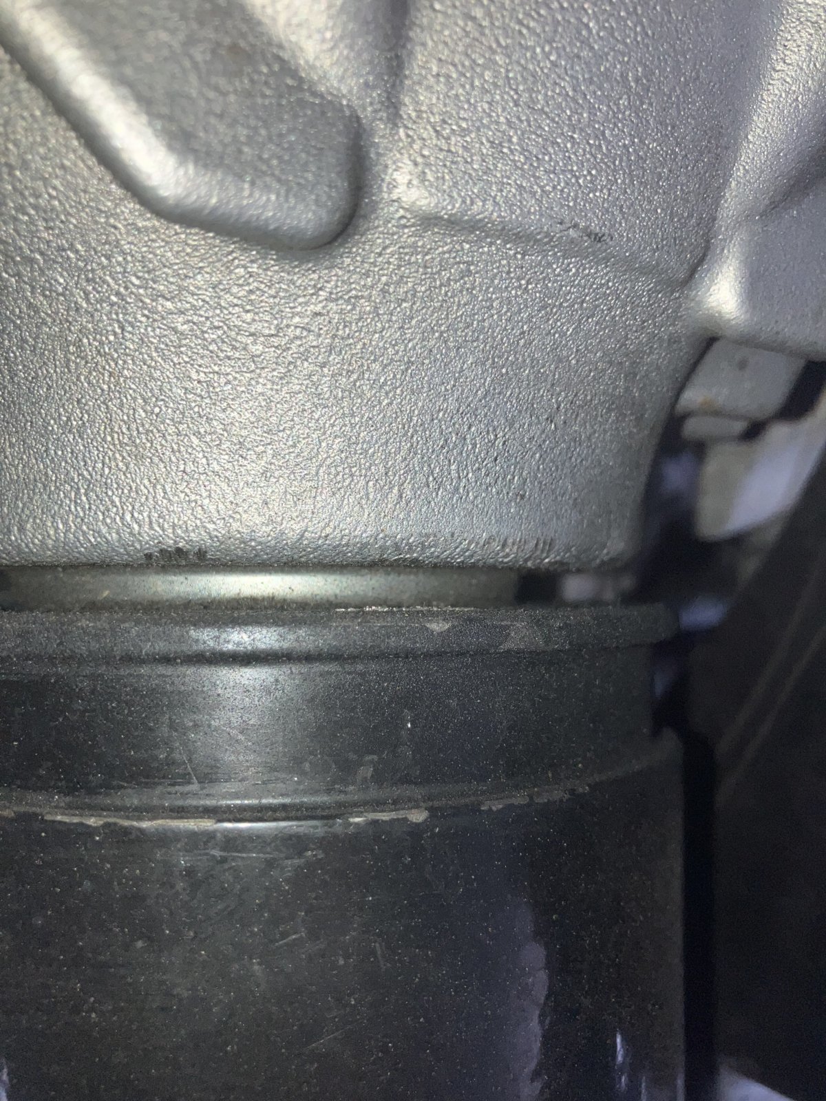

    Hello. I really appreciate your response to my thread. I went on and replaced the seal and the bushing to ecgs since there was a significant amount of play on my driver side cv axle and it eliminated the vibration/shaking on my steering wheel when running around 50mph up. I’m just not quite sure if my CV axle is seated properly. Can someone please confirm if this is okay?

    Doesn't look to me like it's seated properly. Getting that snap ring to pop in place is a bugger. The way you know for sure is, when installing, once seated it won't come back out easily. Also, the gap between the axle and diff looks to be unequal and too large IMO.

    Geez! I hammered it several times and I stopped when it felt solid. I just don’t want to mess with the gears inside. I tried to pull it back but it’s fixed. I’m just worried about the gap that it shows a little bit of shiny metal. I have a favor from you to snap a photo on yours, only when you can of course, so I can atleast compare. Thanks in advance.

    It is hard to tell on your last picture due to the lighting, but something doesn't really look right. I struggled getting the CV back in on mine at first. Someone told me to tap it in and if it doesn't go in easy, rotate a bit and try again. I ended up using a relatively large pry bar and tapped the lip of the CV to get it to snap in. Once it snapped in, there was no way it was coming out, without influence that is. The face of the CV should look parallel to the face of the diff housing. I can take a photo of mine and post it for you.

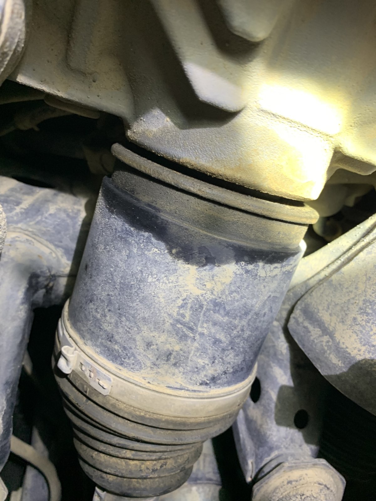

    The metallic part is the CV dust shield. The lip is close to flush with the diff housing.

    This is a huge help. Thank you so much for the pic. Now I wonder if this has something to do with the ECGS bushing because I saw this post from another fellow Tundra owner who replaced his spline bushing with ECGS and have the same gap as mine. The only thing that differs is our dust shield. Mine is flushed and his is not.

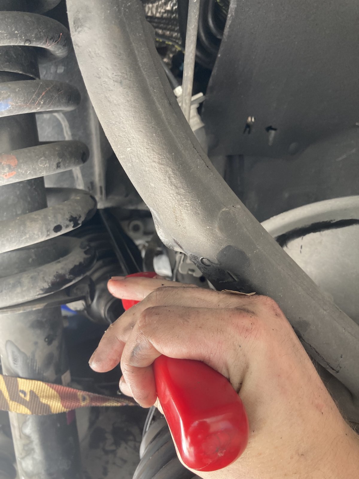

    It looks like the dust yield is separated from the cv axle and preventing it from going in. Maybe a better picture? Super easy to unseat it partially while removing the axle if a pry bar is used, it is a press fit on the cv axle.

    You are dead on! I’m planning to redo everything this weekend. Just wondering if I can jack the driver side up hammer the sh*t out of it without disconnecting the tie rods, wheels and whatnot.

    I installed the ECGS bushing on my 2020. Had the harmonic growl and vibrations, it completely resolved mine. Access to the diff was difficult, so I used a cheater bar on the ECGS driving tool to drive in the bushing and then for the CV, a long pry bar with a rag on the end of the lip of the CV to seat it.

    Yea, it barely takes anything to screw up the dust shield. I pulled my CV out with a slide hammer to prevent damage to it and when it popped out, it slid out of my makeshift harness and dented the dust shield lip.
    I pushed it back as flush as I could get it. Not perfect but should keep the dirt and grime out.
