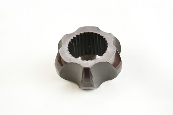

    Ive heard of a bird cage for rear axles, to convert from leafs to arms, but it doesnt work for a front axle? Also confused and interested.
    ok dug a little deeper he’s talking about the innards of the CV. I didnt find toyota stuff,
    but, cage:
    race:
    whats the mod? Polishing?

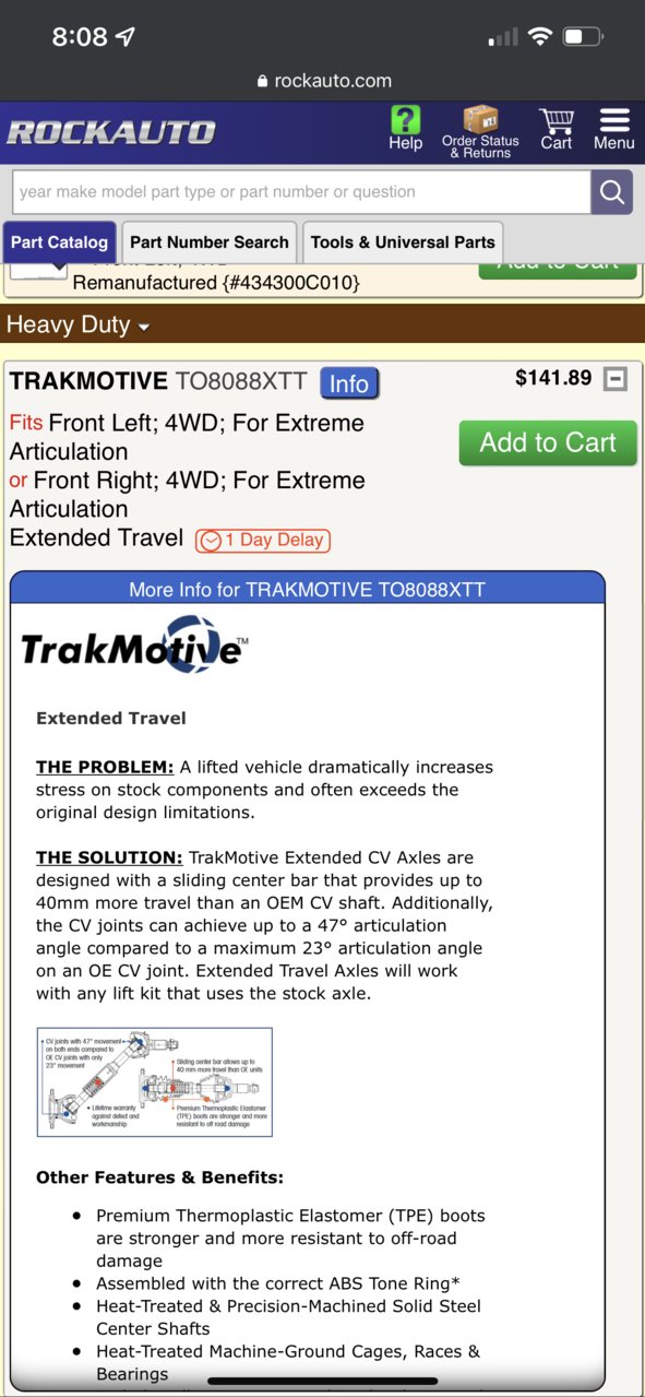

    We were talking about these in another CV thread and I called Trackmotive to see what the difference was in the extended travel and extreme travel. The guy told me they are the same thing but extreme travel is the new branding. The extended travel are branded FVP on RockAuto but have the same part number and look the same. They are only $125 per.
    https://www.rockauto.com/en/moreinfo.php?pk=13489621&cc=1431003&pt=2288&jsn=1595
