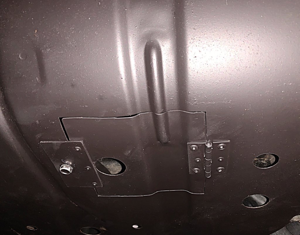

  4. May 8, 2025 at 10:21 AM
    WILLINH
    WILLINH New Member
    Jul 16, 2019
    #33280
    3,903
    BILL
    NEW HAMPTON, NH
    2019 TUNDRA
  5. May 8, 2025 at 10:28 AM
    shifty`
    shifty` In South Dakota Trouble ain't hard to find
    Jun 20, 2020
    #48239
    28,586
    ATL
    '06 AC Limited V8/4WD
    Now that right there is a winner.
    I prefer my Votex unit. Lower profile. Drains faster.
    HulkSmurf14 and robabeatle[OP] like this.

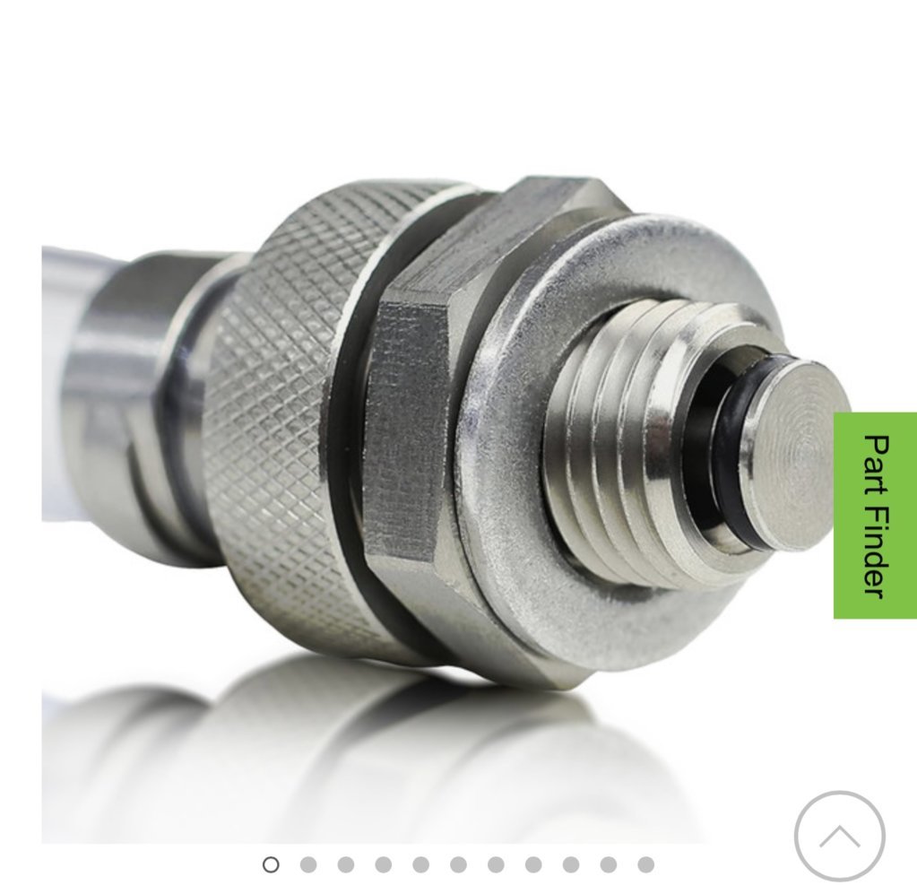

  12. May 8, 2025 at 12:39 PM
    robabeatle
    robabeatle [OP] New Member
    Jun 14, 2020
    #47947
    870
    AZ
    2002 Tundra 4x4 LTD AC
    Bilstein 6112 & 5160, Katskinz, audio upgrades
    Could you please send a link to that part?
    Sirfive likes this.
