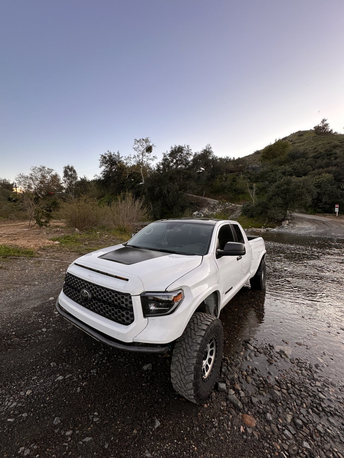

    hey all,
    having some driveshaft issues that came from having too much suspension travel, was wondering if there were any recommendations for a custom one piece or slip yolk 2 piece and possible locations in my area. I'm from SoCal (Anaheim). IMG_3102.jpg

    Do you have the carrier bearing drop kit? Also yes, plenty of slip yoke options for drive shafts. Double check your limit straps as well. JE reel driveshafts makes nice units.

    Sick truck. What kind of problems?

    simple carrier bearing issues, trucks a 2019 so I'm surprised to be running into these issues this fast. My buddy has a tacoma and his is "solid" so I was wondering if there was an option like that for the tundy

    gotcha. JW, that does seems fairly early unless you’ve been running a lift hard and fast for a while.
    I just put some leafs on my 2016 with 115k and instantly picked up a little bit of a come and go vibration. I installed a carrier bearing spacer next day and that immediately helped. My CB did feel a bit loose when checking before install so I think it just amplified that play.
