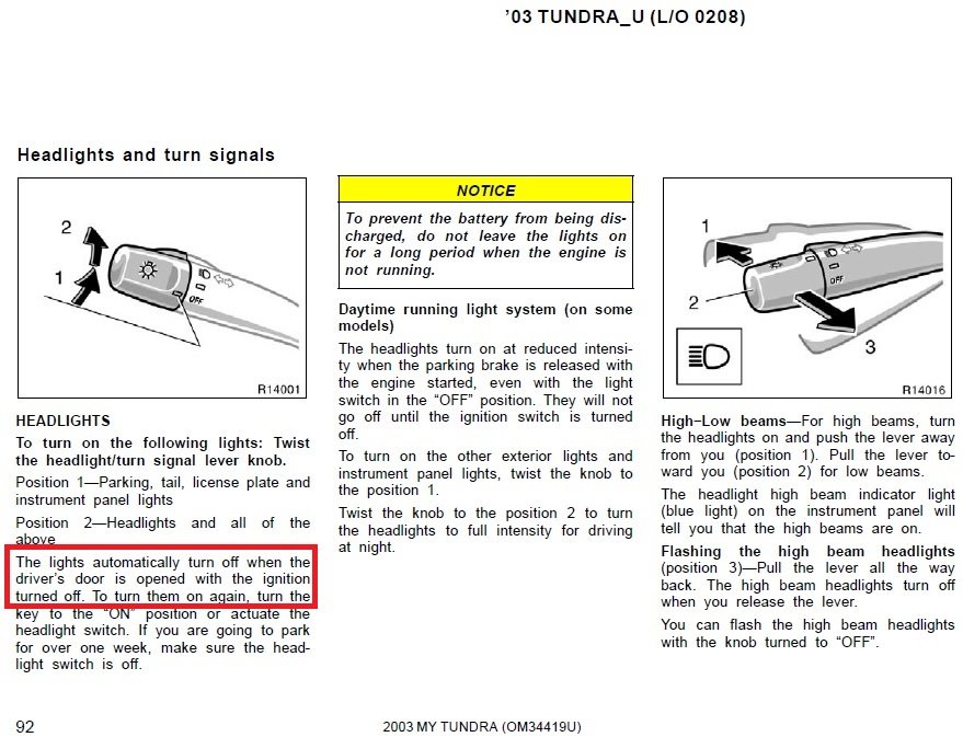

    In particular when driver door is open with IGN off, according to owners manual.
    Of course if aftermarket is installed, I suppose all bets are off !

    Edit: just tried out the headlights and they shut off like it describes. So it wasn't leaving the headlights on. But that passage also says not to leave the switch on for over a week. So, maybe has a little to do with it.
