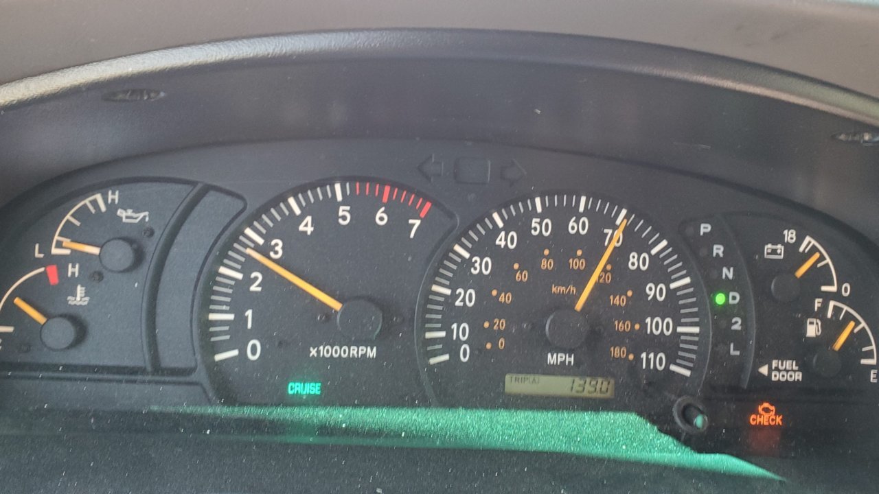

    I have a new to me 2002 tundra with 3.4 and 5 speed 2wd no lift tires are 265/75/16 I doubt the rear end has been swapped out but this truck does 65mph at 2500rpm and 70 at 2900 rpm just checking if this is normal ive been searching but seems like most have the v8.

    I think ive read v6’s had 4.30 rears and taco 5 speeds might have either .83 or .75 OD.

    3.4L came with either 4.1 or 4.3 gears depending on year/trans/etc.
    5 sp trans has a shorter 5th than the auto iirc (higher rpm on freeway if given the same rear gears).

    Slight add- 265/70/16 is the biggest stock size I know of on first gen. You are rolling slightly taller than that.
    For a V6 that doesn't sound like too high of RPM. Maybe @Tundra2 can tell us what his runs at, although it is auto.

    The manual transmission does change things. What exactly, I'm not sure of.
    My 3.4L, if memory serves will cruise at those speeds in the 2,000-2,200 ish. My memory might be off now that I'm dailying the corolla.
    Edit: on flat ground. Pulling hills will be higher as always.

    You have 4.10s and i have 3.90s? Cause im more 25@75?

    I would recommend checking the speedo against a GPS app or one of those signs that says what your speed is and pretends to take your picture. With the slight difference in tire size I bet the speedo is off for the OP.

    265/70R16 for clarity going forward. I'm still not 100% sure what gears it came with as I've read differing reports.

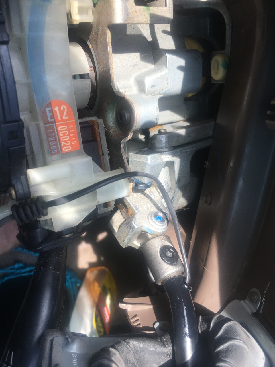

    Hello all, new member here. Yup a fellow first gen 3.4 v6 owner here as well. I’ve just recently done a job that requires bringing heavy equipment 4 hours away for a stair job out of town in the tundra. It already has a camper top on as well. After 70 miles per hour it was just running at high rpm’s especially on cruise control. I was afraid I might need to get a transmission rebuild which I’m actually really considering knowing that the A340E transmission before 2003 wasn’t up to par for the new weight of the truck. I’ve been told there are a lot of aftermarket fixes for these. But yeah I’m in the same boat. Definitely feels underpowered under a load for sure, especially at highway speeds.

    I wasn’t in OD. Which I was confused about…. It just simply may be from the previous owner hauling or something before I bought it. I’ve noticed it jerks between 2nd and 3rd gear sometimes even after making sure the fluid levels were at the right level. May be time to get it rebuilt. Anyone know what to get changed out? I know the gears needed to be changed at some point. 198,000 miles as of right now. The previous owner told me it was rebuilt but I’ve already done a ton of work on it that she said was previously done and either she was lieing or she had back yard hacks doing the work. Valve covers were missing bolts and some were only hand tight. I recently bought a 2002 Toyota 4 runner as well and it just feels way smoother.

    There is an issue with the OD button shorting out on these trucks, where the wire passes into the column via the shift lever.
    I'd be investigating that if you think it's stuck in OD. Link: https://www.tundras.com/threads/o-d-microswitch.126827/#post-3239233

    That’s a super easy fix.

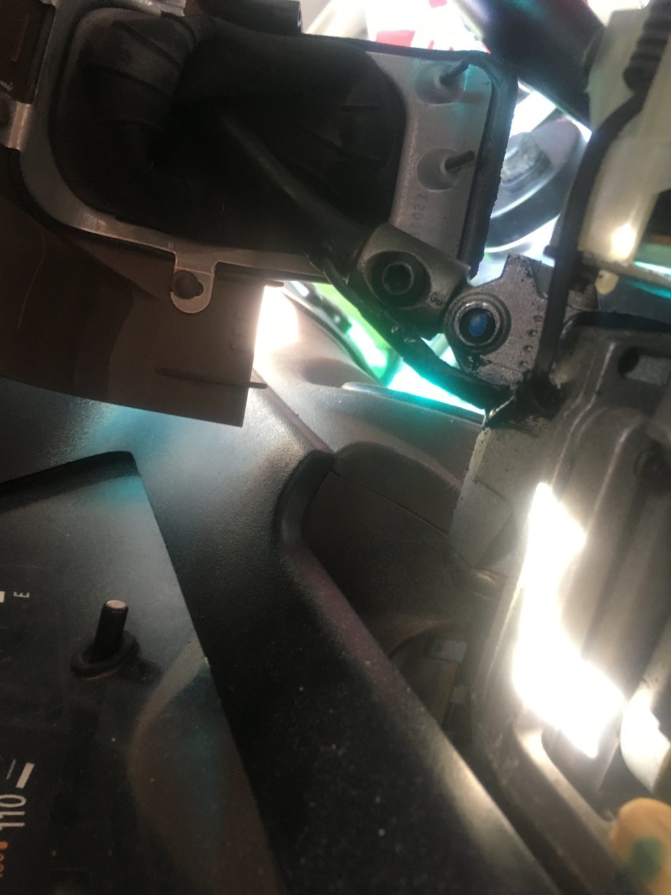

    Yep already appears to have been addressed

    Looks really good no wear and tear
