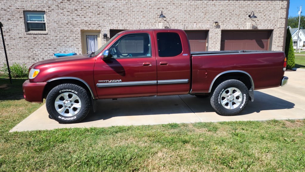

  13. Aug 29, 2025 at 6:31 PM
    Kalannar97
    Kalannar97 New Member
    Feb 13, 2024
    #111912
    228
    Michael
    Hillsboro, TN
    2003 Red Tundra SR5 2wd AC V-8 LSD ABS
    New Frame (Recall in 2019), added 17" 4-Runner Snowflake Rims
    This is the correct size for these. It's what I have. Same offset as our stock 16" 16x7 Starfish just an inch bigger diameter.
    These are 7.5" wide with same offset.
