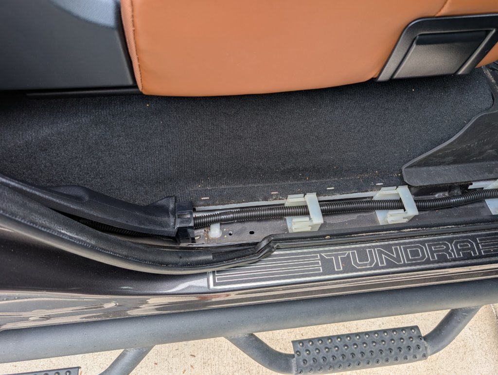

    After a few hard rains I've noticed the rear passenger floorboard is wet around where the step in plate is. Can't seem to track it down. Any ideas?

    Rear window.

    Third brake light gasket?

    Do you have a sunroof? Are the gutters around it retaining water (one or more clogged drains).

    I've looked at all 3 above. How do I find out specifically if it's the 3rd break light (seal looks a little weathered tbh), rear window or sunroof?

    Dry it out then perform a water test with a hose. Start with the rear window, check the area. Then do the third brake light, check the area. Lastly do the sunroof.
