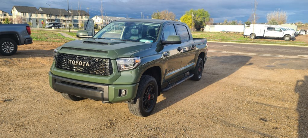

    Finally souced and picked up a 2020 Army Green TRD PRO a few weeks ago and am in absolute heaven. Bone stock, two owners, non rust belt traveled and 50k miles. Definitely garaged for most of its short life. I've had two Sierra's and didnt really get this noise with those trucks.
    Not REALLY an issue... but when driving in a parking garage or backing out of the garage down the driveway there are fairly audible clicks and creaking noises coming from underneath the truck. Generally makes noise whenever theres some body flex or suspesnse is working. I'm assuming it's just the tight suspension but it's always on my mind that maybe it's something else? This normal?
