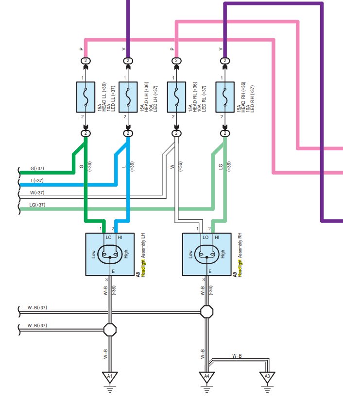

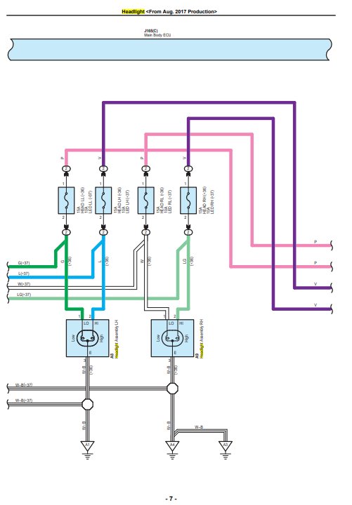

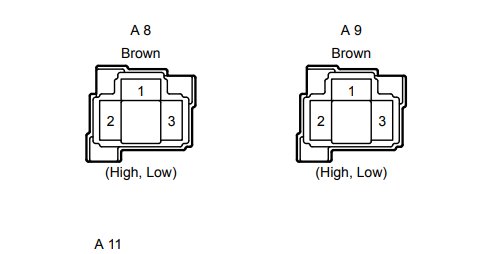

    The first thing I would do is bust out your DMM and see if the pins are correct.
    Someone might have hacked up the wiring..
    Unfortunately, you may have to pull the headlights out to get to the plugs...
    I had to remove the entire headlight light assemblies to replace halogen bulbs, I got pretty good at it.
    But no more since upgrading to OEM LED.
    A8 is the left and A9 is the right headlight bulb plug.
    Maybe you could do at least a visual check for the wire colors.

    Thinking the passenger side bulb may have been the problem I YouTubed the Tundra headlight change and saw it wasn’t that big of a deal removing the grill and the panels to get at them. I had new halogen bulbs that I’d never used so I installed them and the problem was still there. Then the thought of the tech that did the harness recall messing something up crossed my mind. I took this picture of the passenger side harness. It sure didn’t look like it had been replaced and the driver side harness looked the same. Both were nasty looking and packed full of what I am assuming is dialectic grease. It looked like banana crème pudding. I took an air hose and blew out a bunch of it so I could see the contacts. According to your diagram above does this looked wired correctly? I left the ground (white with black stripe) alone but swapped the other 2 spade connectors and nothing changed except when the bulb went to low beam it was like half as bright as it should be so I put them back where they were. 7A34C1E6-CCFF-4853-870B-41BB7FFAC163.jpg
