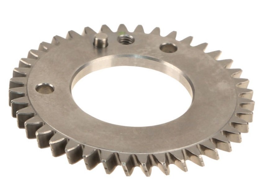

    I'm looking for the Golden Bullet. I hope someone has the Easy Button for this. Maybe if I can get the oil filter adapter off, I'd have a little more room to struggle with the sensor. I have thought about re-locating the sensor somewhere external (front of the damper ?). I would need to know how many teeth it is expecting to look at. I found a pic of what I might need to know, I can't be sure if it's actually even the right part.
    So, I'm hoping there is a better way. Who has done this with far less drama ? Is there a way to sneak the pump out without pulling the engine ? A good way to suck out a stuck stuck sensor ? Or last, is it looking for 40 teeth ? I don't want to lengthen wires, make a bracket and get it to fit and work. That does sound better than pulling the engine :(.

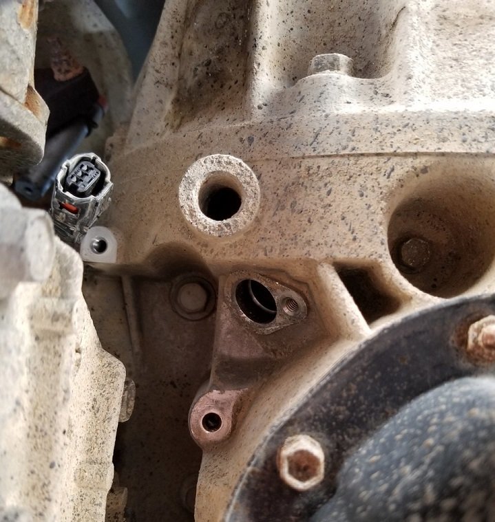

    Any chance you could get a similar pic showing what you're confronted with of what's left ?

    Should look a bit more like this, if I’m not mistaken.
    So here’s my idea. Try to find a rubber well nut that fits fairly snugly inside the steel sleeve of the old sensor.
    Stuff it in there, thread in a long full - thread machine screw of the appropriate size / pitch, with a washer and nut already on the screw. Tighten the nut down onto the washer against the rubber well nut to expand it, and pull by the screw.
    I’m thinking that you may have to pull the oil pressure sender to have enough room.
    Aerindel and FrogPond[OP] like this.

    I could get a pic. It's dark now, I'll shoot some tomorrow. Your pic is about it though. The bolt came out, most of the plastic and innards are out. The steel sleeve and magnet are still in there. Dissimilar metal galvanic corrosion has got that stuff well stuck. I'd like to tap the point of a pick between the "sleeve" and bore hole in the pump. There is just not enough room to put any ass on it. What's involved in removing the oil filter adapter ? Maybe with it out of the way I could get a little swing on it. It would be keen to soak it in some penetrant, you can shoot it up there, it just runs out. I doubt any of has gotten between the steel sleeve and aluminum hole's bore. Thanks, I'll get a pic. Mike

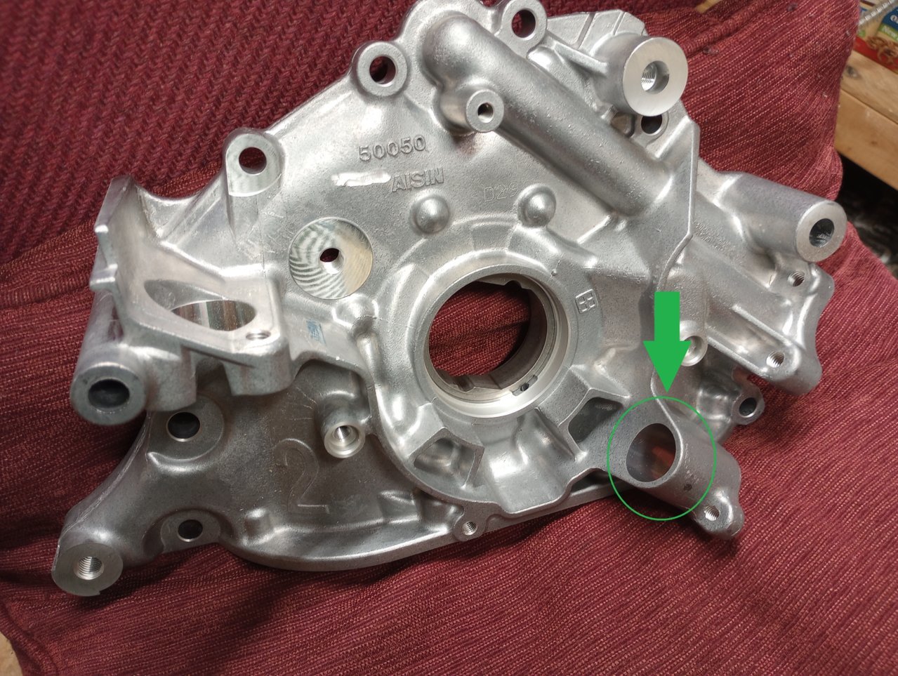

    I have not had much time to actually work on it, I have looked at some stuff. The hole for the sensor goes through the pump. It's open on the inside too. I figure I can push it out from the inside easier than try to get a grip on it and pull it out from under the car. Looks like I could remove the radiator, belt, damper, lower timing cover and see it under the lower timing pulley. From in there, I hope to get a tool on it and push or pry it out.
    My timing belt was fresh when I got the truck. I've never seen how it goes down there. One video said his damper came off without a puller. True ? Could a fella get the lower timing cover off without too much drama ? Anything enormous preclude it's removal ? Has anyone seen the sensor while they had theirs apart ? It lines up with the star wheel you take off before the lower timing pulley. I hope to leave the lower timing pulley intact, maybe use it to lever a lady-slipper against.
