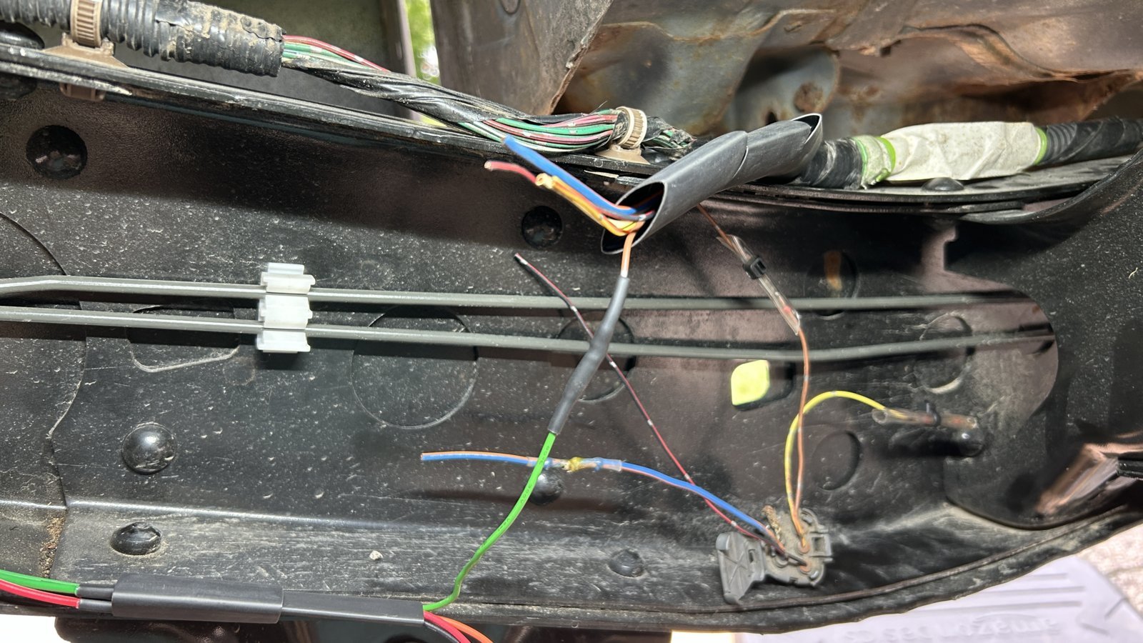

    At this point, I stopped audibly being able to hear the fuel pump. Relays were still clicking, so I dumped some starter fluid in. It really struggled, but did run. Ok, probably a bad fuel pump then. Went to drop the tank and came across this jaw-dropping amazing custom wire harness:
    Complete with 0 solder, a bunch of corroded/exposed wires, and heat shrink that was slit down the middle and zip-tied in place.
    Now, I'm all for learning something new. Fixing your own stuff and learning something new in the process is really rewarding. Heck, it's what I'm doing right now with this truck.
    But, I mean, come on. A 4th grader could do better than this, and they've barely learned what electricity is.
    Safe to say, I'm fairly confident I found my issue. I did pull the tank down and tested the pump with a 12V power supply I made from an old computer PSU, and it powers on and pumps fuel.

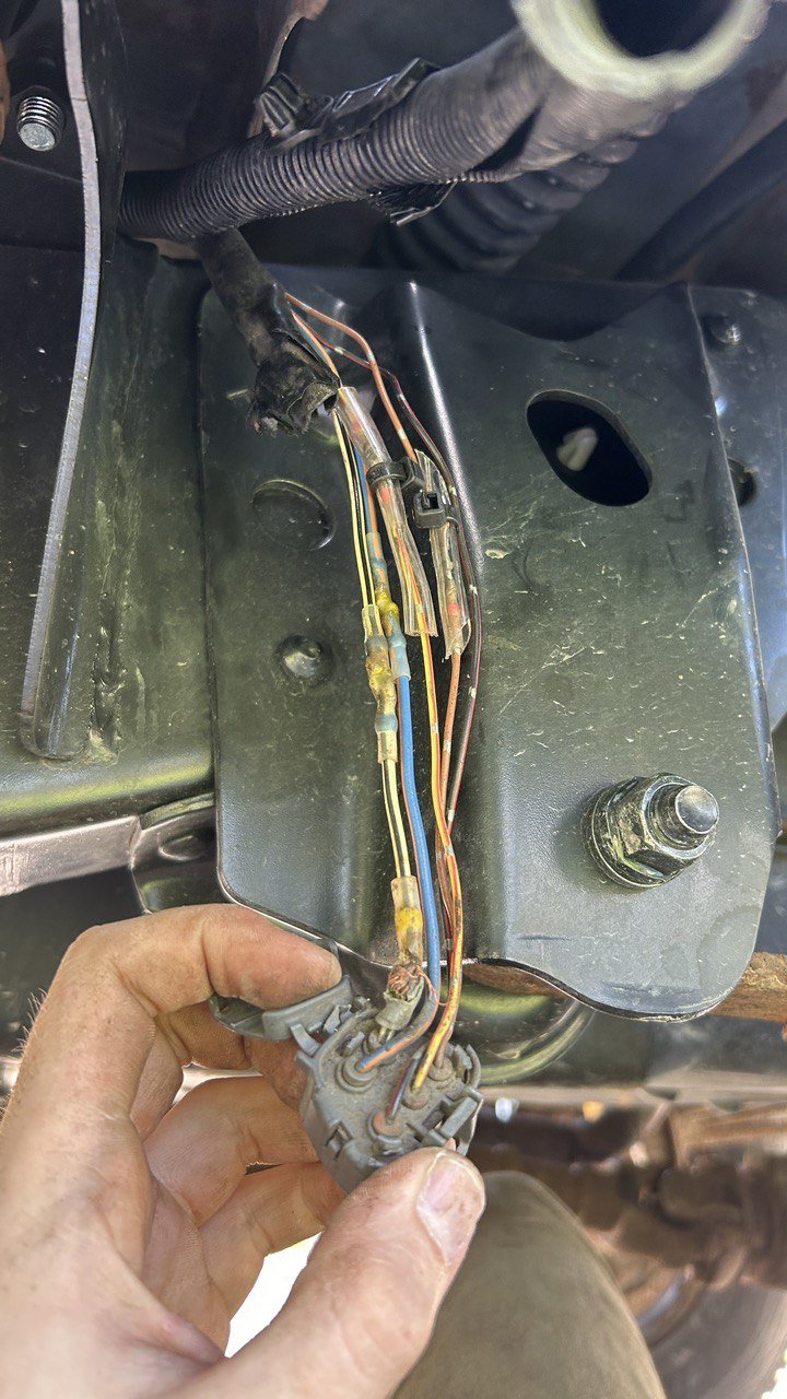

    Got the harness in late last night; did the wiring today and she’s running again. Got it up to 55mph @ operating temp and purring like a kitten. Anywhere from full open throttle to idle
    Above: the completed harness after soldering in new connections.
    Had to lengthen the harness with some extra wire - so two splice points now. All five wires are connected with solder and shielded with two layers of heat shrink.
    Hoping this holds up for a long time to come.

    That's damn spaghetti.
    What do you reckon happened? Body mount give way, or maybe slam thru the frame, and the rear seam of the cab sawed thru the stock harness?
    We've had guys come on here before where the harness to the fuel tank or rear of cab got piched by a bed bolt, but I've never quite seen something like what you're showing. Awesome solve!
