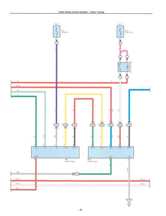

    This one for safety and looks. Ran wires from the inside versus just plugging it in. Took some time and mapping correct wires but well worth the effort

    by any chance you still have the wiring diagram to run from the inside vs plug from outside? i'm thinking of getting this one. Thanks

    On the cover of the plug is the diagram, just tapped the wires from the inside of bumper. Just make sure you test the lights before you tape and wrap everything up. I drew the wire diagram on a card board and made things a lot easier.

    need some help brother. I can't much from the picture. Can you tell which color of the enzo go to the plug?

    Look what color wire is suppose to plug into port and splice in the rear. Sorry mines all taped up. That’s why I used a card board to draw color wire to plug

    the problem is i don't know which one go the the right plug on the diagram of the hitch town plug. :)

    Look at diagram on hitch connector and see what wires coincide with that diagram. I used a cardboard to draw/write color wire so when I splice in the rear I know what wire goes to what connector. Hope that helps

    From a 2015
    Right turn sig Green/ Left Turn sig Yellow/ Brake Lilac/ tail Running light Brown/ 12V battery constant black
    back up Green / ground white w black stripe
