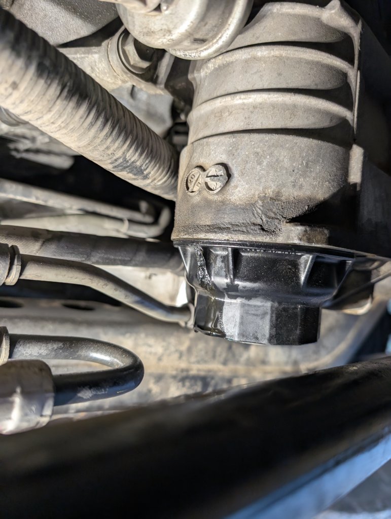

    The previous owner must have over torqued it. I had to use a impact gun to take it off. Didn't realize I cracked till I finish.
    Anyone know the part number for this? It's a 2021 SR5. Need to get the truck running by tomorrow for work

    If it's consolation I've done it as well. 15620
    The aluminum one I had leaked like a siv and I went back to plastic. Just a heads up

    Might have positioned the O ring incorrectly

    What ft/lbs did you torque it to when you reinstalled?

    25lbs for oil filter housing and 9lbs for the oil filter housing drain plug.

    25lb-ft is not correct. I think you mixed up the units.
    Spec is 18lb-ft (which is 25Nm) for the housing.

    Busted one of the teeth off the housing. I didn't think anything of it until I started the truck up and oil went spraying everywhere. :annoyed:

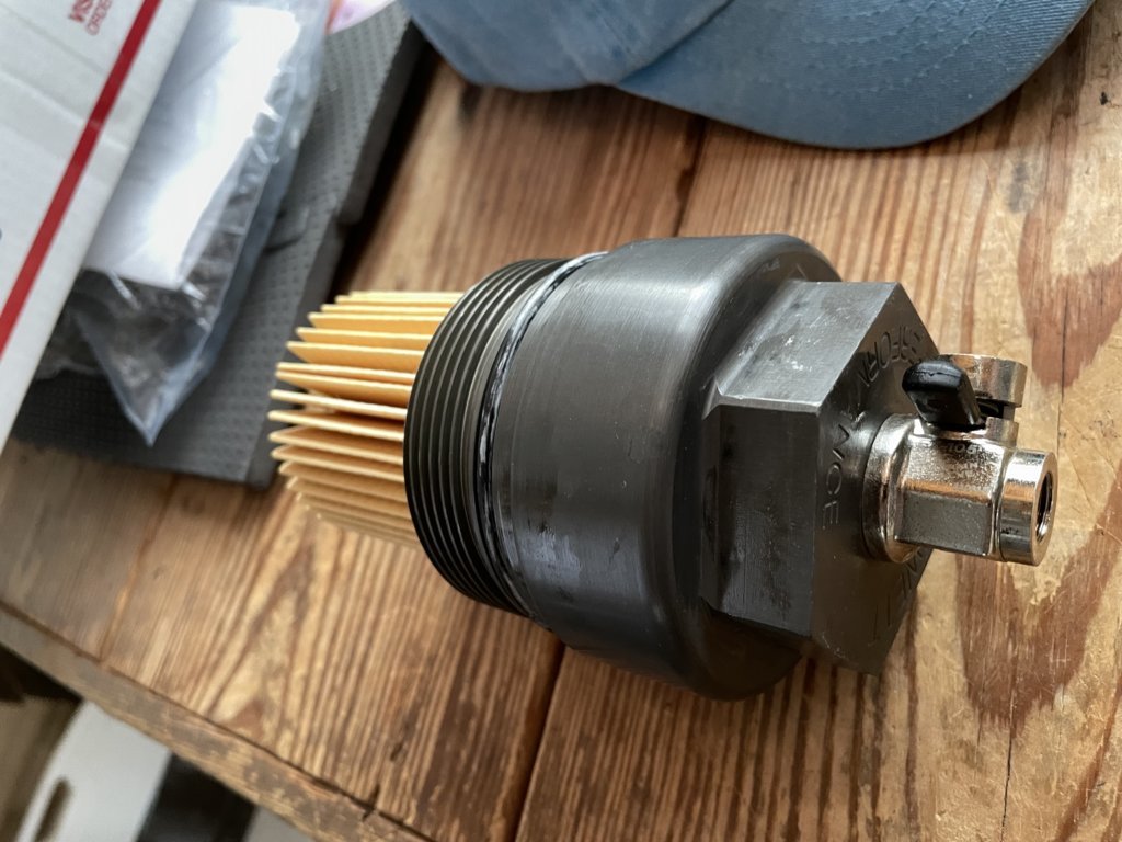

    Local parts store will carry the aluminum Dorman one. I've seen those leak from the get go due to bad tolerances. Avoid them.
    If you're in a pinch, go pay the dealer for a replacement plastic. Or pay the dealer mark up for the OEM aluminum one. They'll say it won't fit your 5.7. Buy it and swap the inner tube.

    I vote OEM aluminum if time permits. I swapped mine out recently and haven’t had any issues.

    15260-31060
