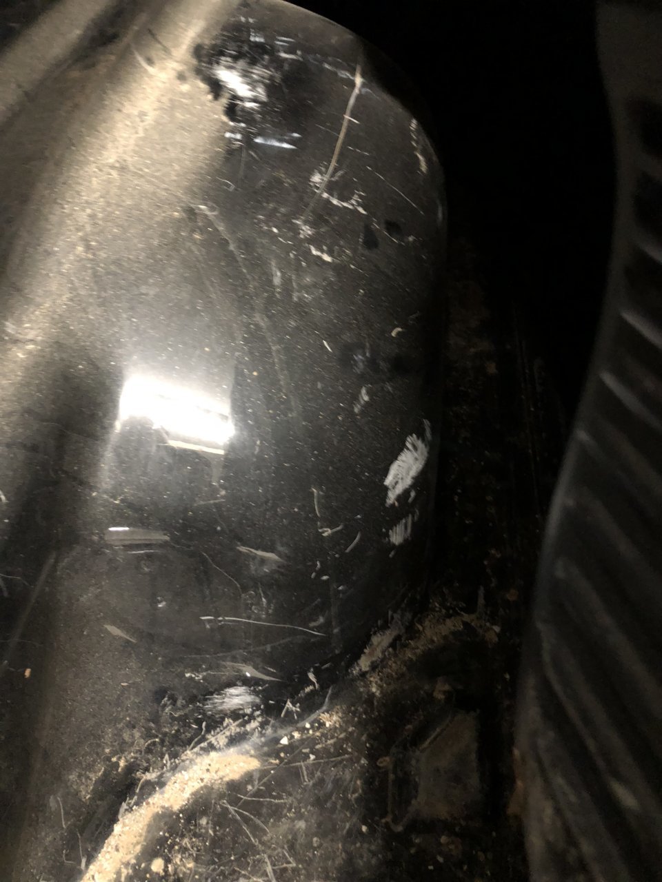

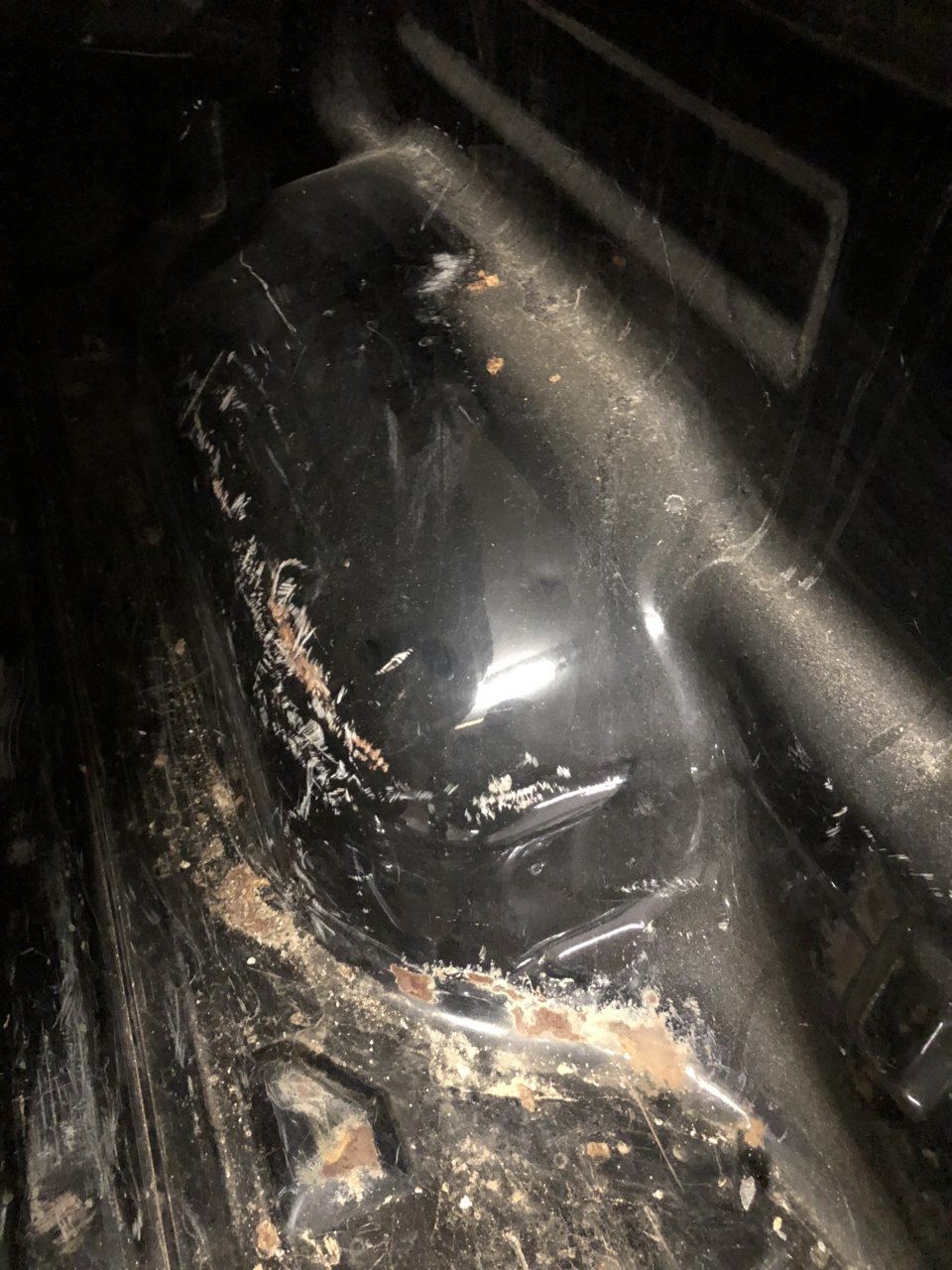

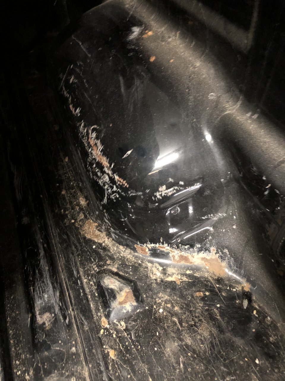

    I just got my Tundra 4 days ago and I forgot to check under the bed liner (1st time truck owner). I now know why the truck sold for under retail.
    It had a duraliner drop in bed liner when it was at the dealer. And I missed the opportunity to look under it before I bought it.
    Im too scared to get the linex spray on because that could void the unlimited mile corrosion warranty. (I heard they sand down the bed and then spray on the liner - which would get rid of the scratches and surface rust)
    Do you guys have any recommendations on fixing these scratches/surface rust spots? If anything, how bad is this?
    I also havent sprayed the bed down/fully taken off the liner yet to see what the extent of the issue is. But this is what I have so far:

    Don't worry about it, go get the spray in liner

    that's just surface rust , have it sanded and get a spray in liner .

    I’d Bwong saying they Bwong. Will add: Neutralize the rust first with a readily obtained Rustoleum product, then spray line over. Get’er dun Chief.

    Easy fix, just take it to get a spray in bed liner. Now let’s see that truck!

    A lot of those look like they came before the bedliner. Best fix is toss the drop in liner and get a spray in. You'll be happy.
    You have an unlimited mile corrosion warranty? If that's the case bring it to the dealer sans bedliner and have them fix it?

    I think the corrosion warranty only covers perforation.
