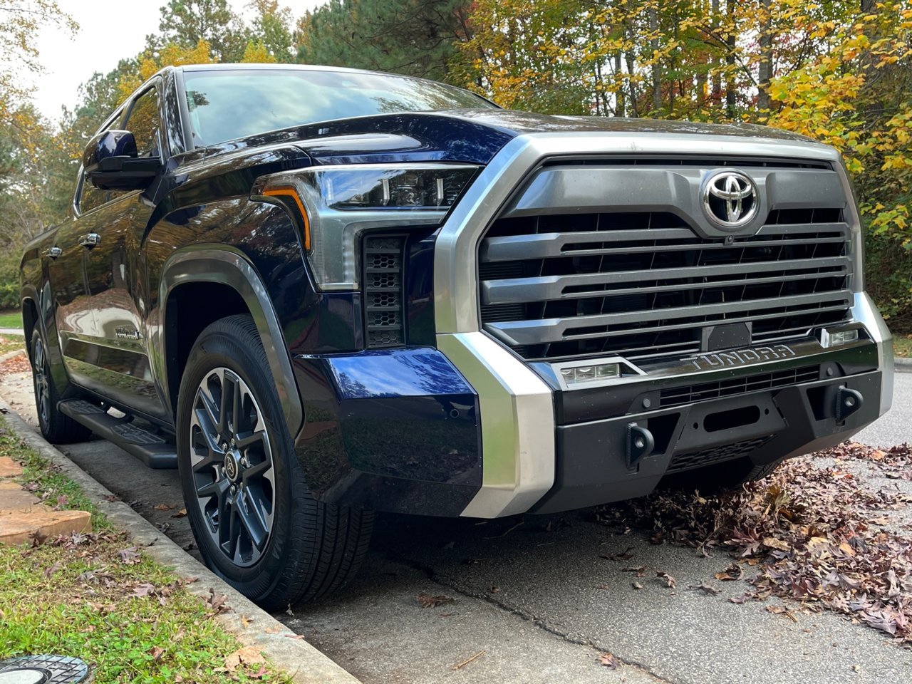

    I’m trying to get my TRD OEM lift kit done this month and TRD skid plate, but starting to think about the new year coming and other items I want to get done.
    I feel pretty locked in on the Covert Bumper by CBI. Would probably do front first and then the back later in the year.
    It is great to have tow hooks and winch. Also like that they did the mount for a 20” light bar.
    Curious if anyone has installed yet? I’ve seen a few videos on YouTube, but enjoy the conversations here. Also any opinions on the version with and without the bar. I was wondering if you can modify the parking sensors to account for the extra length.
    Any other ones to consider alternatively?
    thanks all.

    I installed a Southern Style OffRoad “covert bumper” on my Tacoma and had to cut WAY more than the CBI bumper for the Tundra. I plan to install mine again, it’s pretty straightforward.
    For the 1794 and my Limited it requires the dynamic air dam delete. You just remove it and CBI has a module to plug in that keeps any error messages from popping up. Or you can move the motor somewhere else to let it cycle to prevent error messages

    The motor for the air dam (automatic spoiler) looks to be in the exact spot the winch would go. My guess is you would have to remove it and bypass it to run that bumper. My guess is the rough country one is in the same boat but I have not found anyone that has installed one.

    Retrax Pro XR bed cover, UpTop Overland mid truss system with Baja Designs rock lighting X6, GGOffroad rearview camera relocation kit, Pelican cargo BX90 case, Maxtrax recovery traction boards, OEM bed step, OEM dash and door trim/cubby/footwell lighting, Slee Offroad dual wireless Qi phone charger upgrade, CBI covert front bumper with air dam delete module, TRD Pro heritage grille replace with amber OEM marker lights, Diode Dynamics 18" white lightbar kit and OEM marker lighting, Diode Dynamics covert 18" amber lightbar, Rough Country bed mat, Rough Country defender series fender flares, TRD camo tailgate spoiler and OEM marker lights, TRD camo rear bumper arms, Screen Protech for interior surfaces, OEM badge blackout
    The air dam has to be removed. I was able to add the bumper myself and as soon as CBI released the air dam delete module, it's plug and play - no more error message. Install is not overly difficult. There is some cutting involved but you can follow factory lines pretty close.
    Happy to answer questions since I didn't use any shop to install. Can give you the things to look out for if doing it yourself, etc.
