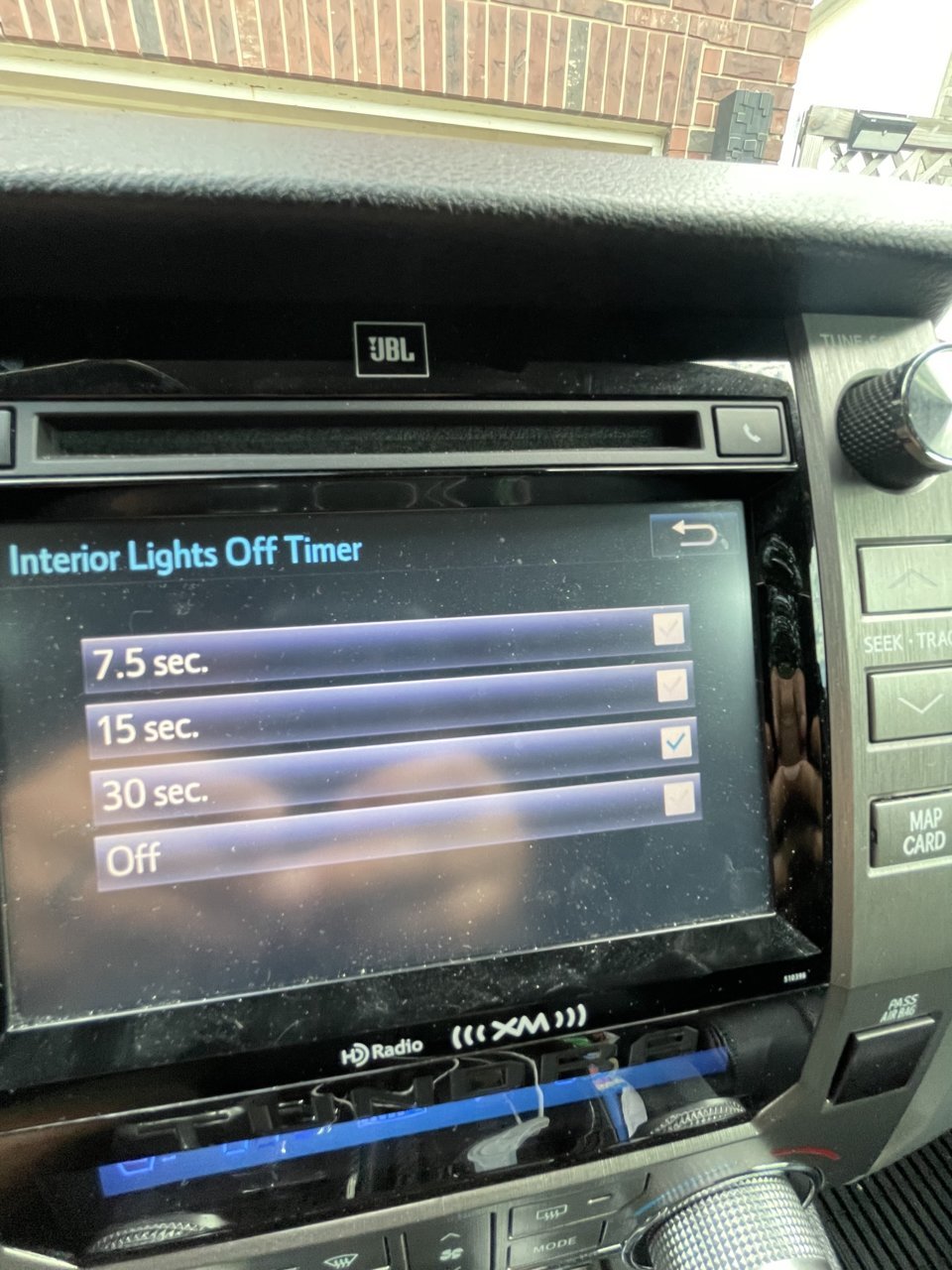

    I think that there's a setting that you access via your dash cluster that gives you the option to set how long the dome light stays on. I think that is tied to the time the puddle lights stay on.

    I can't remember how long mine stay on, I set it so long ago that I'm not even positive how to access the setting. It might be in your Owner's Manual.
    Edit: Manuals here https://www.toyota.com/owners/resources/warranty-owners-manuals.tundra.2019
    Look in your stereo settings....

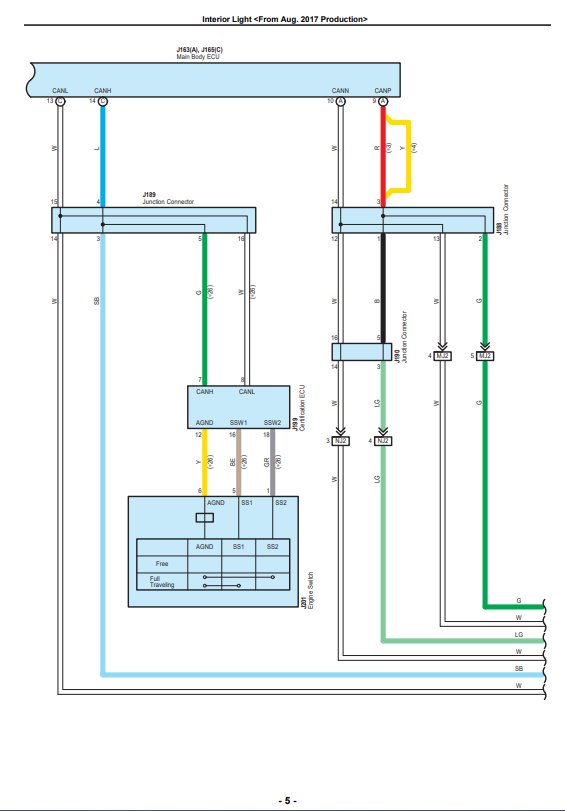

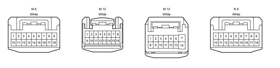

    Your puddle lights run off the mirror control ECU.
    Although there is a connection to the main ECU.
    They are powered off the brown wire of the #6 pin in the mirror plug (M6 and N5) if you wanted to make a modification.

    Thanks for the info looked in the stereo setting and get this the max time is only 30’s ‍♂️

    This is great info thanks, it looks like this seems to be the only option I seriously can’t believe Toyota doest offer a way to adjust this longer than 30’s ‍♂️
