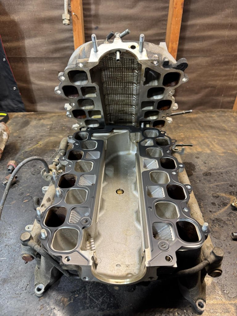

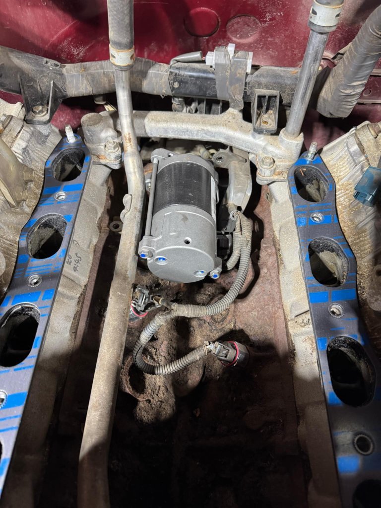

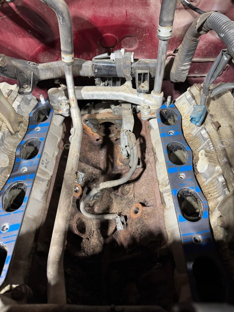

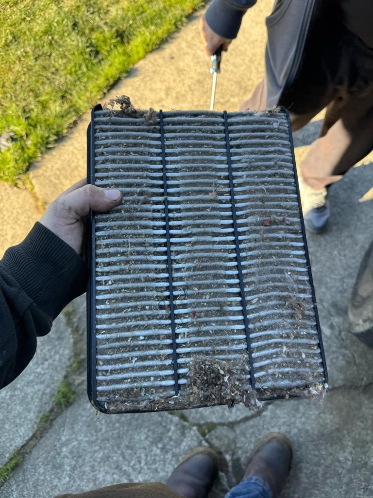

    So I did take it back and he triple checked everything and still couldn’t figure it out. But he did take pictures of his progress and hopefully you guys can find something that I can’t see or can find the problem. IMG_7197.jpg IMG_7196.jpg

    Again, a point to make: Misfires are typically caused by unexpected air (incl. bad air meter aka MAF readings), fuel delivery problems, spark/detonation (incl. timing). Your goal is to help find which it isn't, in order to help isolate what it is.
    Clearly didn't use OEM gaskets but I'm just not gonna go there right now.
    Questions:

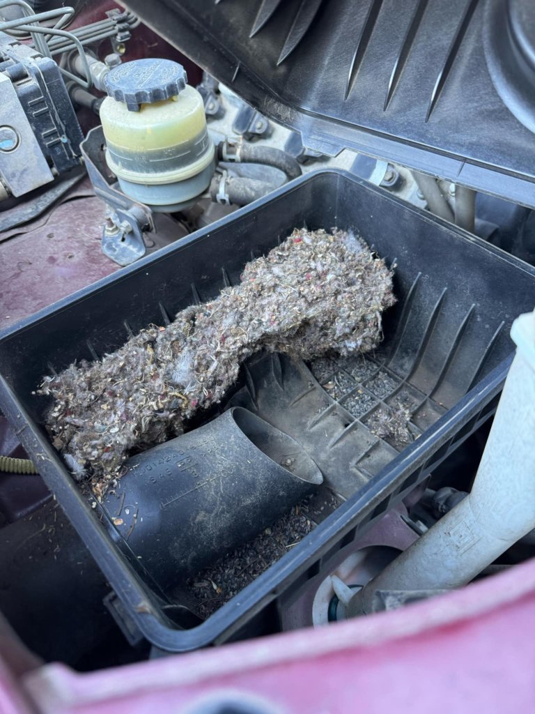

    Seeing rats were in the air box, and little bits of filter can get stuck on the MAF sensor, fave you cleaned the MAF with clearly-labeled MAF cleaner recently? If the MAF is getting bogus signals on how much air is incoming, it may scale back on or apply more fuel.
    When did you clean the throttle body last?
    When was the last time you had the negative battery cable disconnected for more than 10 minutes after that happened?
    Do the misfires continue if you throttle up the RPM? What if you turn the A/C on full blast?
    Are you able to test the fuel pressure to ensure it's over 40psi?
    Given you have rats nesting in the engine, have you verified timing, to make sure something they may've squirreled away in the timing covers didn't throw timing off? (link)

    What are those intake manifold gaskets? And holy mouseturd Batman, how long did that truck sit up?

    Dude....that is going to be a wiring nightmare.
    I wonder if the rats/mice chewed just enough that the truck would work, but after homie took everything apart the last few copper strands went KAPUT and now it's an electrical shit show.
    just my guess cause goddamn batman.....that's wild

    Also no need to split the intake. Use OEM gaskets. Carefully check wiring for rat chews. Clean TB and MAF. Be sure stater and knockers are Denso brand. Report back.
